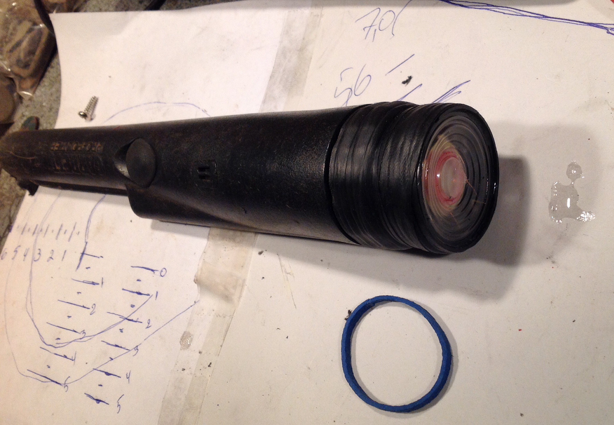

Until I had done some more test, I need to warn about this idea - "reset the PP offset".
1. temperature test is easy to do. That will tell "IF" there is a problem. So fare Nobody knows because this offset tuning is new.
2. NUPI - if your Garrett gives your signal after two minut in cold weather, you got a broken PP or you made some adjustments, or you are handling it wrong. I had NEVER seen or heard of this and our winter is really cold. Turn "off and on" resets your PP.
Garrett made a PP and they wanted to be sure that it will work all over the World in all kind of situation and in all weather. Thats why they made a margin or you could say "a safe area". This margin is Big 0.08-0.10 volt. If you tune your PP with a coin (or a scrue) at the side, you are working with this margin, and you Press it down to zerro. With my idea you decrease this margin down to 0.03-0.05, but you still got a margin. I just dont know how low this margin will go, when the temperature drops.
Next test will be with the PP at different temperature, to see If my margin will be to low in cold weather. It could allso be the opposite situation, that warm weather or high temperature will give problems. Depends how the drift stability is made.
Ill will remove my Utube again until more test is made.
Henrik.
