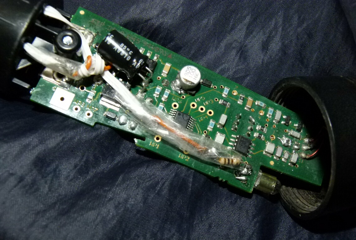

        found those Pix - Nov. 2012
        The +voltage pin is located below the black capacitor (on the same side), you can find it with a voltmeter.
        This was the first mod, LED on or off, depending if wire is inserted into the right batterycase-plug pin.
        Later I connected the LED also to an additional wire that leads over a tiny push-button to
        the voltage for getting the LED very fast on-switchable if this button is pressed.
        Attention: If the LED gets its power from a different source as it was before the standard
        don't forget to interupt on the PCB the little copper-wire which provides the usual voltage.

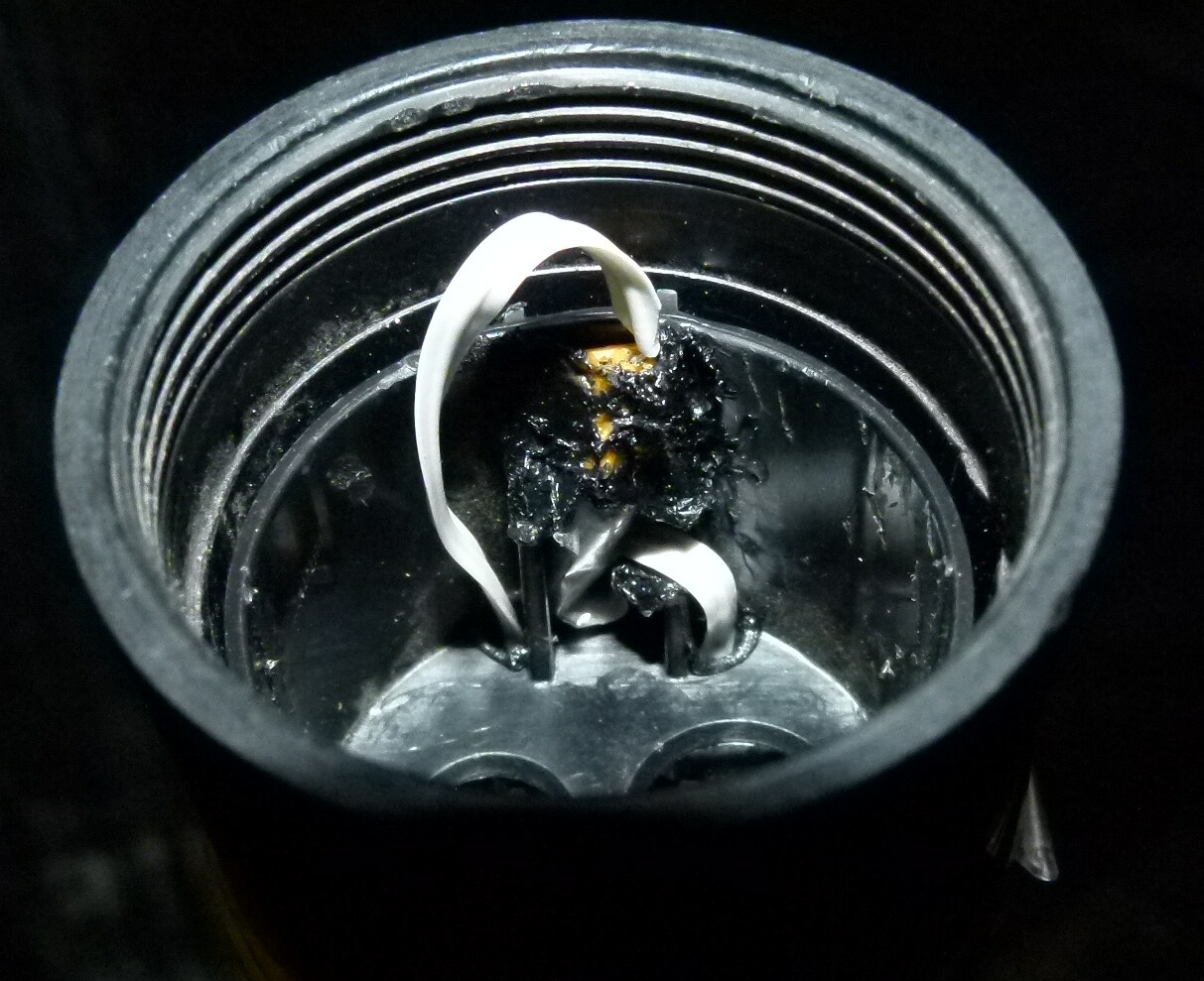

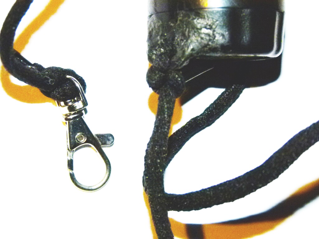

        And at pic 3 there's another little improvement for the Garrett Pro-Pointer: Very practical for not losing it!
        That way its now also possible to lower the pinpointer by a rope into cracks or holes etc. to search there.

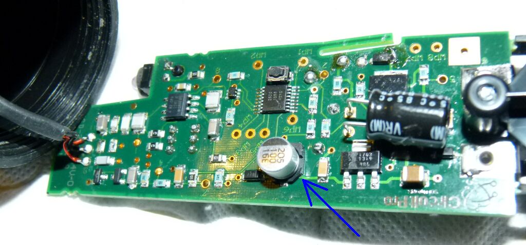

                While moding ProPointer Nr.3 I found out that those PCB layout creators from Garrett made a big nonsense:
                Check out the jpg to see why! With some bad luck the coil cable can gets caught behind the marked capacitor
                and rip it off while draging the PCB out of the case! So do it very slowly and use a flashlight to see whats
                going on inside with the coil-cable. And later you may use some ducktape to close the gap behind the capacitor.

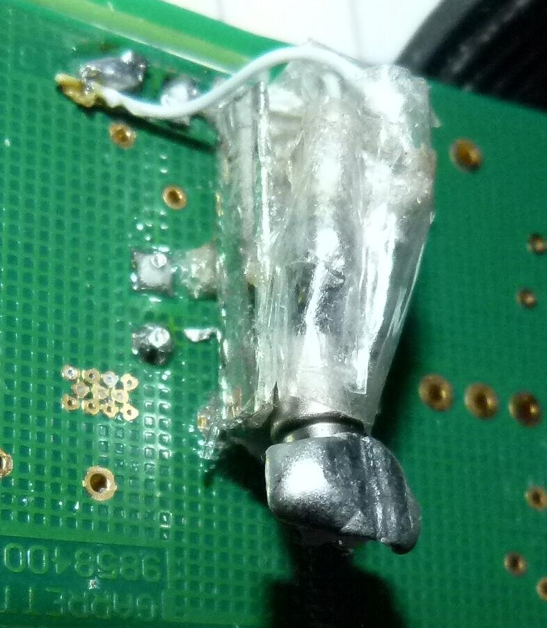

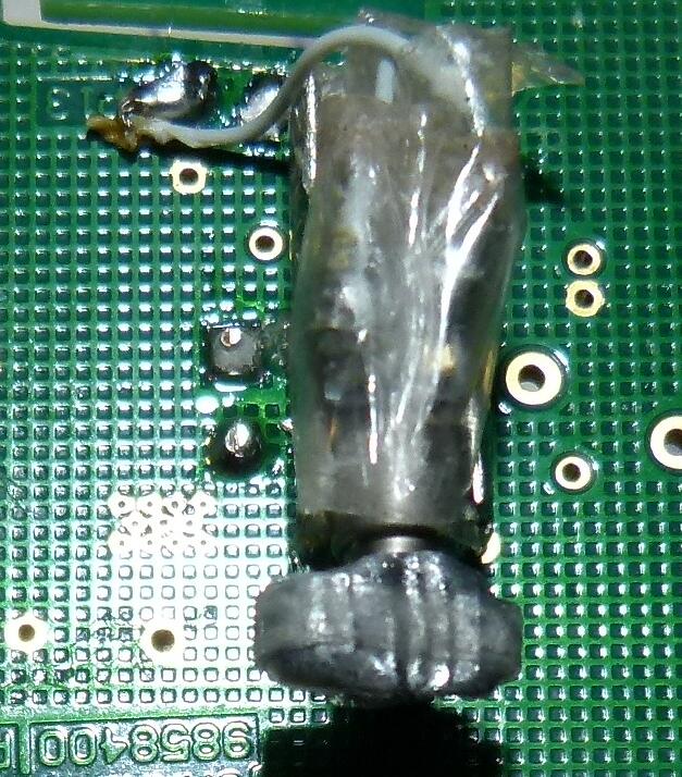

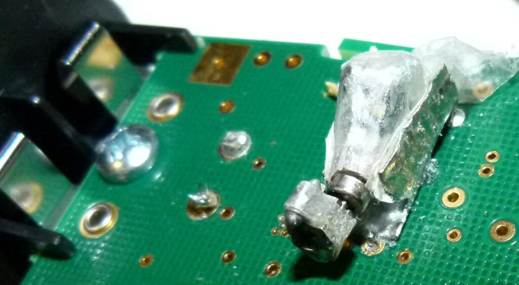

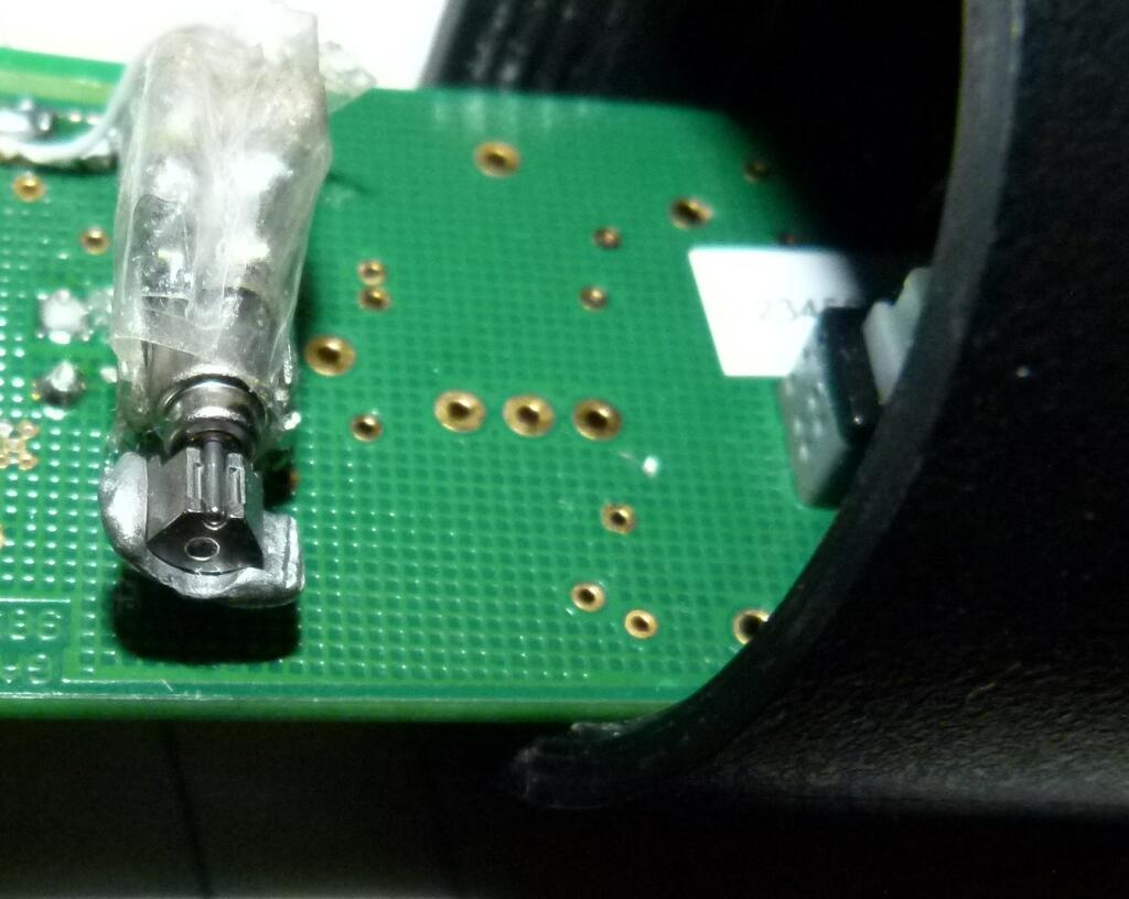

                  Pro-Pointer Vibration Replacement
                  The weight unbalance attached motor can fail, but you can replace it with one of an old cell-phone.
                  To improve the vibration-power, you can attach a weight.
                  I used a special handshaped piece of soldering iron with super-glue
                  and as a security measure a 4x winding of 1,5mm "broad" and very thin scotch-tape.
                  It was melted at its end toghether with the below layers with the soldering-iron so it can't became lose.
                  Such modifications require enough space for the turning weight inside of the plastic housing or it will get stucked.
                  Mount the replacement in a way so the weight is enough far away from the left or right side of the board.
