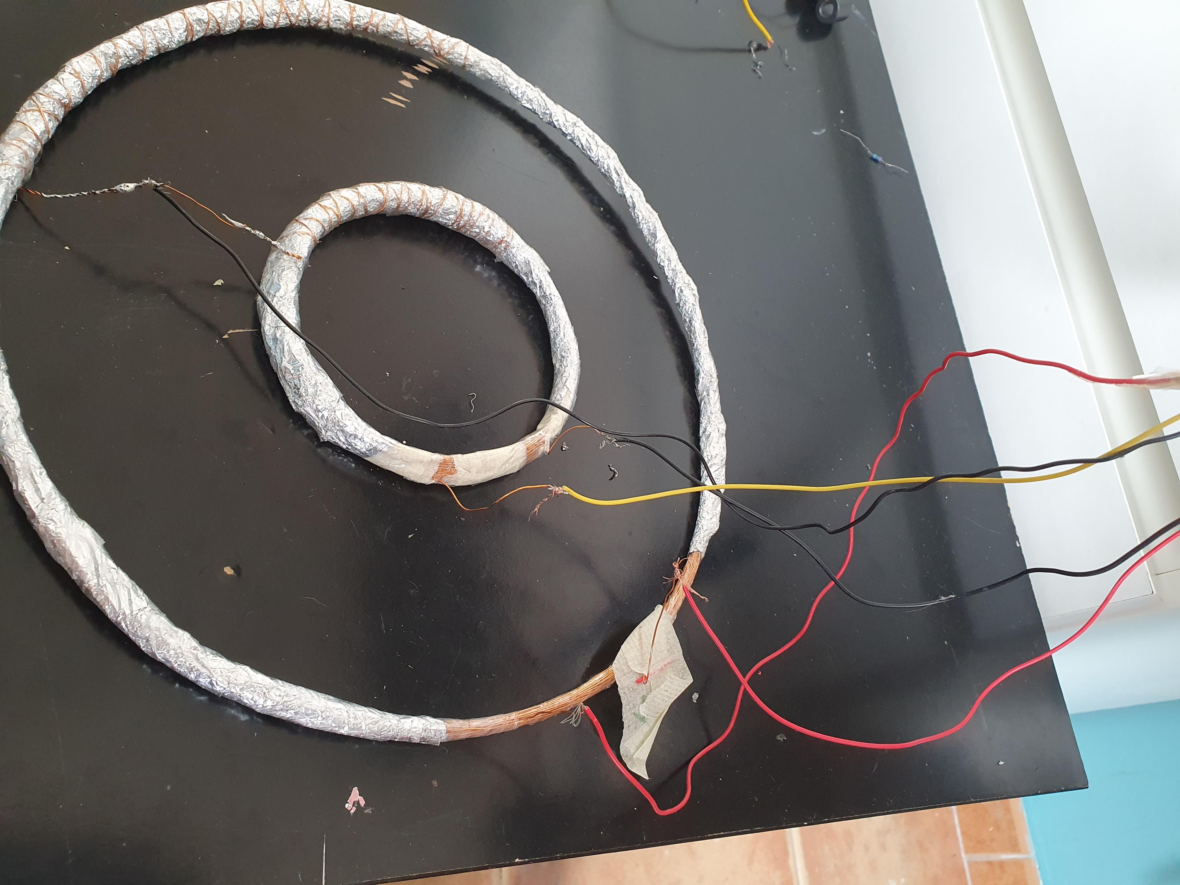

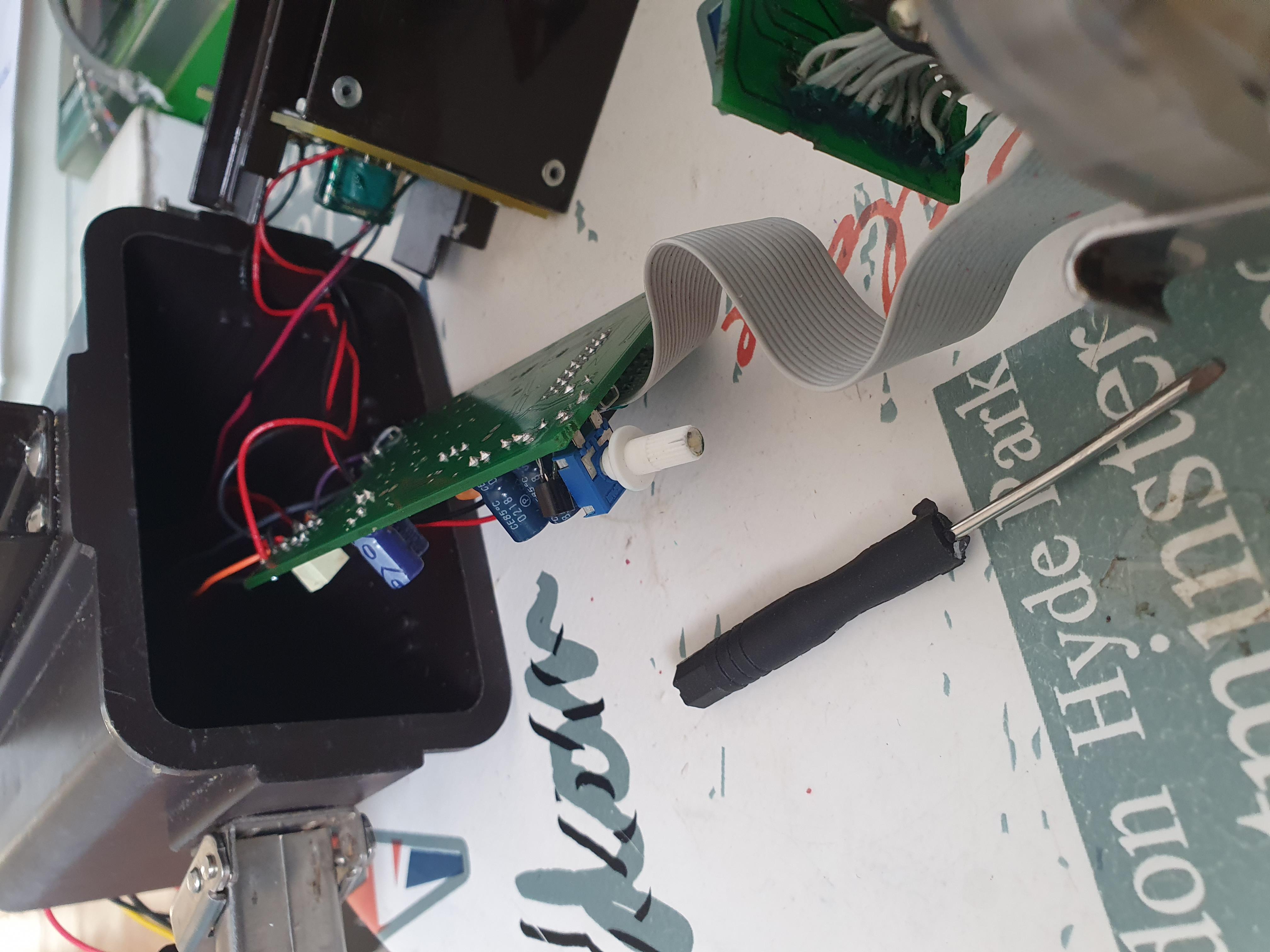

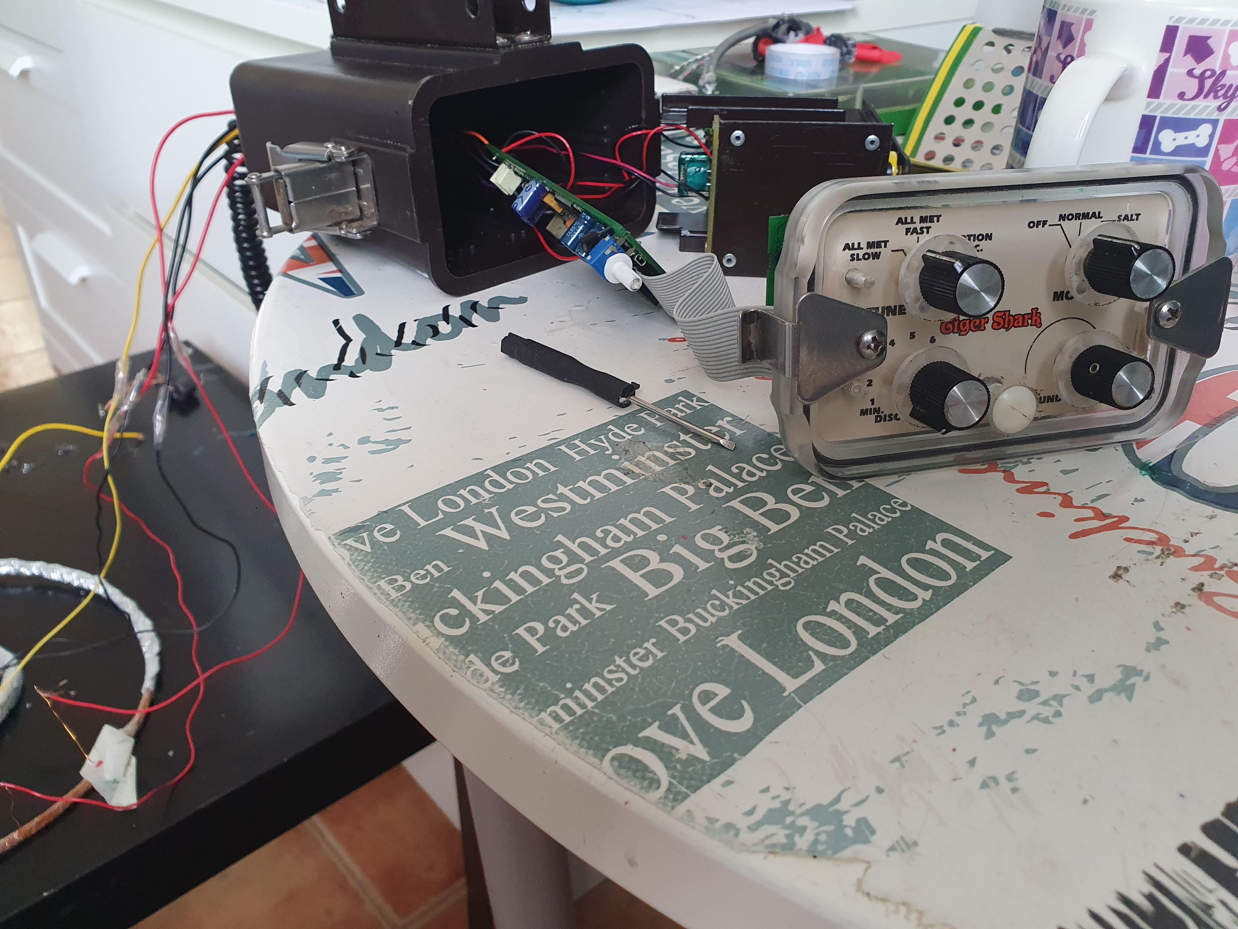

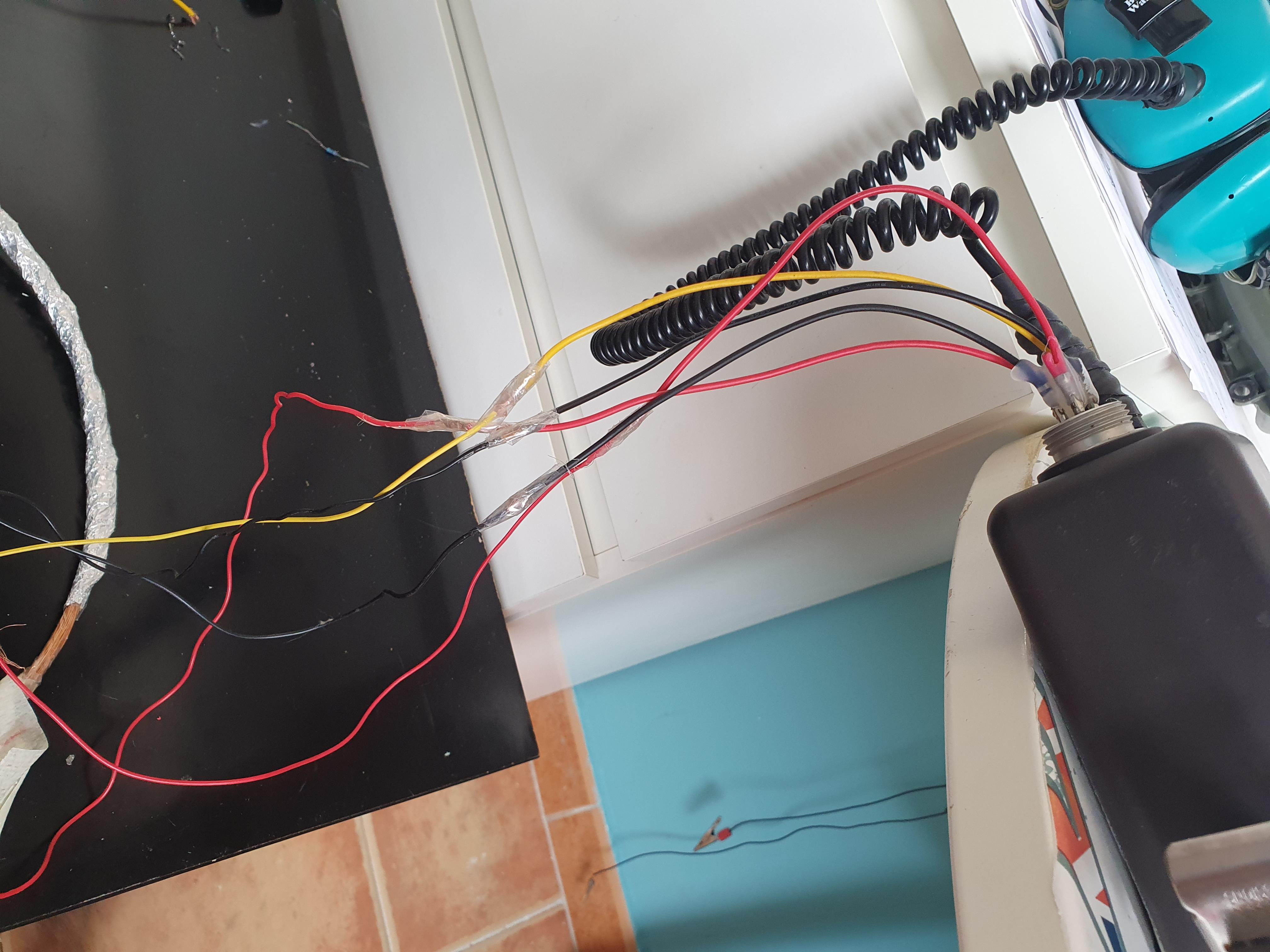

          ]Hello, I know that this thread has been made for years ... but I have a problem with my tiger shark ... the coil broke, so since I had a row of enameled cable around here I decided to make two coils the rx and tx with their screens when disassembling check everything and the original cables gave me some resistance between the 4 pins that have continuity, I am not sure if there is a pin that is useless ... or it is one for a shield, the coil was useless and was full of resin ... so I could not see exactly how the distribution of cables was going ... I have been trying it for 3 days ... and there was nothing a moment when it does its functions but only when I held it with one hand of the opposite the sound was not complete and distorted ... I hope you can help me it would be a great help images some video etc

                You have a TX coil and an RX coil but I see no bucking (nulling) coil. Without it, the first amplifier is constantly overloaded.
                    Hello, so the screen has nothing to do with that coil that you say is missing? You would be so kind to explain to me how and in what way they would connect to be able to make this relic work. . First of all thank you for accepting me and for any kind of help.

                            You need a feedback winding on the RX coil to create a magnetic null. To accomplish this, you'll need an oscilloscope. Here is an article that explains IB coil construction:
                            https://www.geotech1.com/pages/metde...planar_300.pdf

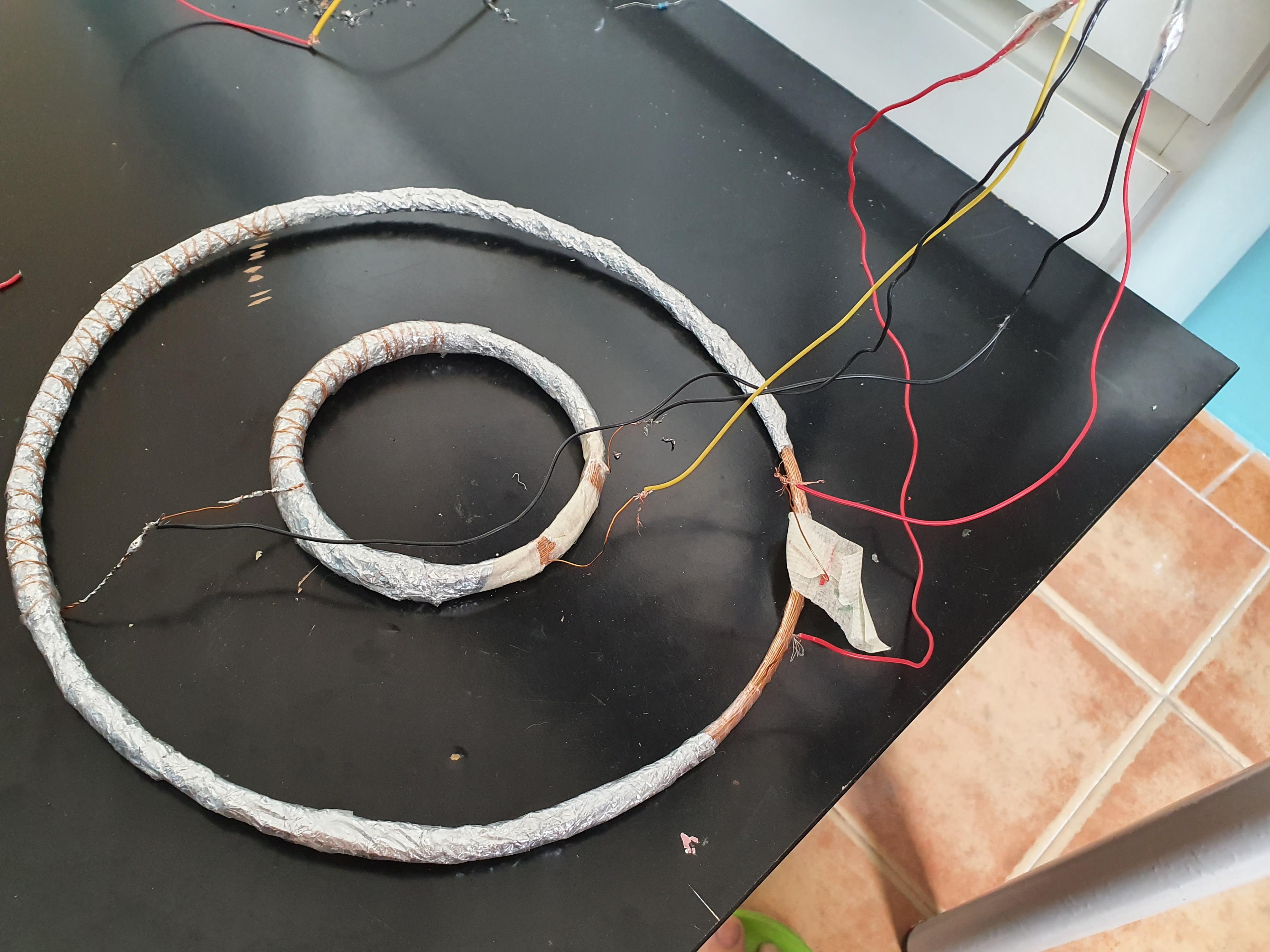

                              Thank you very much Carl-NC, without a doubt you are very kind, I tell you that I managed to make it work and I no longer have the interferences, but there is always a but ... the signal did not increase which was what I wanted to do when increasing the diameter from 20cm to 25cm tx and 10cm rx, I am going to read very carefully the pdf that you provided me and I thank you for your help .. a hug from the Canary Islands, I will upload the progress ... in case there were any ... hahahaha
                                coil tesoro tiger shark

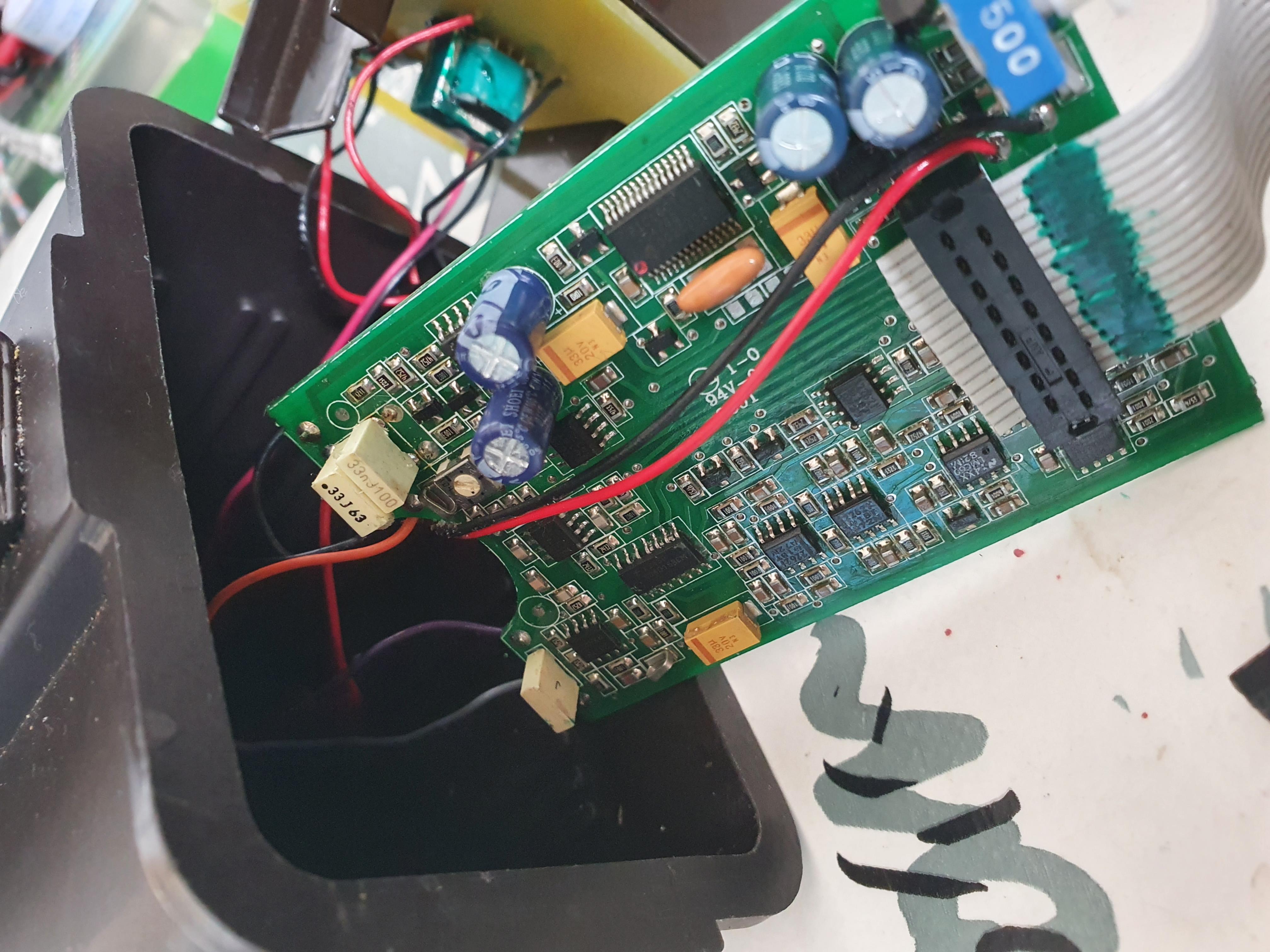

                                Hello again, as I said I think that now it works ... with its defects, of course: the tone is still of little scope to have increased the diameter of the coil it would say that even less than the original ... on the other hand I have to have the threshold and sensitivity practically to the maximum to be able to receive the pi .. the small objects are captured but with great difficulty the big ones with less ... I don't know if it is for the coils or for the original resistors and capacitors components ... I .. I hope help I am fond of electronics and discovered that I love it. greetings ... I hope I can fix it and make some outings with him ..
