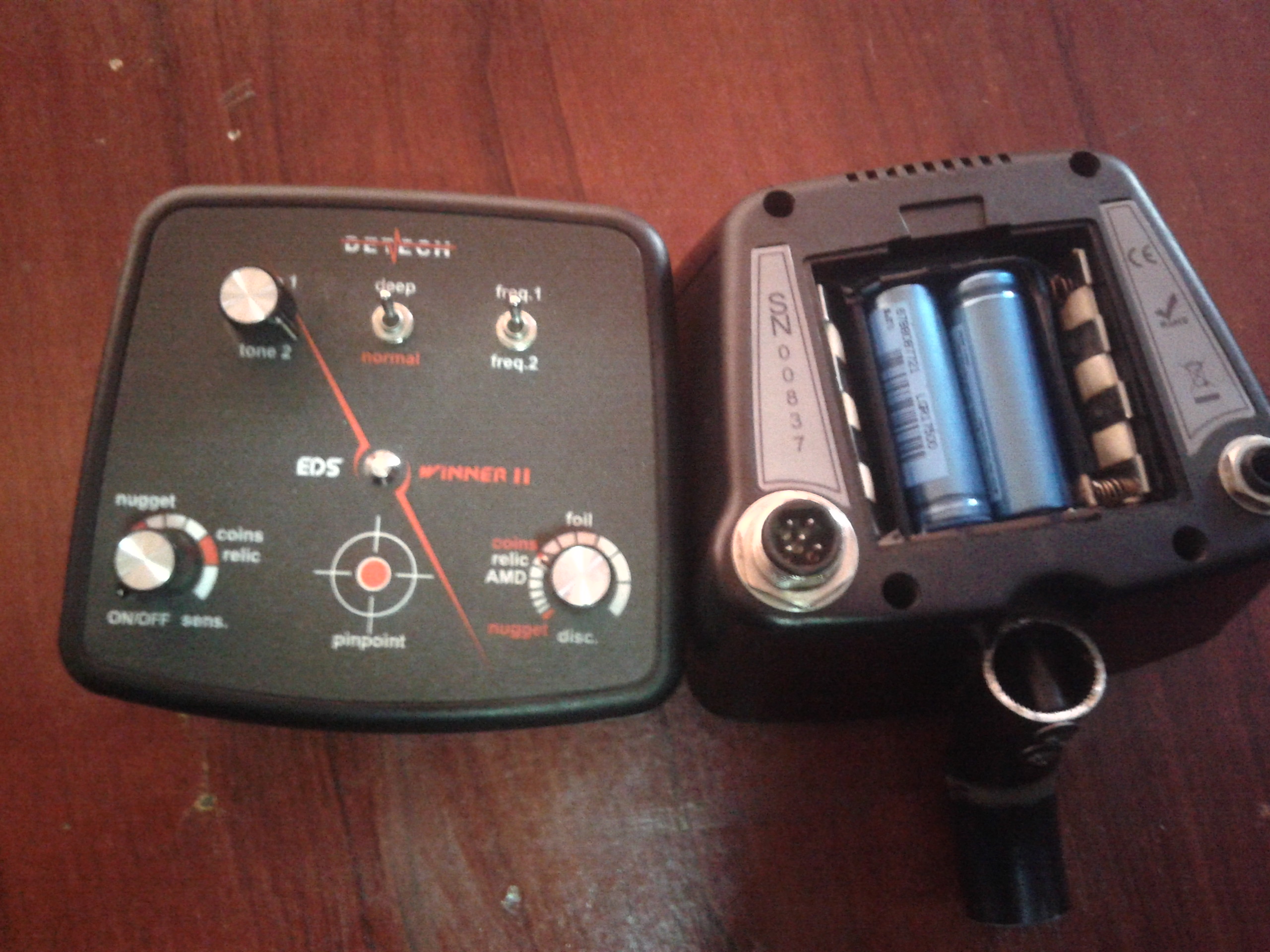

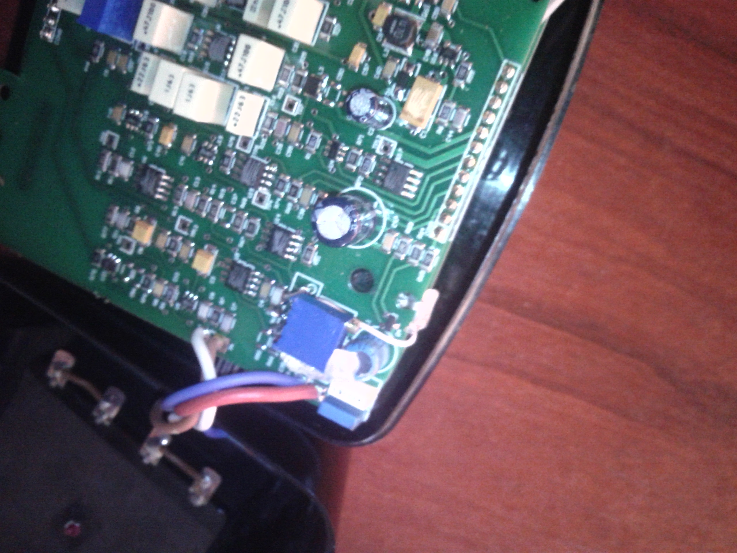

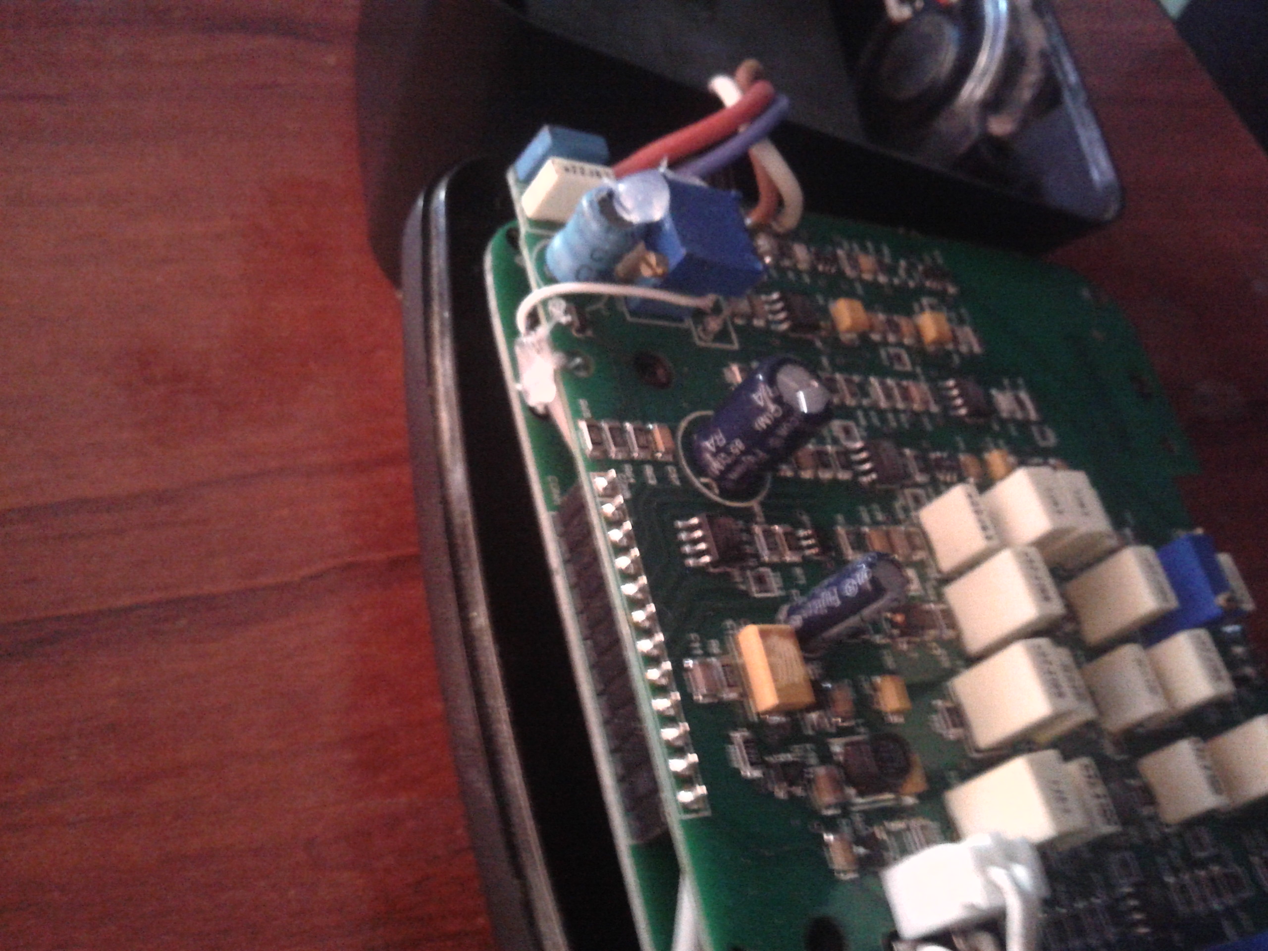

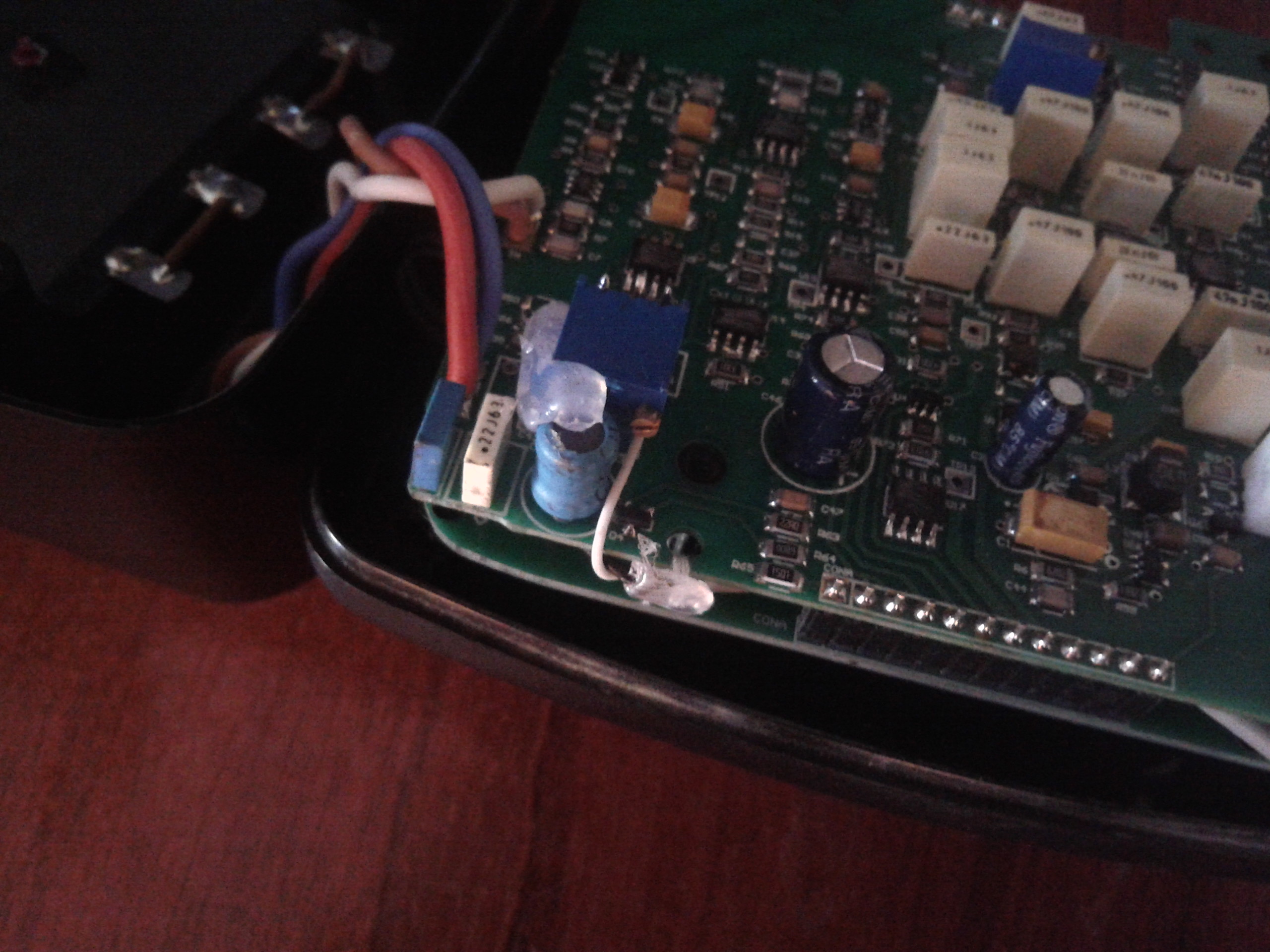

                      few pictures with with this mod.
ID:	342592Click image for larger version
ID:	342593Click image for larger version
ID:	342594Click image for larger version
                      - 2 battery 17650
                      -hope it was usefull.

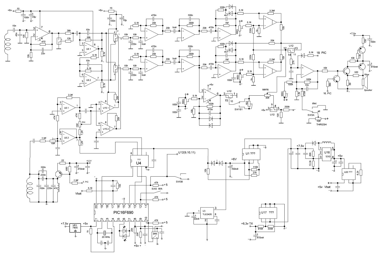

                          -best way for you is to go to an electronist.here is a schematics for eds plus from an russian forum.he will know what to do if e see the detector and schematic.
                          -i dont recomand to nobody to make mods if he dont kow electronics.
