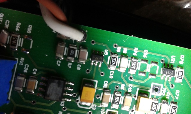

    hi can you tell me the value of inductance near the transistor thanks
      6-pin code smd LTAF = help
      6-pin code smd V719 = help
      6-pin code smd A12 = help
      5-pin code smd S50 = help
        LTAFJ = Linear Technology LT6230 op-amp
        LTAFL = LT6233 op-amp

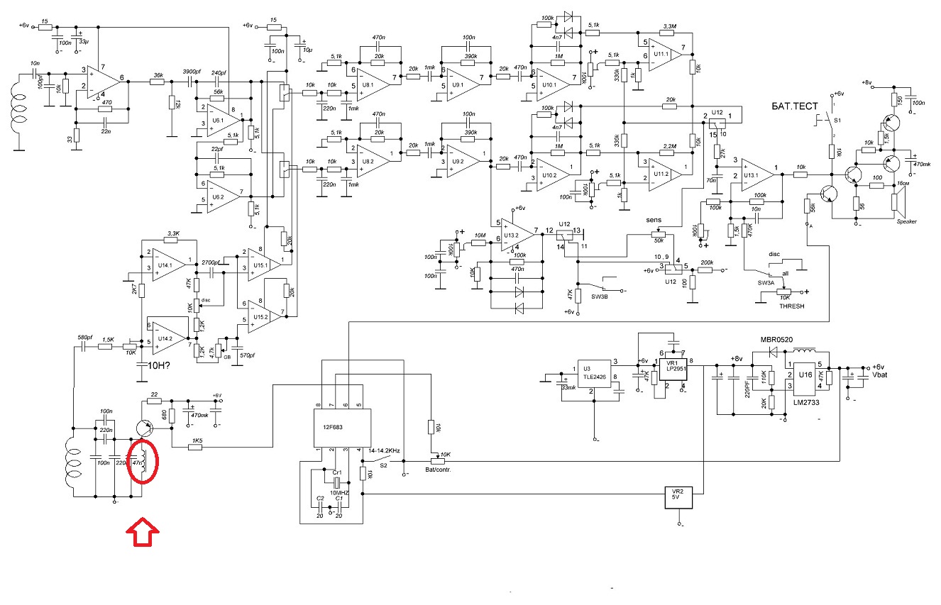

              Hi,enybody knows value of this L choke in transmit, and transistors?
