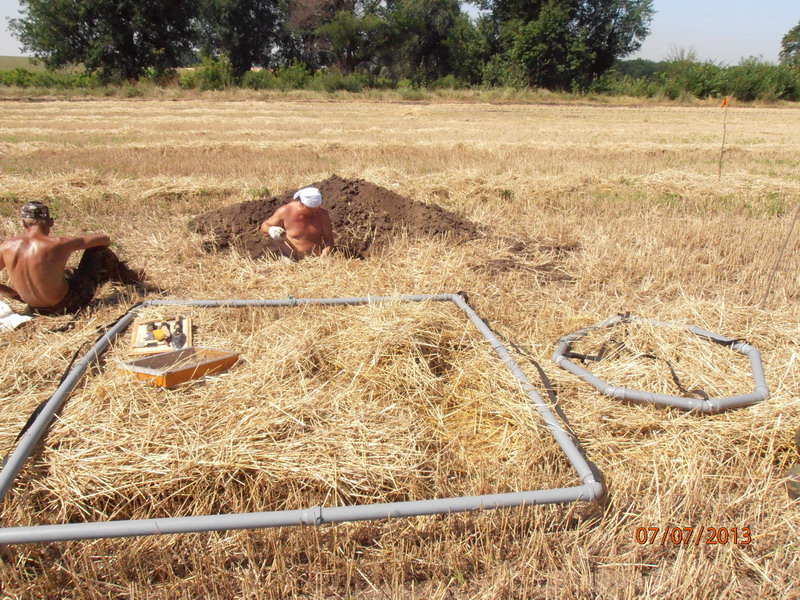

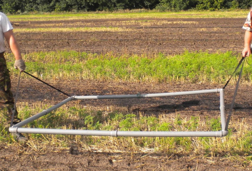

                              thank you for the nice feedback!
                              those pics I see in one forum... 2x2m coil at scanning of a terrain...

                              • #75
                                hello, i got 20cm on the 1 lithuanian cent. the coil was bad 25cm diameter but 700uH and a lot of interference around (2 fluorecent lamps just above the coil, no pcb shield yet, lots of metal around) i will make a proper coil and try again.
                                very good result Tomari! people wait a video from you -!
                                one question, after i reset, i can turn the threshold all the way to FULL and still there is no false detection is this the way it works?? i remember on turkish pcb i could turn the threshold around 7 to 8 and there i got 1 beep every second
                                maybe this happens because of the 700uH coil?
                                have yet not answer... my guess turkish board has more un-stability. my coil 1x1m has 550uH and worked good on first DP. 700uH has to work...
