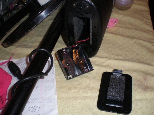

    I was looking to get rid of 9v Battery for my metal detector and i could not find any info on it, so i did it myself....so im happy to share what i did to my Bounty Hunter discovery 2200
    Im a computer tech for schools and i have defect battery from laptop where i can then salvage some of the 18650 inside...
    Those battery are awesome, i already bought a Fenix frontal light and a laser that use these. For charging im using an intellicharger i4 pro, but i plan upgrading soon.
    Since i already made a battery swap on my Roomba to 18650 also, i wish i could make it on my metal detector. I just started with metal detecting this spring with a BH discovery 2200. I really love it and looking to get a better one or build my surf PI
    I opened my main circuit to find that the 2 9 volt battery use two circuit .. at first i thougnt it was 2x9V for 18V.
    BC1 and BC2 circuit.
    Yesterday i tried both circuit, one seems for the main board, and the other for Audio. I found i could put 3x18650 on one circuit and 1x4v on the other (audio) . Well tone are a bit on the low battery side.. but maybe ill add another 18650 (total of 2) and see the improvement.
    I had no idea what was the power circuit.. but i was guessing it was protected so putting 12 v wont harm it much.
    Enough, here are the picture

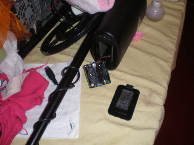

    i used a 4x18650 batt holder, bought on aliexpress for cheap..
    There is 2 screw hidden unther the facia.. just peel off the corner...
    Voltage of 1x18650:
    Voltage of 3x18650
    Used molex connector
    I just welded the wire on the 9v connector
    Its working
    For now i just fixed the battery holder on the stick

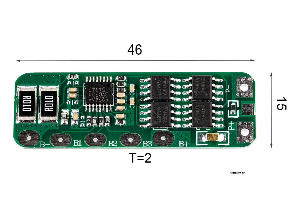

    dont use the 4* holder
    on Internet you con find 3s or 4s charging pcb
    https://www.akkuteile.de/4s-pcb-keep...-26a/a-200506/
    directly solder the cells together an connect this protection board, so you dont Need to take the single cells off the holder for charging the single cells
    you can install this as internal power source just add a charging connector on your enclosure an a Switch on/off/on mode one detector on mode two charging on

        Bernd is right - you can not so simply charge cells connected in serial. you have to use especial additional board for charge (also at aliexpress and ebay).

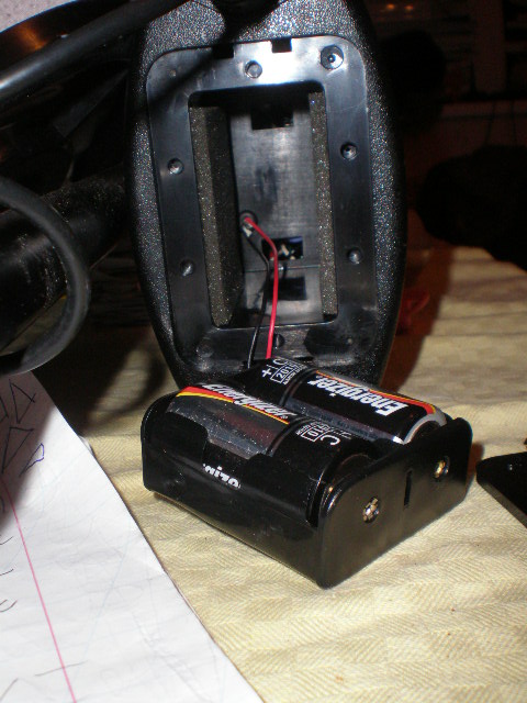

            i had asked forum but tell again. BH has set some type of converter inside. pics again.
            bad thing nobody did not be able to give detail information, but one answered that is used LT1304.
              Connector J5 is almost certainly the serial programming port for the microcontroller IC. There is an almost identical arrangement inside the Fisher F2/F4, which are obviously 'big brothers' of your machine.

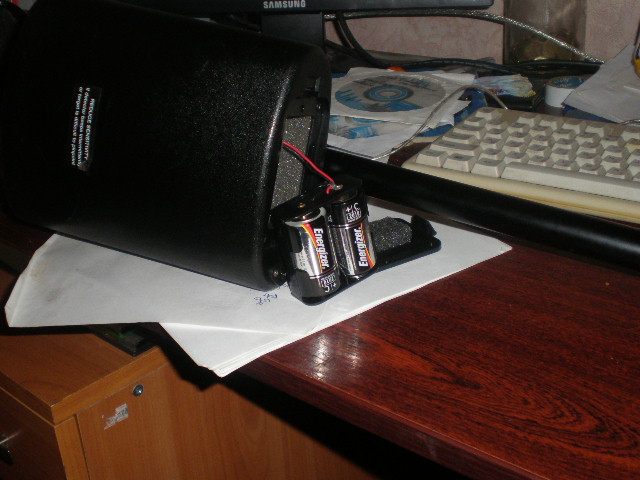

                ok guys. i got the converter bought at ebay after very long waiting and will tell the mod - how to convert two 9 volts power supply BH.
                  What kind of current can that supply ?
                    http://www.ebay.com/itm/DC-DC-Conver...gAAOSwbYZXf2R2
                    50mA for 12V. must tune it to 9-10V. enough for a VLF. this 5pin chip is noname, so can not tell about the data from a datasheet.
