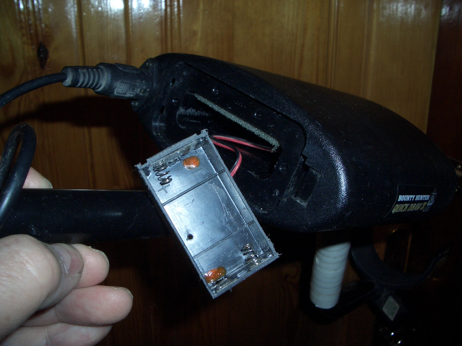

              soldered 33k resistor on the place. to connect to BH will be second step.
                made album and will upload pics in it http://www.geotech1.com/forums/album.php?albumid=74
                it will be better than 1000 words.
                  Since i now own a Deus and a garrett 400i, im no longer using my BH
                  My last idea was to use the tubing to store the 18650 batteries :0
                    This arrangement of two PP3's in series is also used in the Fisher F2 / F4 and maybe other machines in the First Texas line-up.
                      my last photo is only test and i will add still a switch (do not want to cut pcb) and socket for charge.
                      working good and voltages are same as was been without loading.
                      will check on time - with 2*AA, 3*AA and 4*AA.

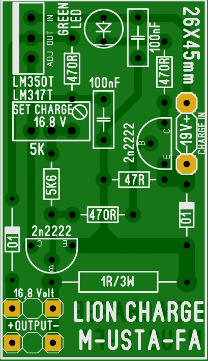

                        dear friends
                        my Jokerx1 mahcine use 4 pcs 18650 li on battery.
                        I use charging circuit.
                        İn :19,8v
                        ADJ: 16,8
                          Walkman thanks for sharing...
                          God bless you...
