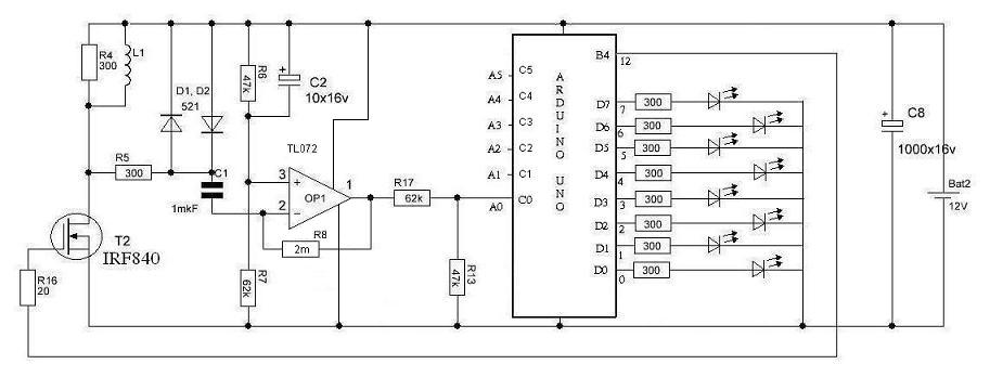

    Hello all I would like the experts to have a look at this simple PI schematic I have build this MD and it is working very well But what I would like to find out from the experts is Are there any Modifications I can make to make it more sensitive and detect deeper at the moment with a 15cm coil I get about 10 to 13cm detection depth on a R2 south African coin please have a look and let me know
    Thank you all
    I added the Schematic and the home build detector of mine
    Okay sorry cant find my homemade pics now will upload as soon as I have Please look at the schematic any changes would be helpful

        Not sure I Understand how it's working at all without Delaying the Sample.
            The sample is delayed by R13/C8.

            Better use the processing power for useful things like ground cancellation, auto-adjustment and discrimination.
            Arduino can be replaced by an ATTiny84 MCU chip and the program still works. This gives a minimalistic but very flexible system.

                I have a 20K pot in R13 but even when turning there is no change in sound or anything I think its useless there dont know why it should be there does any one know why R13 is placed there for what reason
                    Looks like that coil is under damped, therefor the detector may respond to the ringing of the coil rather than pulse sampling (could this be a new type of PI)?
                      Actually it is more likely overdamped, but it may only negligibly hurt the depth. The less obvious part is that it uses a single balanced modulator instead of a switch, and it may prove useful even in a more sophisticated gear. I found a short discussion about this device here: http://vrtp.ru/index.php?showtopic=21301
                      This kind of switch may withstand quite high flyback voltages - depending on the diode speed and reverse polarity strength.
                      I played with a simple series diode limiter before, in a way the very same thing as presented here, only constantli positive biassed. I also abandoned the idea because of the somewhat conflicting need for high impedance and simultaneously high-ish current, see http://www.geotech1.com/forums/showt...934#post145934.
                      It may be sorted out with current sources instead of resistors, but ultimately the dynamic resistance of a diode is set by its thermal voltage, and it is ~25mV/Ibias. With bias currents at 1mA the dynamic resistance is ~25ohm, and diode noise is below 1nV/sqrt(Hz). So there is a potential.
                      I'll pour this device into Spice and see what else may be found there.

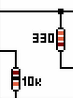

                        Davor, I need here some more explanation.
                        According my understanding for ordinary mono PI coil:
                        low damping R (say ~<1111R) mean over-damping
                        high damping R (say ~>1111R) mean under-damping
                        Here we have 3300R.
                        How we can explain that using such R coil become over-damped?
                          Although the driving transistor is m̶a̶r̶k̶e̶d̶ ̶5̶1̶0̶ not marked, I may only guess what transistor that is, the BJTs in general have quite less capacitance than MOSFETs, hence the damping requirements are less, not more. Even with MOSFETs a normal coil would critically damp at over 400 ohm, so I conclude that 330 ohm is overdamping it. Sure, if a coil is of less inductance (unlikely) or badly made, 330 would be too high, but that's unlikely.
                            But it is 3300 (3k3 or orange, orange, red - color mark) not 330?
                            On my display third color is red not brown.
                            Is this color mark on your display more brown than red?
                            Colors looks like this on my display (could be different on other display):
                              Directly compared with the colors of the other resistors and their values
                              plus with there vertically from up to down color-rings coding it's 330.
                              But of course the colors on that schematic are pretty bad:
                              orange looks like pink or rosee there and brown as dark red.
