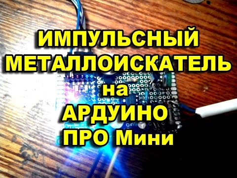

        After studying of various principles of operation of metal detectors I decided to stop on production of the pulse metal detector.
        As the basic scheme the scheme of the metal detector the Pirate was chosen. From it I took part with a transistor key, changed a little, changed the scheme of turning on of the field transistor on the compound bipolar transistor.
        Also I took the scheme of inclusion of reception part on the operational amplifier, I changed it for work with widespread OU TL072CP.
        And its indication I realized formation, generation of impulses, processing of a signal from OU on Arduino's controler of UNO.
        The scheme turned out very simple and small, and it is easy to bring together its in house conditions without printed-circuit board.
        I collected everything on a model payment, stability of the scheme despite hinged wires, very much even the good.
        I upload pictures of the metal detector on Arduino.

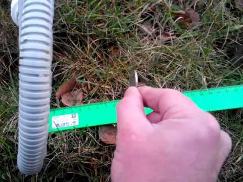

          With the coil it was necessary to experiment
          Having reeled up some different coils, different diameter and with the different section of a wire at me it turned out to come to the optimum size and sensitivity, and both on small, and to large metal subjects.
          Sensitivity on a coin of 5 kopeks of the USSR about 15 - 16 cm.
          On a copper plate of 5х5 cm - 20 cm.
          Iron jar from under coffee - 40 cm.
          Also I realized on Arduino automatic balancing of the metal detector and a linear scale on light-emitting diodes by which it is possible to determine distance to a metal subject.
