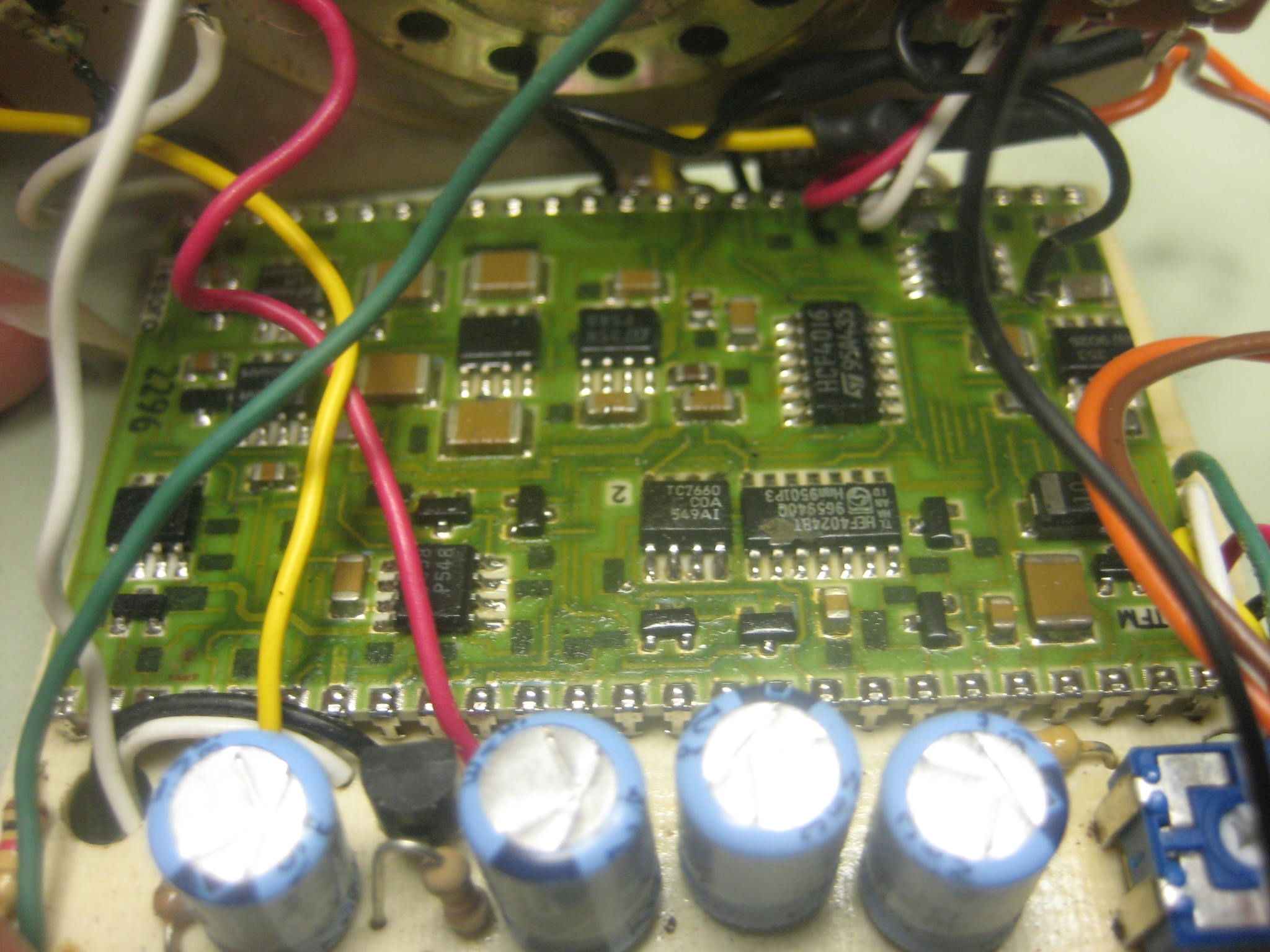

    I JUST picked up my first detector a tesoro cutlass II umax and from reading here and other places their are several mods that can be done to improve the detector. I know sven did one and see that several more might be possible. any thoughts on which mods I should do after I get this thing figured out?
    I got the detector for $100 CAD ($76 USD) from my local Kijji. An elderly man had bought it new for finding his property stakes so it has minimal usage, no manuals or accessories like a coil cover.
    Did I get a good deal? I know it is a beginner detector, but I thought a decent built beginner detector is better than no detector and it gets me out in the field.

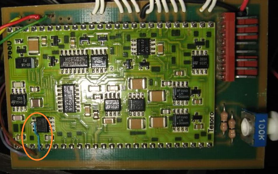

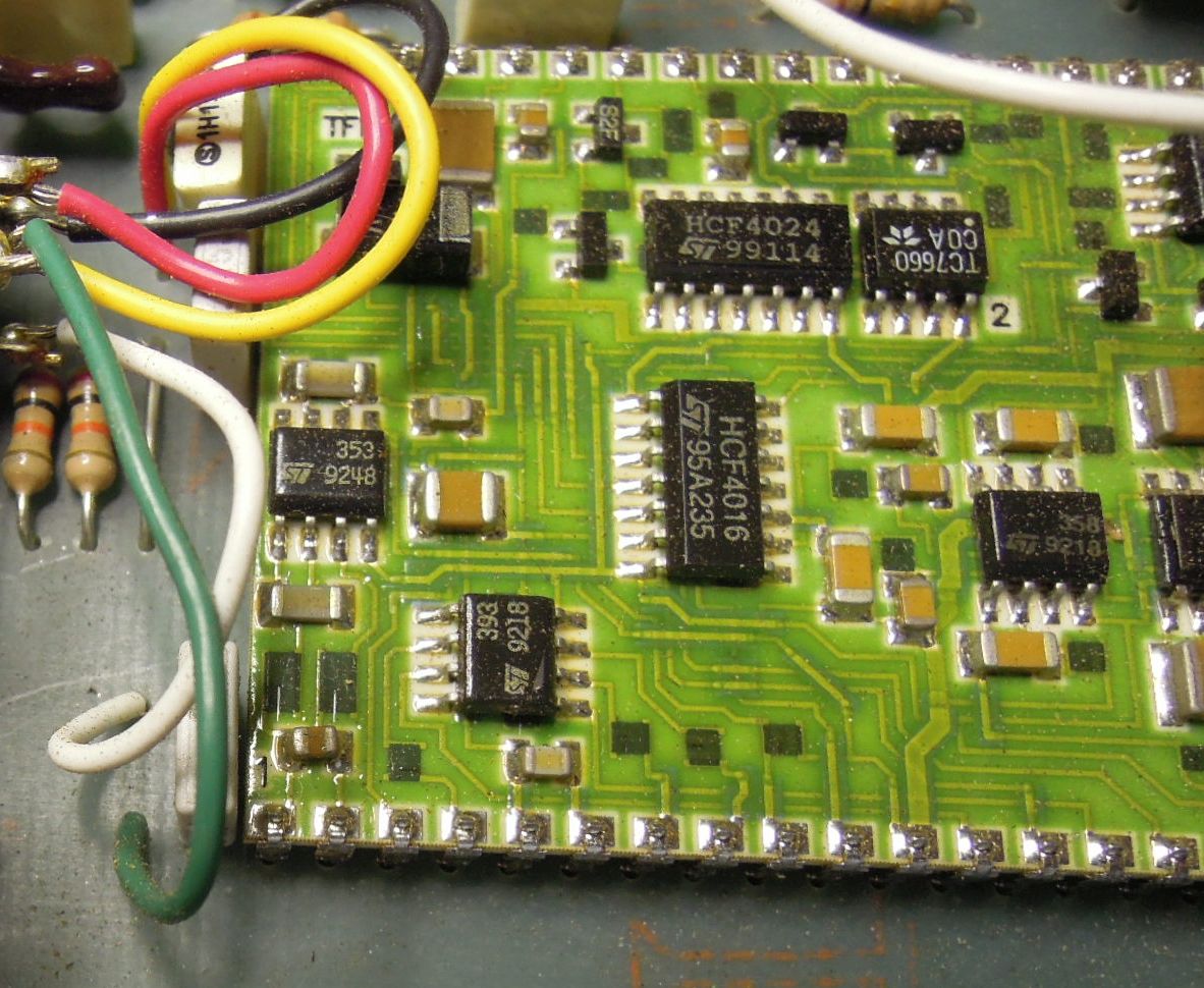

    The newer Tesoro's are made on a substrate so some circuit mods cannot be done.

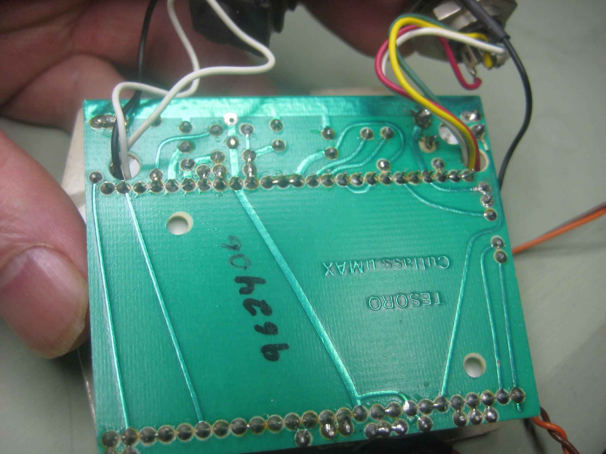

      just popped to cover off to have a look and it has no substrate.Click image for larger version

        I have been using my Bandido for about 6 months now. Very good on my ground. Strange thing is it match its air test in the ground. Not sure if that's because it of the interference in the house. My IDX looses about 1\3 in the ground verses air test.
        I believe the cutlass II was very similar to the silver sabres II. So performance should be adequate as it is.
          Wow they went back to discrete components so that means the sky is the limit to mods!
          It looks like they left some stuff out, maybe you can figure out how to add it back?

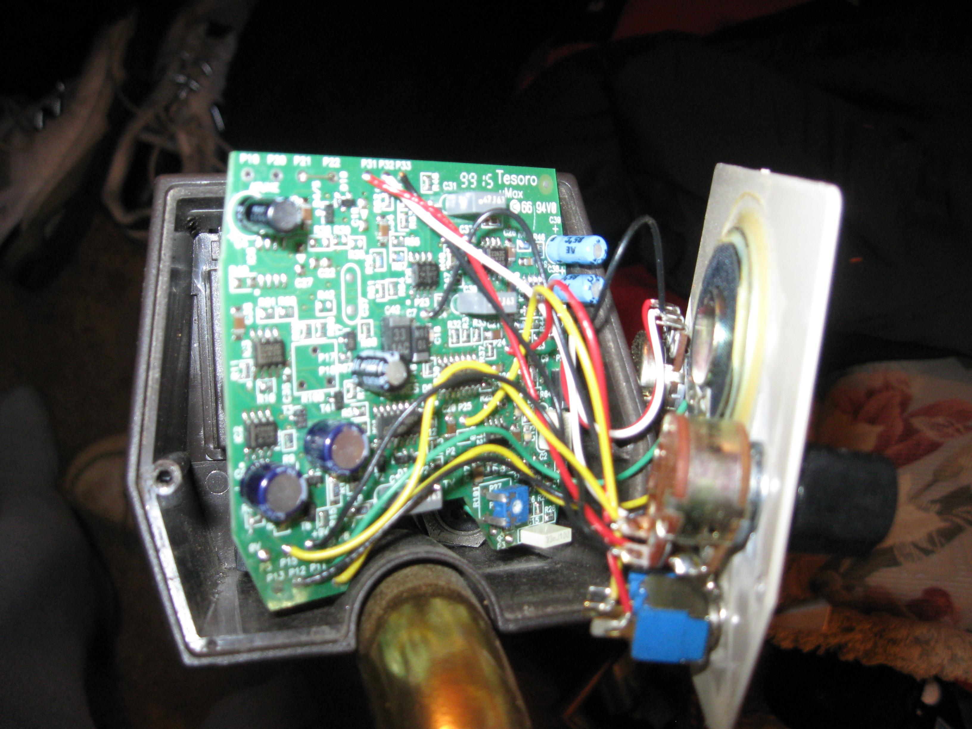

          Here's my cutlass;

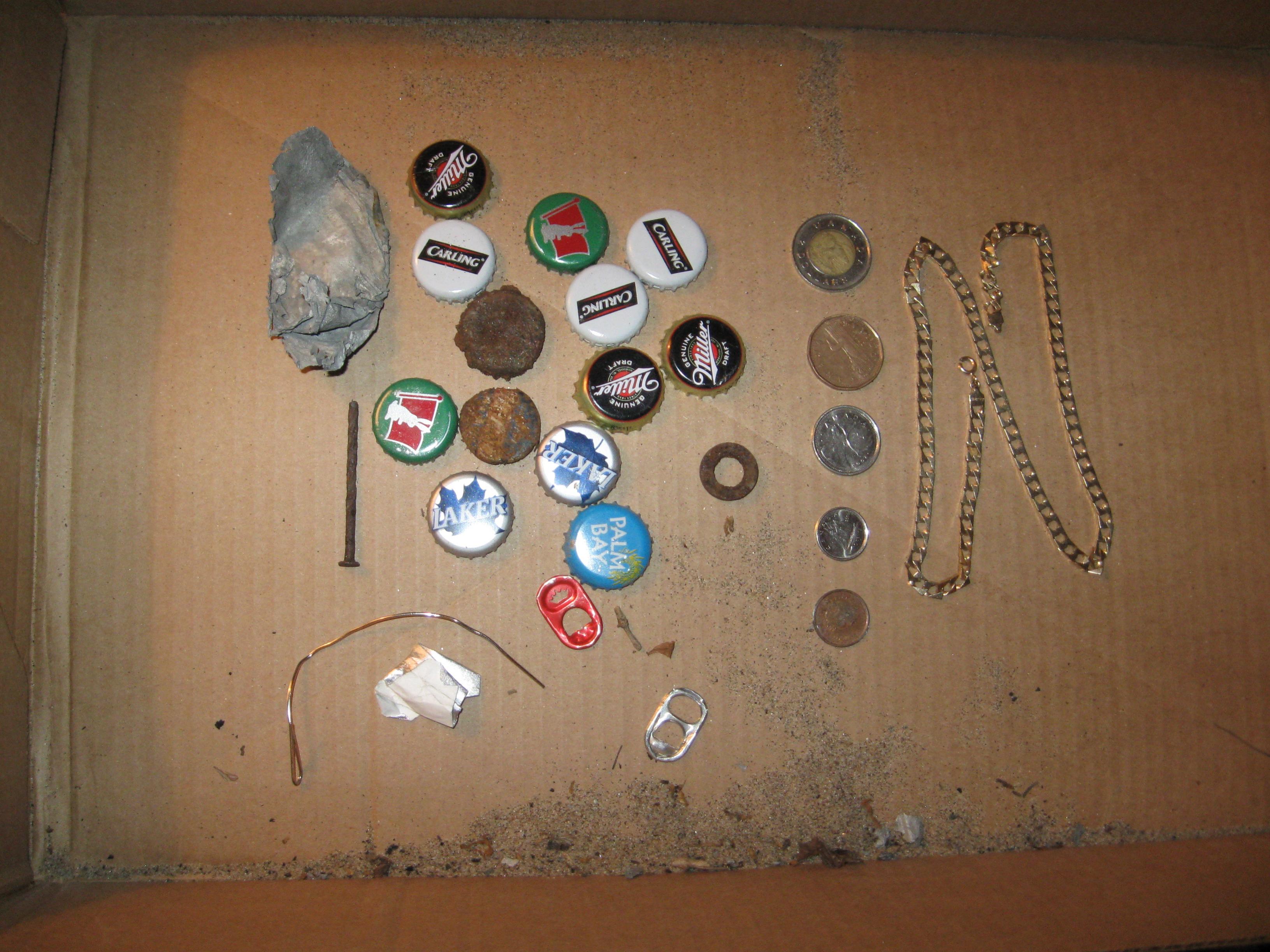

ID:	345871well that detector is growing on me! bought it Friday went out Saturday and got $2.35. went out this morning and scored 3.35 and a 20" 10k very heavy gold chain. I guess my little projects will get a jump start! project 1 waterproofing the detector.
              started ordering a few components for water proofing the detector. I am going to modify it in stages so I can afford it. purchased a guide series Plano waterproof box and some waterproof cable connectors for the coil. I plan to replace the 4.7uF caps with 10uf caps add a waterproof external power toggle and a waterproof toggle for switching between all metal and discrimination, I also plan to replace the stiff fragile wire Tesoro uses to connect components with longer braided wire. also just purchased a Garrett carrot to speed up hunting. I know the plano box is only rated ip67 and not 68 I plan to use plenty of silicon lube on the o ring and cool the unit a bit before closing the box so when it is in the water it has a higher pressure internally. I could also add a tire valve and use a small hand pump to raise the internal pressure 10-20 psi. since I plan to only be wading I doubt that would be necessary though.

                    Got my equipment orders out and parts are all ready starting to arrive. My order from digikey (waterproof switches, boots, 9v battery connector, caps) only took less than a day from ordering to delivery. 8 days into the wait for my 5 pin ip68 wire connectors from china, should be another week or so for them. then to start construction.
                      Swapped out the 4.7 uF caps with the 10 uF caps and everything seems to be working well.
                      I ran some air tests for comparison with the chart Sven made and it looks like I gained a couple of inches depth. desc was set at around 1 and everything else other than the 2 caps was stock with the standard brown donut 8" coil. the test was quick and dirty and I recorded the depth when the tone was easily repeatable and would be something I would dig.

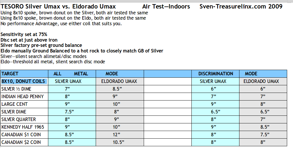

                        Just remember the Cutlass is just like the Silver umax, it does not have a true all metal mode.
                        Just discrimination mode. Tesoro fools you into thinking it does have all metal mode.
                        All metal mode is just a lower disc.setting that accepts more iron.
                        Disc mode for example using chart below runs from 40-180
                        All metal (disc mode) runs from 20-180
                        That's why you don't see much if any increase in air test depth between the two settings.
                        Generally the higher you adjust disc, you lose sensitivity and depth to smaller targets.
                        With a gain and sensitivity control(s) you could get some of the loss back, along with some noise.
