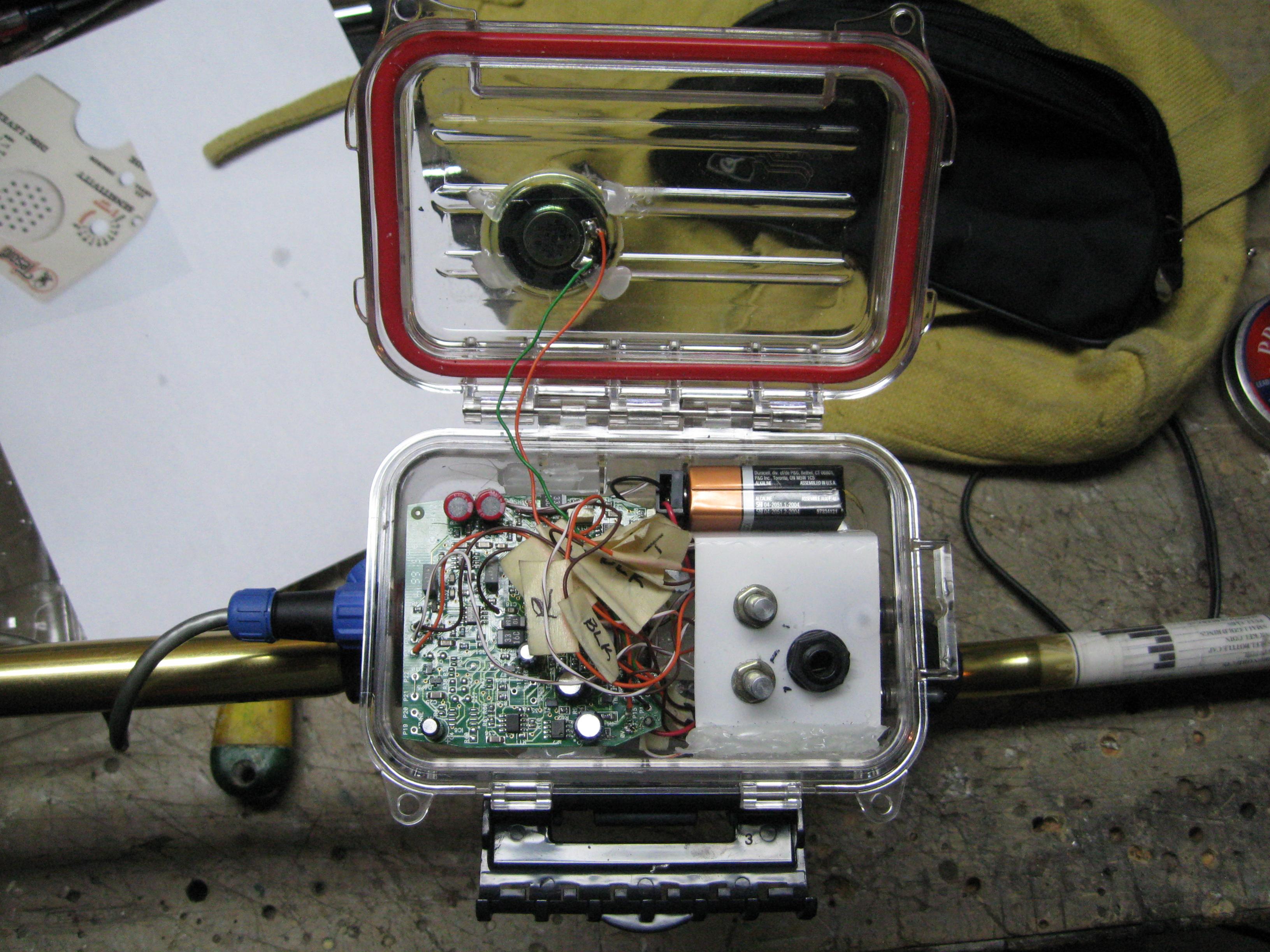

After all the mods I made I have been generally very happy with the detector and it's depth, but some days when it is warmer than usual I find the detector starts to give a lot of false signals. changing the battery makes no difference. all metal mode becomes almost useless and discrimination is very chattery with plenty of non-repeatable signals. it happens fairly often and the one thing in common when it happens is higher temps. all metal mode seems to be of less use more often than not due to noise. does my detector need to be re-balanced (the ground balance mod) or is it a heat problem. if it is a heat problem is there a solution? The air temps are from the 27 degrees centigrade to 33 degrees centigrade then the problems seem to be more common. the problems usually do not start right away and gradually increase as the day progresses. would adding heat sinks or cooling the box be of any use?

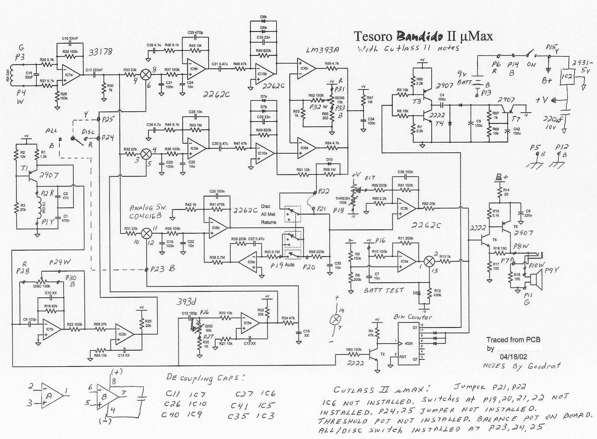

Maybe some component has gone bad due to age? The most susceptible part of the circuit is the transmitter. There is
a FET circuit there to auto adjust. The homemade ones sometimes eliminate that and have problems.
Chatter though would tend to come further down in the circuit.
This is a schematic that has notes for Cutlass II Umax;
The best way to find this is with a heat gun and freeze spray.
Heat it up until it fails then cool different components till it works.

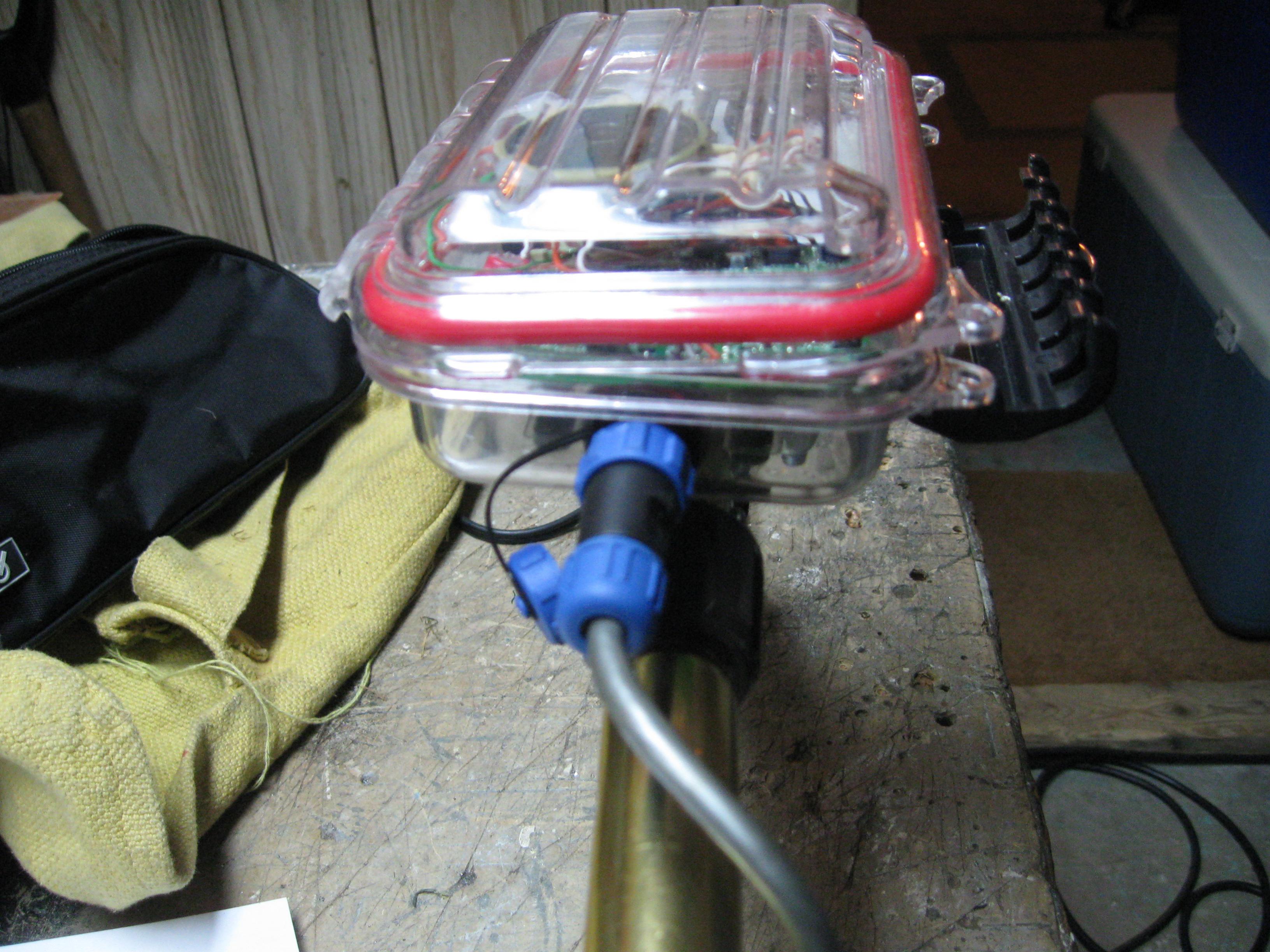

Found a couple of bad connections on the coil connector one of which was the ground. the solder joint failed and it was only an intermittent connection and 2 wires wires are almost broken off. I had a lot of problems with that connector both with it's solder connections and preventing the insulation from getting fried when soldering. It was probably the hardest part of upgrading the unit. hopefully this is the last of the problems and I will only have to change the batteries when needed instead of diagnosing problems and fixing them.
