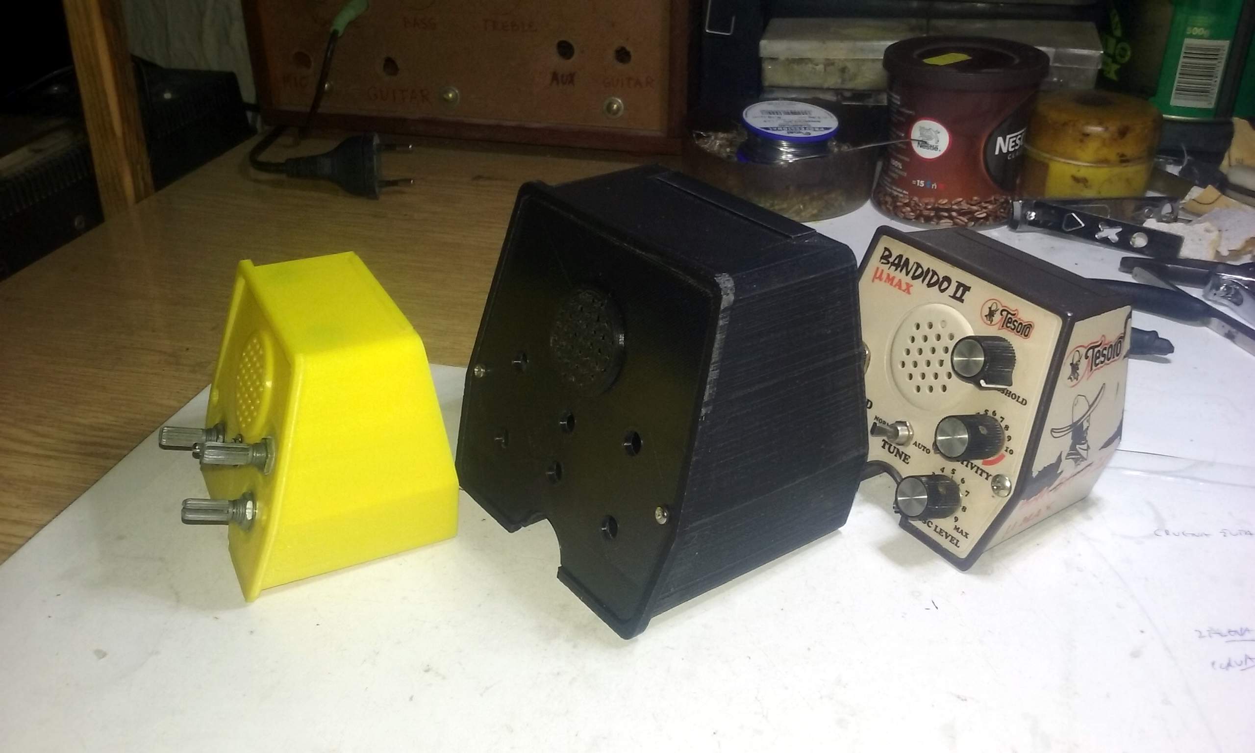

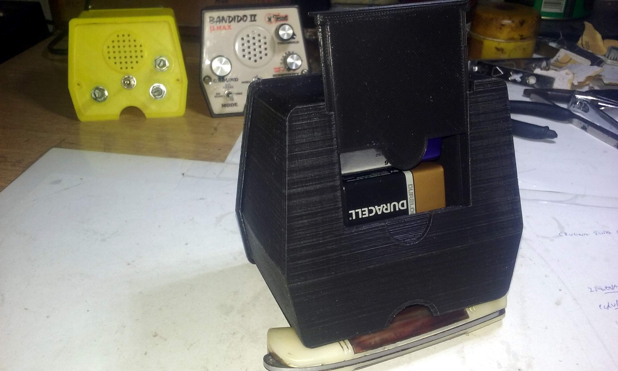

Oh i forgot something important to say!
There is experimental feature in Cura; the "tree" support.
I tried it and in some cases it is doing splendid job!
It slows down printing a bit. But results on prints are astonishing.
Very easy removable supports, no marks and no ugly parts.
Only drawback is in slowing down some complicated prints.
Also slicer sometimes needs 5x more time to slice the object.
But this mostly depends on computer performances.
I have now modest computer.
