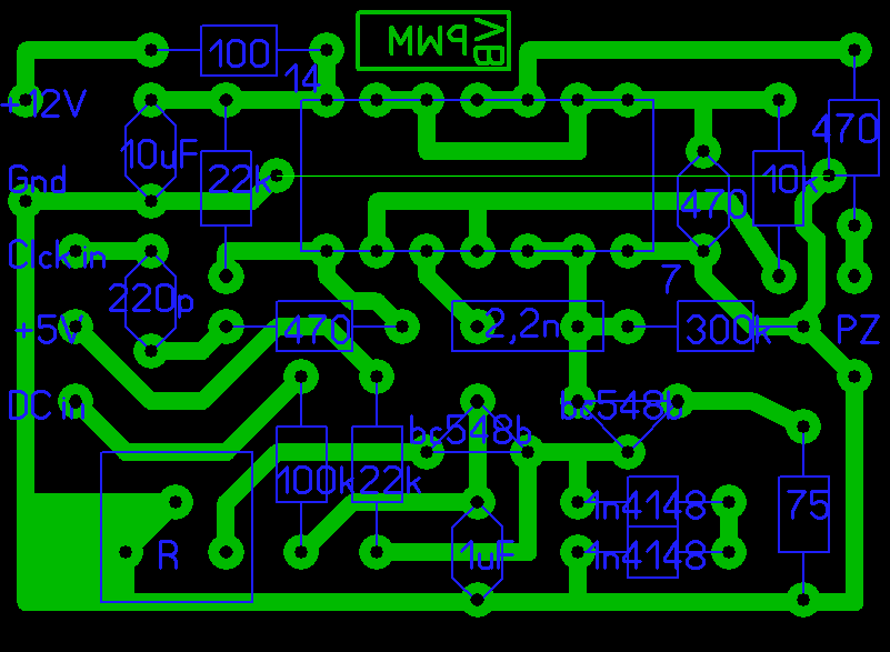

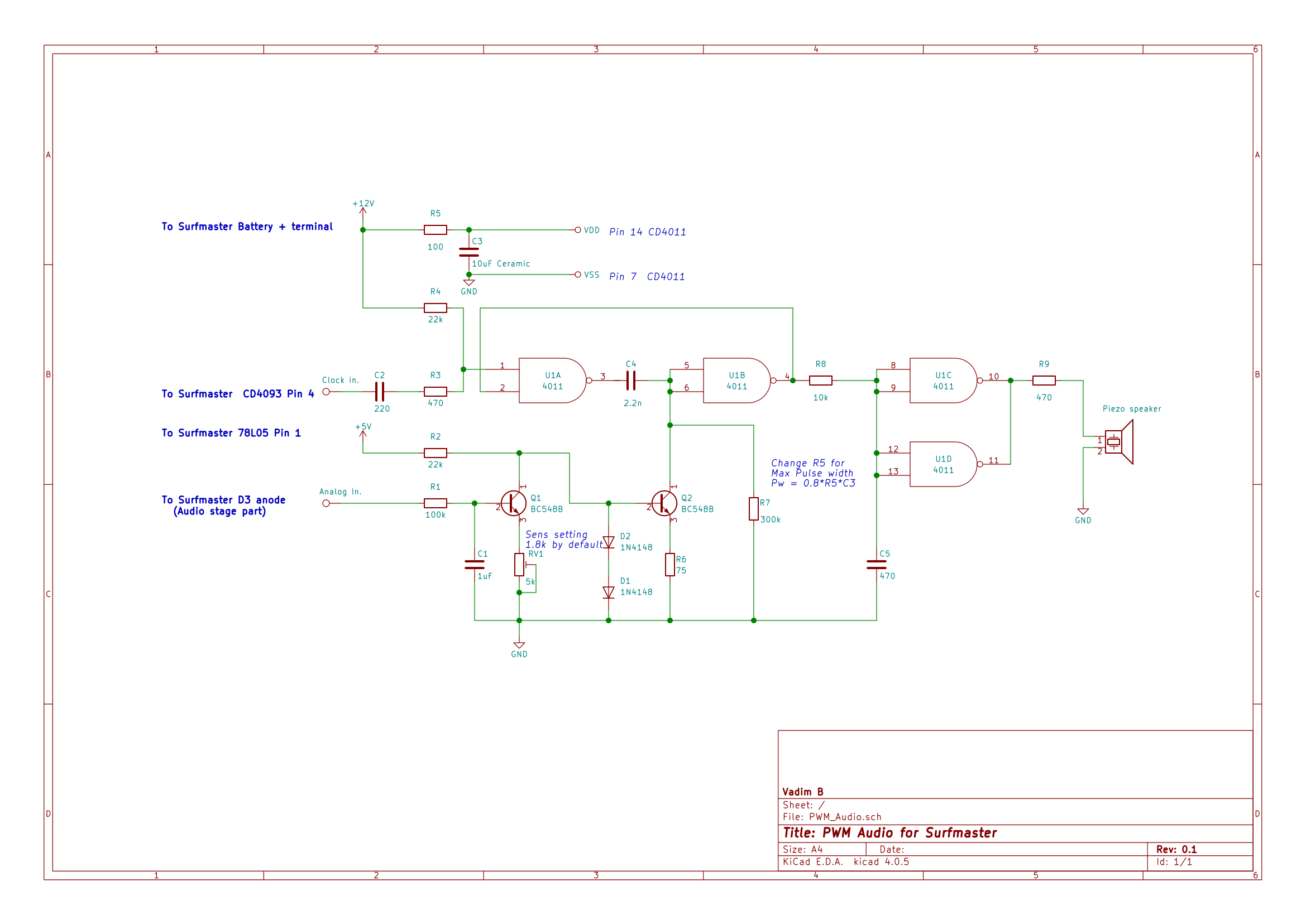

PWM Audio for PI Metal Detectors
    PCB + KiCad Schematic PWM_Audio.zip

    Circuit for clarity. Click image for larger version
    C4 (2.2n) must be film type Kemet, Epcos, Wima, all other - disc type ceramic, especialy C3.
    Gnd and 12V terminals must be wired directly to main capacitor leads (biggest capacitor) on Surfmaster PCB.
      @Vadim18 THX

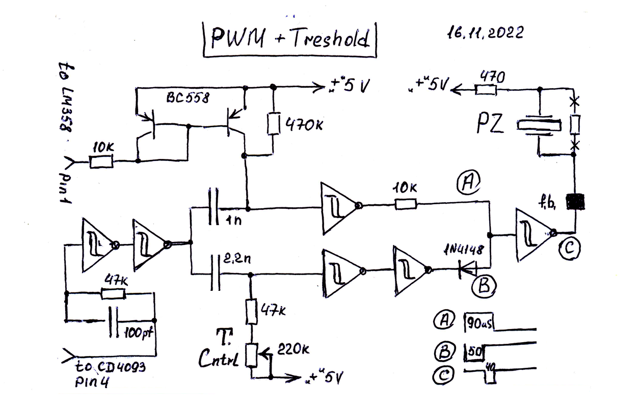

        Welcome to the world of alternatives, here is another option of PWM audio for pulse m.d.
        ic - any CMOS inverter with Schmitt trigger
