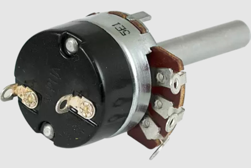

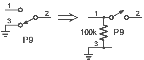

        I don't understand one of your sentences/answers "No, you connect pins 1 & 2 of P9 to a switch that is part of the GB pot. You will also need to add a 100k resistor between P9 pins 2 & 3. ?.
        On the "TDI Pulse Scan" it is normally just a switch, on the "TDI Pro" it is a GB Fine On-Off potentiometer, I would like to do on my Pulse Scan plate as on the TDI Pro.
        If we connect as you say the On-Off of the 10k potentiometer, and put this resistance of 100k. What are the remaining ? legs ? of the 10k potentiometer for?
        In addition, I saw a white connector on the other side of the board, what is it for?
        You want to get a potentiometer that has a built-in on/off switch. It will have the usual 3 lugs for the pot, plus 2 extra lugs (usually on the back) for the switch:
        Pot switches are mostly limited to SPST-type and the GB switch in the TDI is a SPDT-type. To make the SPST work properly you will need to add a 100k resistor, like this:
        Then 2 of the 3 pot legs are used for the GB pot. The third pot leg is not used.

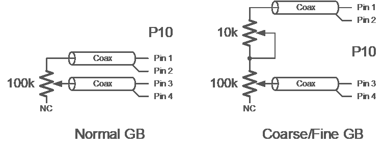

          The part I don't understand is the wiring of the 10k part (not On-Off). Because on the white connector P10 (4 pins) of the Ground Balance I will come to connect my 100K potentiometer to it.
          But how do I also connect the 10k to it if I understand correctly?

            Here is the wring for the normal GB and the coarse/fine GB:
            You might be able to get away with a single twisted pair instead of dual coax. If so, pins 2 & 4 will not be connected.

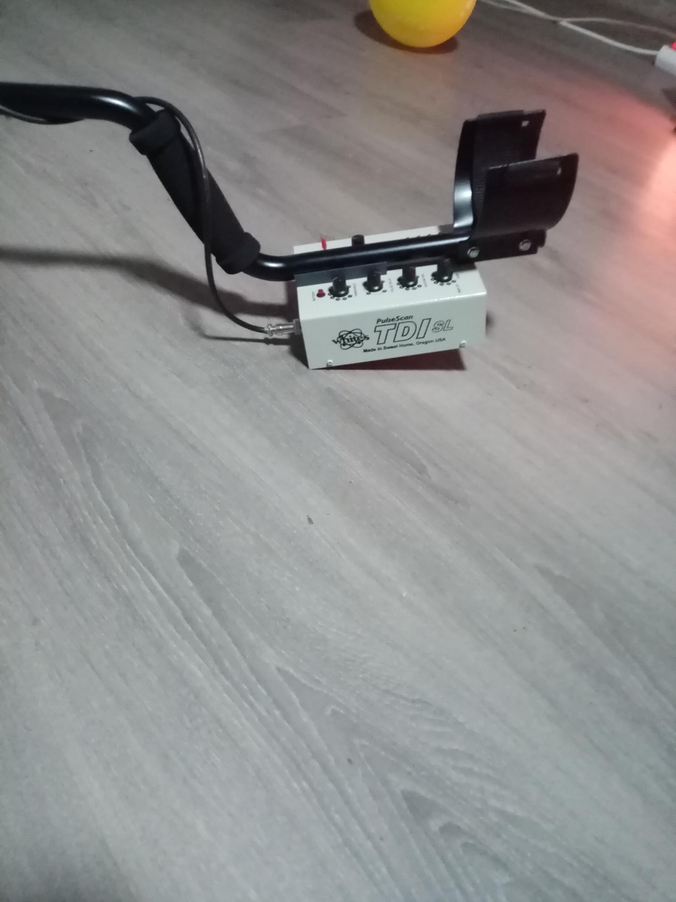

                            Looks like we bought the PCB TDI from the same store. I also had to make a box for the device.​ Click image for larger version

                              My case is made of aluminum and separates into 4 parts, your realisation is much prettier.
                              I think I have a problem but I can't figure out where. With the original 12" Dual Field, I capture Gain at full, no GB, Pulse Delay at the mini, Audible Threshold, Conductivity on All, a 19 cm gold ring (4-5cm less than a real TDI SL I was lent). For a one euro coin, the TDI SL took it at 30cm, my TDI modified at 2 cm (not 20 but 2)...........
