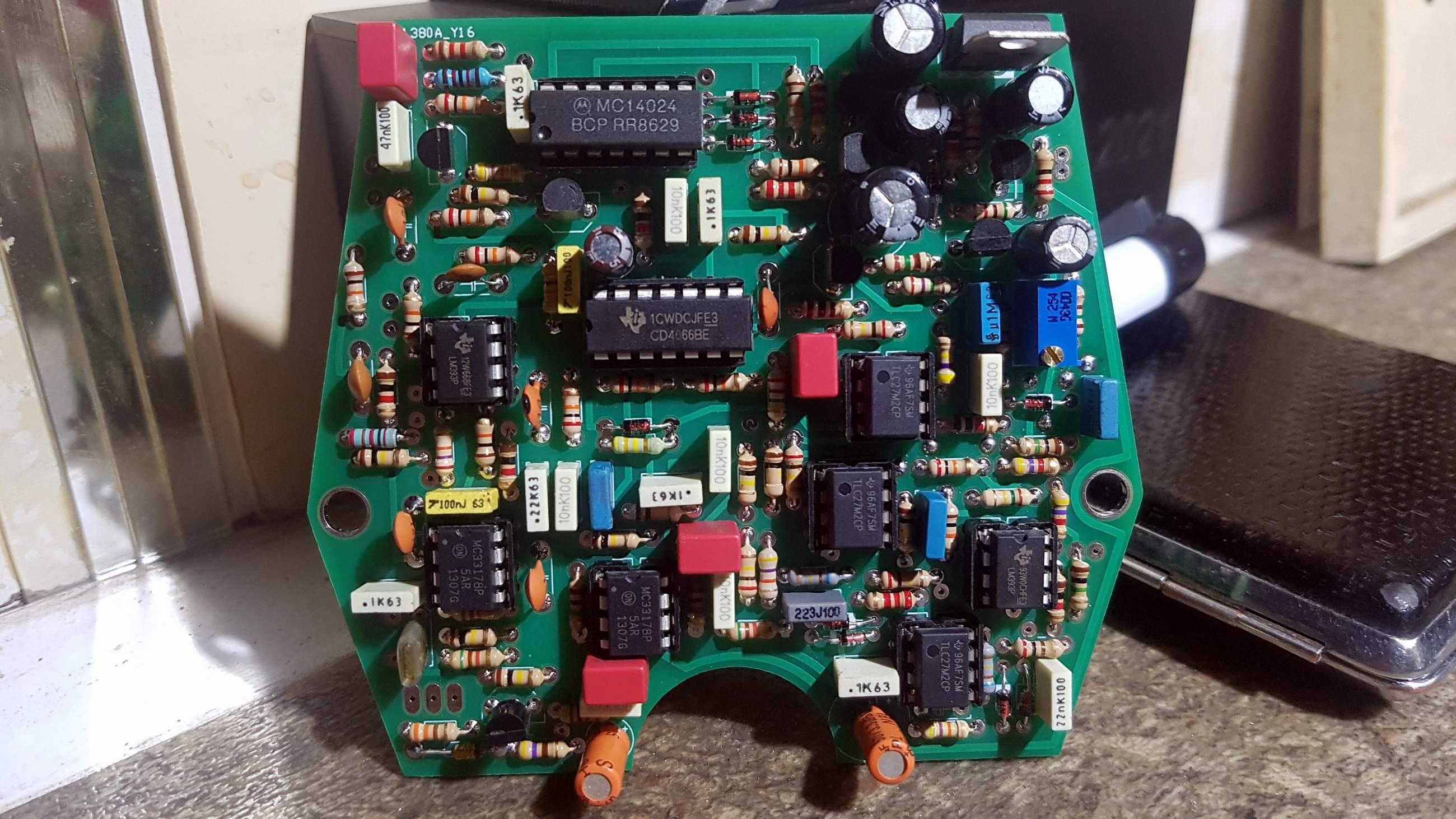

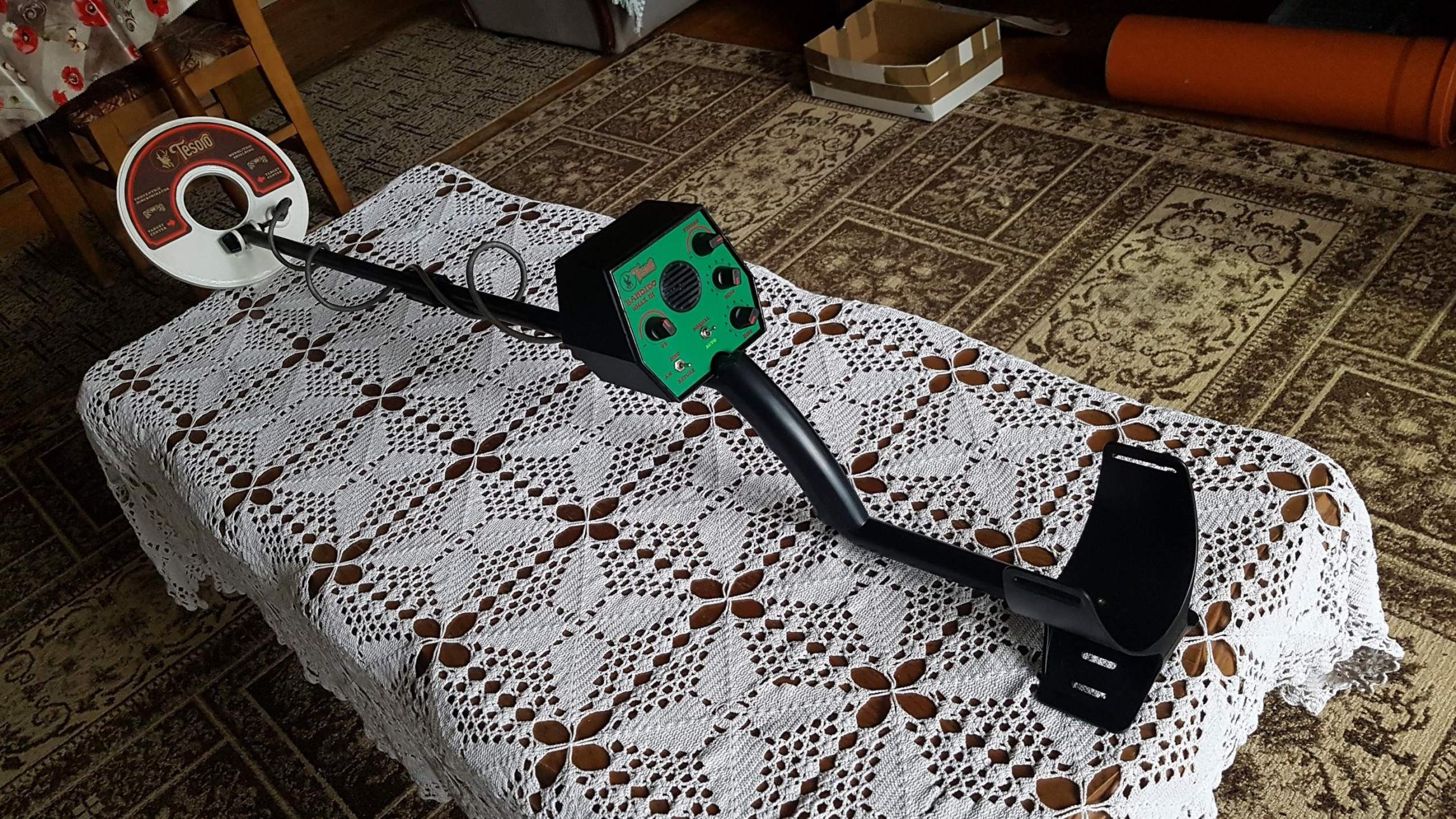

    As a big fan of Tesoro detectors; I made a Tesoro Bandido clone.
    With the original coil (pictures bellow).
    What to say?
    This works very well, super stable, GEB is fantastic, Disc is fantastic.
    AM mode works great. Threshold performs great.
    There is only one flaw!
    It doesn't have enough "depth" even in the air.
    The Roman coin "Antoninianus" (medium large) is barely detectable at about 10cm in the air.

    But that is not my goal. My goal is to get somewhat better performance with the original coil.
    Carl "provoked" me to start thinking about this in a different way, while writing on another topic.
    What are all the possibilities to get better performance? Coil is therefore a "constant".
    All that remains for me is to "mod" the TX&RX frontend. Pros and cons? Solutions? Ideas?

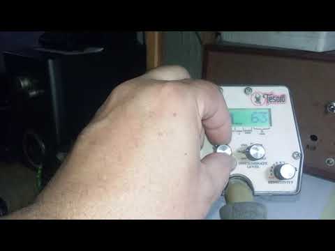

      A video where I show the incredibly low consumption of this Bandido. Otherwise, the detector is powered by only one 9V battery.
        I also found an old video of the original Bandido II on my channel that I no longer have.
        If I remember correctly (maybe not); watching this video it seems to me that the original works 1-3cm "deeper" than my clone... not sure.

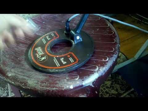

          And finally, also an old video (has it been 4 years already !!!) of my first encounter with a De Leon model:

              The Bandido design appears to me to be lacking gain in the G channel. In newer analog VLF designs the R channel (and G channel) are run with gains 4-8 times higher than the X channel because they are substantially ground-free, and the G channel is what we use for targeting. Also, if this is the design that uses a 6mH TX coil then you can get a boost from lowering the LTX.

                I'm tired, I've tried following that schematic with the pcb on my Bandido and so far I haven't come across any significant discrepancies.
                Everything that matters matches 100%. Except! I need to open Bandido and see what I put in place of the bipolar 4u7 capacitors. I'm sure I haven't found new ones in local stores.
                I'll have to check that out one of these days. But as for the rest; everything matches 100%.

                    Once upon a time, I replaced the TLC2262 chip with TL074, the sensitivity has almost doubled. Try it, it's not difficult.
                      If the ICs are put in the sockets, try to replace them. I`ve had such a problem with another VLF schematic - one and the same PCB demonstrate totally different behaviour replacing the ICs from different prodicers. With some of them the mashine is is shallow and nervous, with other is deep and with better treshold...
                      Besides, selecting and playing with resonant capacitor (and even rotate it on 180 gr.degr) one can notice verry different results, it can be understood even by ear, as well as measuring the detection distance...

                        No need to open the detector, I found the pictures. Fortunately, I always have a habit of taking pictures of the work process.
                        Two dilemmas are resolved; I put the IC sockets and the two bipolar ones are ok.
                        TLC27M2 are in place. It is difficult to say about the quality of the opamp.
                        Today, anything is possible, even if it's a low-quality opamp.
