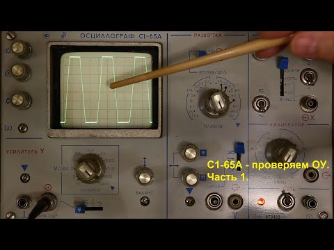

        This is interesting and educative!
        A friend sent me a PDF with his testings and experiences.
        I took the liberty of trying to translate into English.
        I am attaching the original and the translation:
          You can watch the video (several parts on the channel). There are subtitles in English.

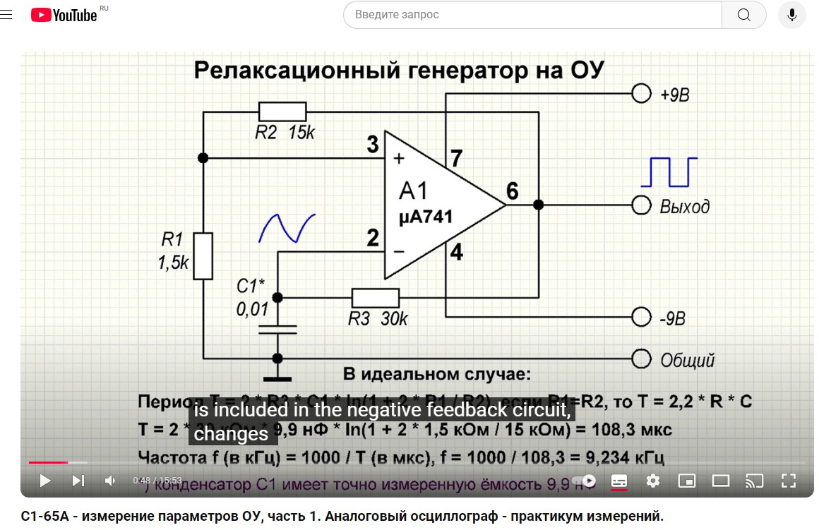

            The crossover distortion is curious. I wonder what's going on there. Is there a defect in the chip itself or is there something involving the test setup that's causing it, which doesn't seem to be the case, since the other chips don't show this behavior.
              Early opamp designs sometimes had crossover distortion due to the output stage becoming debiased at 0V. Newer opamps don't have this problem.
                I noticed that the crossover distorion is occurring below 0V (scope pics). It would seem due to the internal circuit of the op amp, it continues to sink current to the output even below 0V during transition or crossover. So there is some internal current source which allows this to occur. This, it would seem, is typical of many of these jellybean op amps.
                Anyways, this gives a clue why this distortion is occurring.
                There is no resistive load at the output. Followed by a coupling cap then to the scope. Am I correct or what? I don't think this has anything to do with fake or defective op amps but rather the test circuit itself is flawed.
                  Maybe I'm way off base on this one, but I don't like mysteries.

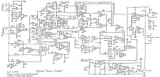

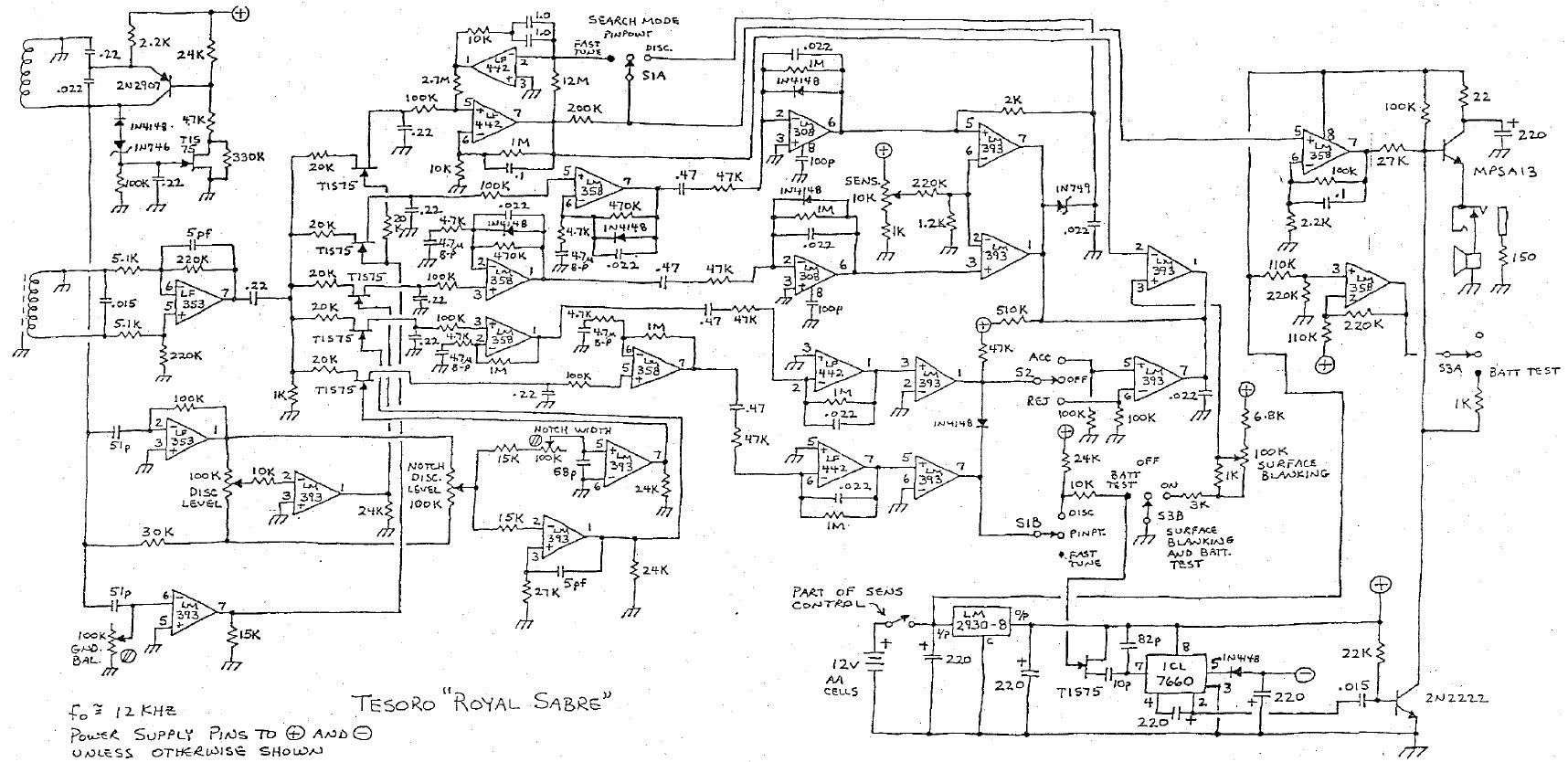

                              IGSL was built on the Tesoro core design.
                              GMT King Cobra is sure full copy of Tesoro core design. just a Note. do not waste your time. Click image for larger version
