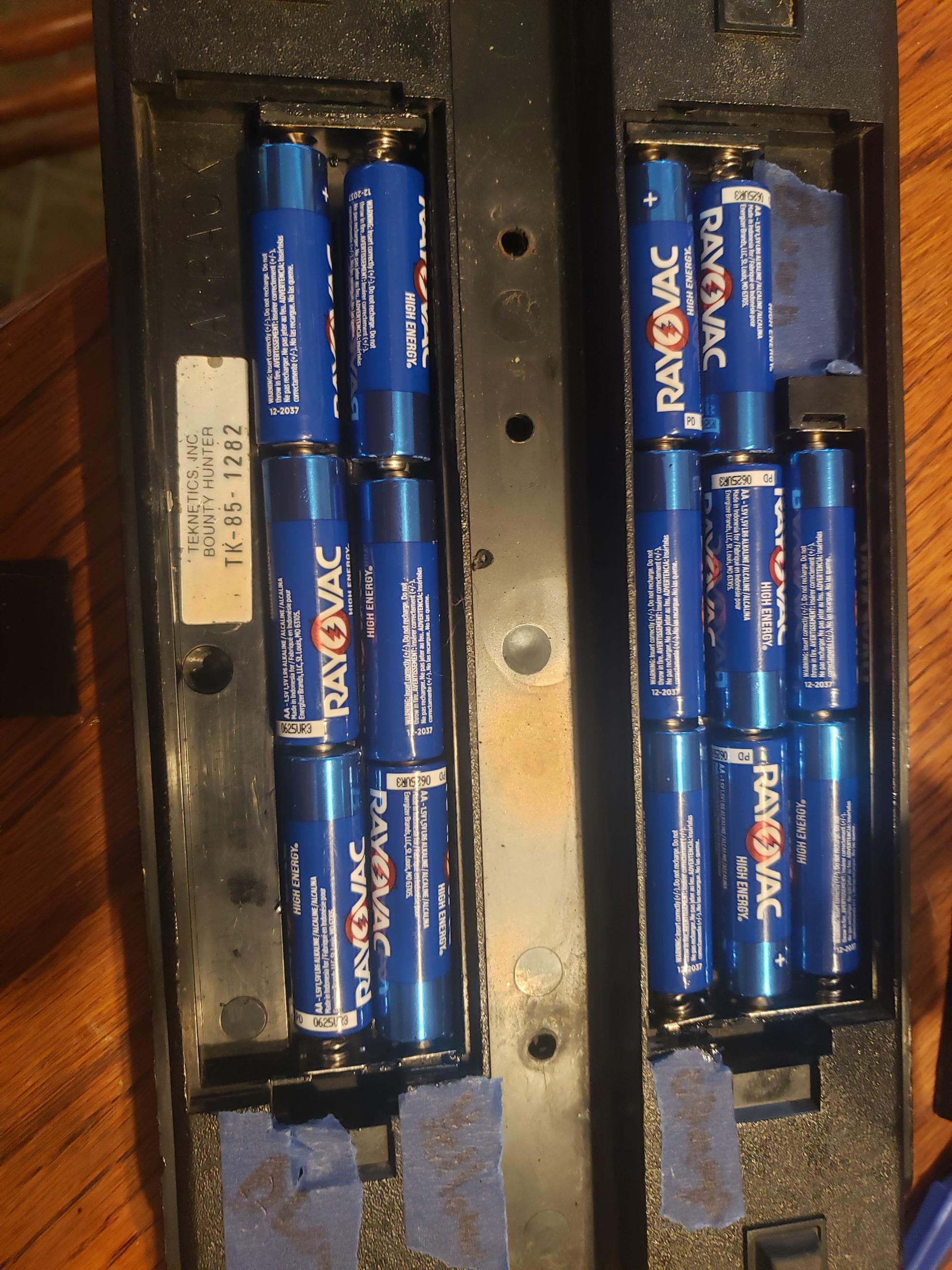

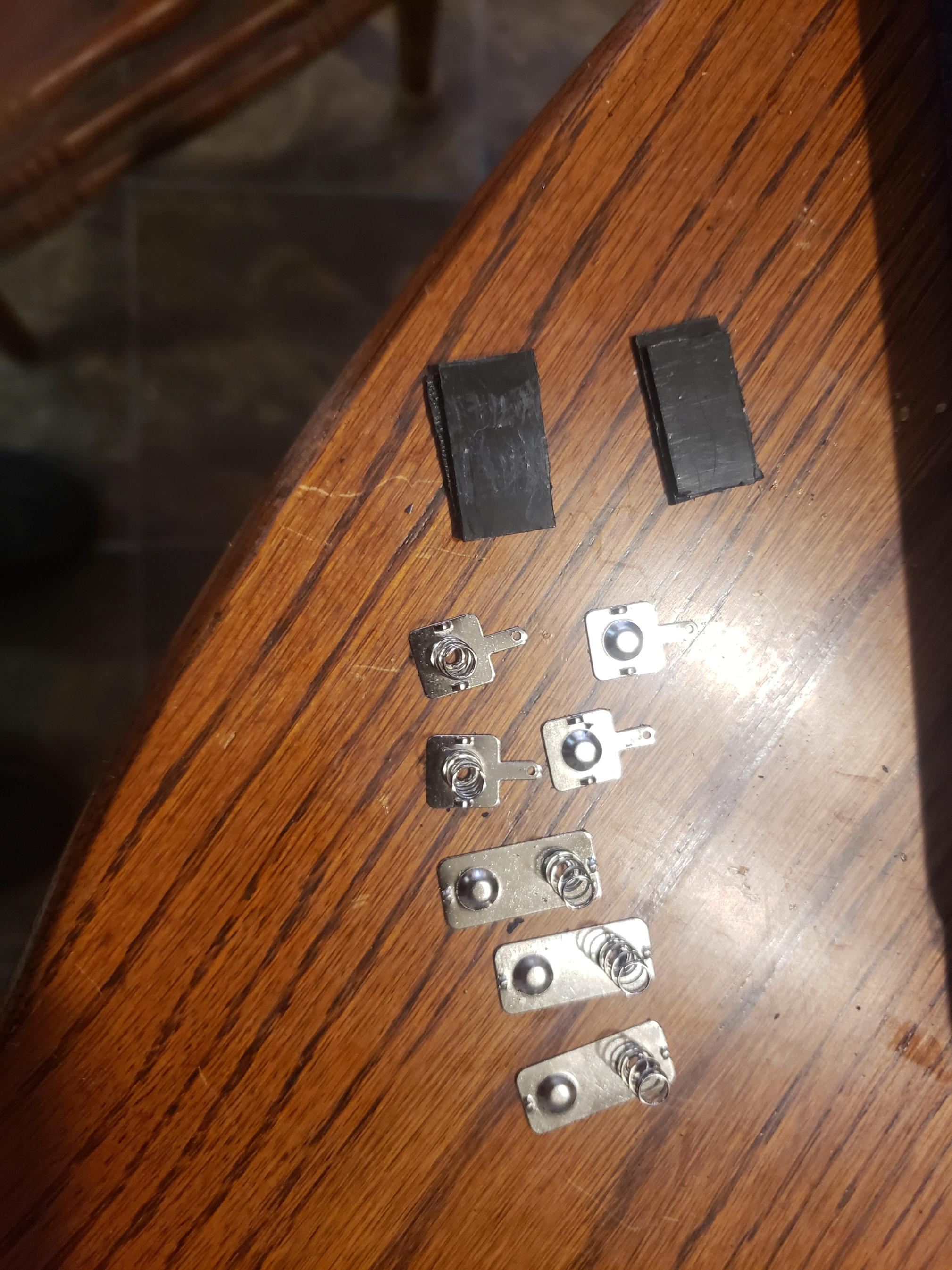

    I have found a way to fix older teknetics battery problem .
    Starts
    10-21-2025
    Ends
    10-22-2025
    Well done. The Tek designs were electrically the best of their day, but the mechanical design was really bad.
      Thank you sir
        The worst part is removing side decals have to work very slow with a heat gun
          Tips on keeping battery terminal corrosion gre use dielectric grease on contacts, desiccant moisture removing pack in detector battery compartment when not in use,I put them in my detector bags,remove batteries after using detector.
