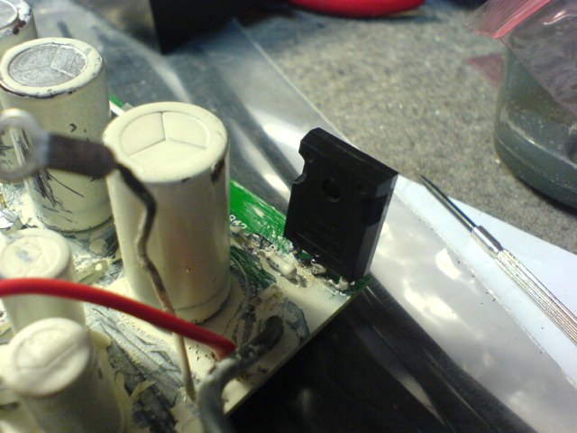

    To get some more depth out of the SD2000 I replaced the IRF710 with a T0-247 package STW20NK50Z. This is the same FET that is used in the GP 3000 series of detectors. To make it fit you will need to cut the legs off but leave 4mm and solder thin wires to the remainder of the FET legs. This will make sure it fits. The other mod I did was install an 8 volt regulator so I can run the detector from a 12 volt Gell Cell. Make sure that you make a good connection to the heatsink block as this FET gets rather hot.

        Any idea why the FET is getting hot?
          The FET should not be getting hot, when testing my 2000 the FET can run warm but not hot unless I have shorted the case to the positive ground!! When I was designing the PI back it '99 I had a similar problem, at first the engineer said that maybe the switching wasn't real square-waves, I found out it was the damping resistor. Changed that and no more hot FET. I would say that the FET is just not compatible enough. Stick with the 840 can't really see what you would gain with the one you are using now. A FET should not get real hot if everything is designed to suit it. You could do like I did and change the dampening resistors (remember they use 12+ in the 2000!)

                The MOSFET is probably getting hot because the gate capacitance of the replacement MOSFET is quite high compared to the original 810. What this may mean is that the gate drive is not sufficient to give a fast transition during switching on or off due to the increased capacitance of the gate.. The effect of this is that you may find high frequency oscillation of the MOSFET. This will cause the MOSFET to overheat. I would check the the gate drive.
                Stefan
                  You fellows are right, the gate drive circuitry is only good for around 1200pf as when I loaded the Fet input the drive pulse started showing delayed rise time causing the fet to get hot. I found a Fet that has only 900pf input C and its rated at 9 amps for .45 ohm R. It is a STP11NK40Z.
                    rated 9 amps and it's getting hot? have you considered water cooling?

                        I had a GoldScan 5 that I had modified to work on 24 volts and even though the series resistance was 6 times higher than Mr Minelab I still had to install a computer fan into the box to cool the output fet. A lot of the heat generated in the M/L machine is from uping the voltage to 8 Volts extending the on time and the .5 ohm coil resistance.
