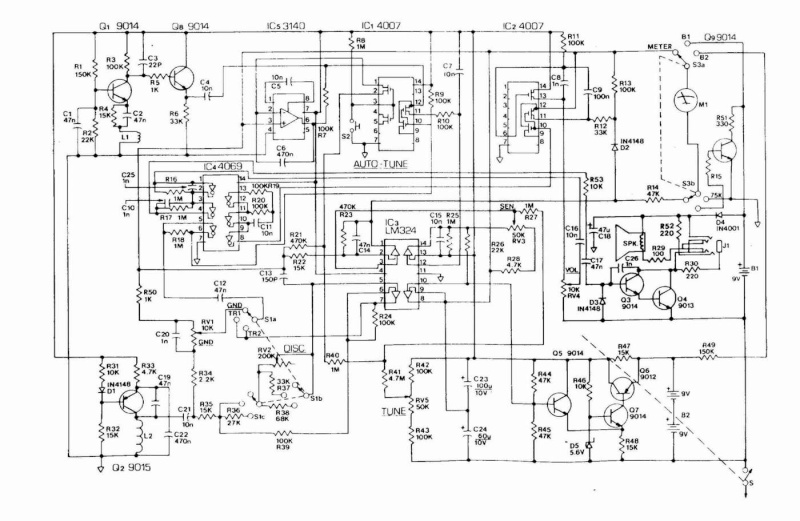

    The detector schematic you posted is for a Micronta 4003.
    I've attached the manual which shows some component changes, but don't ask me if they improve anything. I've never tried it.

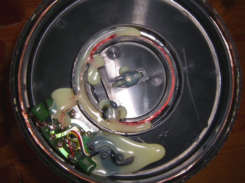

              OK - a slight mistake. The detector I have is a Micronta 4001, not a 4003. The schematic I posted is the correct one though.
              Here's a photo of the inside of the 4001 coil. As you can see, it's unshielded.

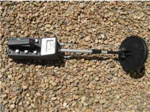

                  A simple fix would be to put some electrostatic sheet in the bottom cover, and attach it to 0V using a simple spring arrangement. That's the way it's done in the Garrett Crossfire coils, and this seems to work ok.

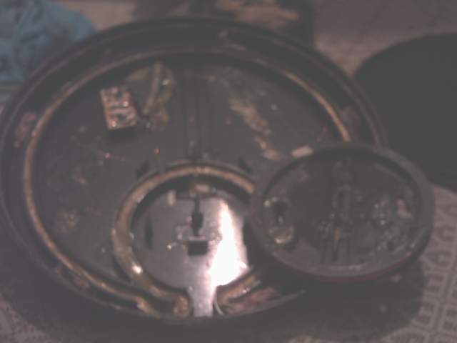

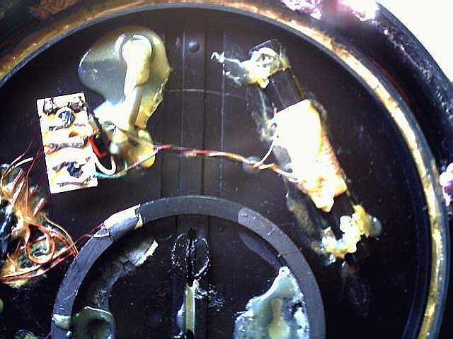

                    I have 4003 model. My coil is omega. But what really confuses me is some extra windings over TX and ferrite rod with some windings inside??
                    What is this? Some old way of balancing? Ha,ha,ha!!!
                    My coil is shielded.
                    I intend to change this. Eject and toss this ferrite rod and extra windings.Only shielded TX and RX will remain inside. If not working well than i will make another omega coil.
                    Very good coil was at MD3007. Same dimensions (TX 165mm and RX 75mm).Also omega. 60 windings for TX and 160 for RX. Right now i dont remember wire gauges...hell, it was 5 years ago! Omega coil is easy to null, not a problem at all.
                    So...coil is not a problem...question is; is 4003 worth of trying to mod it?

                        Hi Ivconic,
                        This is very interesting. Are you sure this is the same version of the 4003 as shown in the previous schematic? How is the ferrite connected with the other coils - in series, in parallel??
                          Yes it is Micronta 4003... schematic above...
                            But.....
                            your question provoked me to start using my brain for a while....
                            sheeeshh! This looks like some mod added after a while!?
                            It seems some "expert" did some mod on it!? Look on photo...
                            Ferrite rod has 2 coils...one coil connected to one end of RX and other on one end of TX...???? What the hell is that?

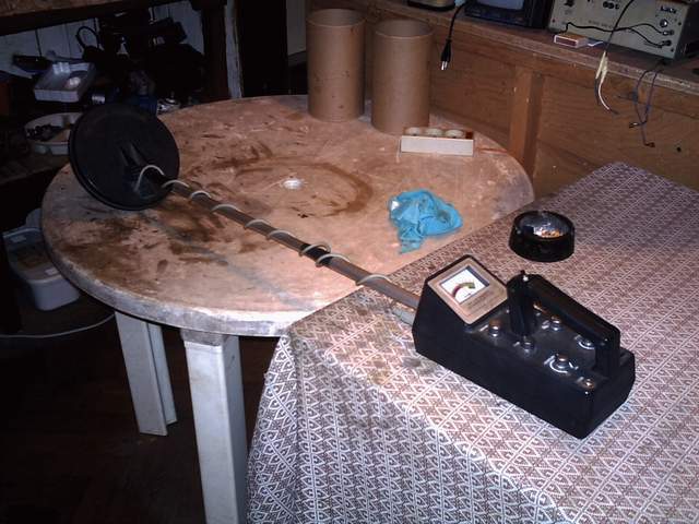

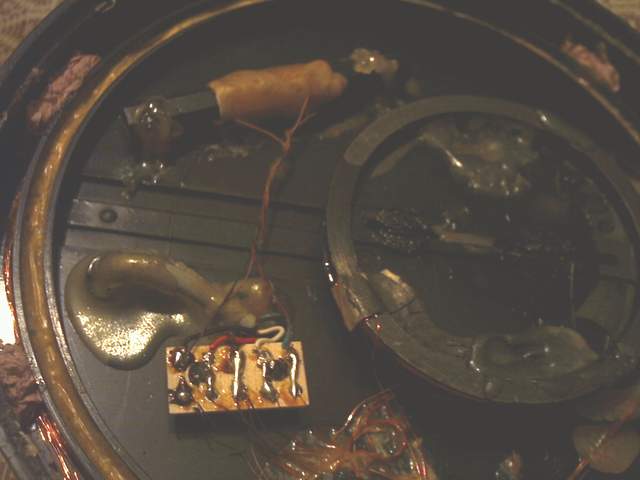

                            I got this detector week or two ago. Didnt payed to much attention on it up to recently. Detector is in working condition now. Detects 1e coin at 15cm in air....disc is working..
                            But now..."hooked" with you question, i did detailed examination and......bull!

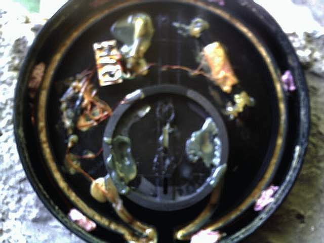

                            This photo is last of previous coil setup. I just reassembled it and removed that idiotic ferrite rod and some extra added windings....bull!
                            Tomorrow i will balance it again and use only TX and RX without any extra rods and mods....
                            TX has faraday cage (Al foil). RX dont.

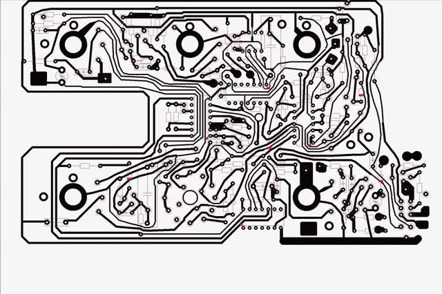

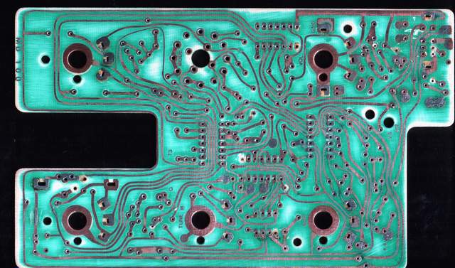

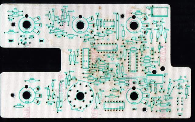

                            Exactly same coil i saw at MD3007. Same inductances,resistances,wire gauges, diammeters...only bit different coil housing.If you search pages here, you can find my retrace files of MD3007; pcb and components placement.
                            Comparing that MD3007 and this 4003...i can conclude that MD3007 actually presents newer and in some details improved version of 4003. Same working frequency, same oscillator stage, same few other stages.....minor differences. At MD3007 audio has 3 pitches. As coil closed to metal pitches are changing from lowest to highest. Generally....both detectors are working in same manner..also same performances - lower class...
                              On this photo you can see how that "geniune" mod ended! Not to mention all the smile on my face!
                              Bull!
                              And i thought i saw everything...!?!?
                              I can only assume that this coil will work much better, now when all the scrap removed from it!
