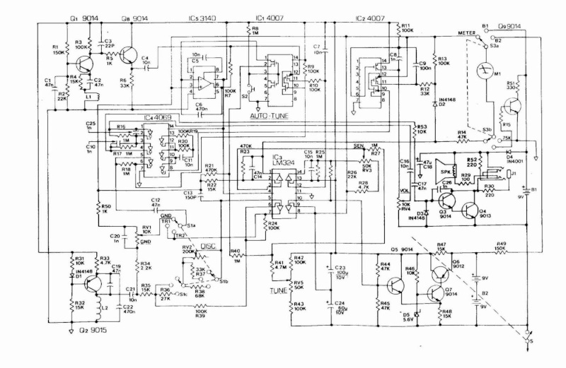

                    I JUST POSTED THIS ON THE HOBI-DETEKTOR SITE , SO HERE ARE THE MODS FOR THE MICRONTA-4003 FROM A RUSSIAN FORUM. CHANGE R-33 TO 2.2 K OHM . CHANGE R-29 TO 10 OHMS AND SOLDER A 2.2 MEG. OHM RESISTOR ACROSS PINS 1 & 2 OF IC-1 WHICH IS THE 4007 CHIP..................EUGENE

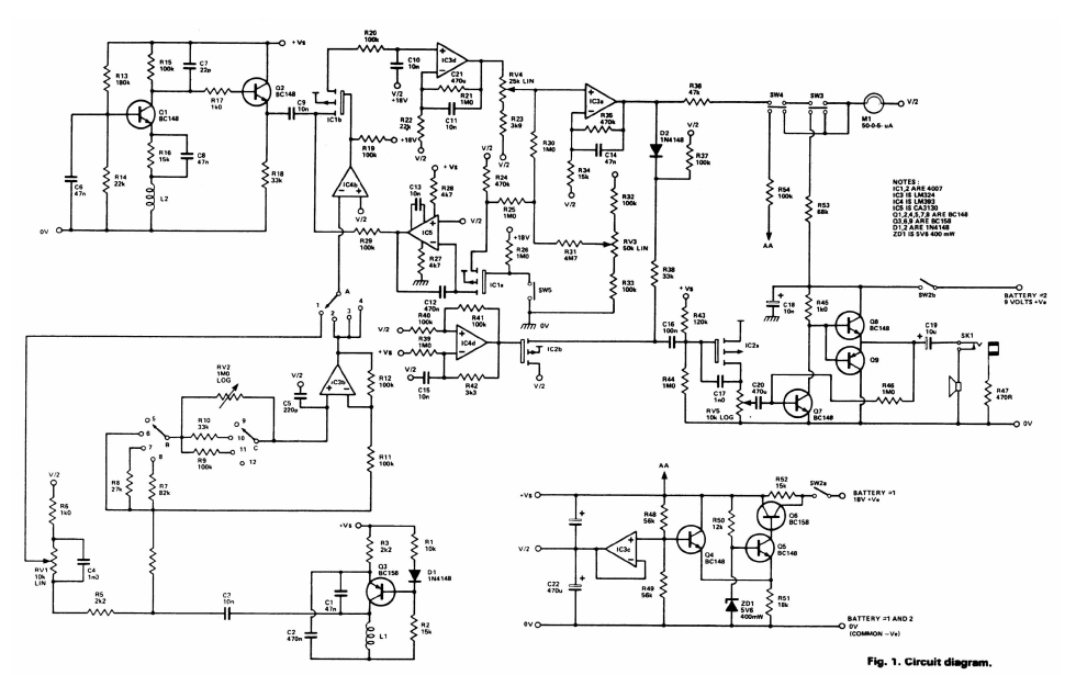

                      WOW, LOOK WHAT I FOUND !!!!!!!! ANOTHER WAY TO MOD THE MICRONTA-4003'S !!!!!!!!! COMPARE THE 2 IMAGES AND TELL ME IF I REALLY NEED GLASSES. THE SHADOW-300 PROJECT FROM 1980 ?? RADIO-SHACK CAN OWN WIMBOURNE PUBLISHING !!! WHICH CAME FIRST THE CHICKEN OR THE EGG ?? ..................ANYWAY IT LOOKS IDENTICAL TO ME , WHO COPIED WHO ?? ..........EUGENE

                        HERE IS THE PDF PROJECT FILE OF THE ALTEK QUAD. THIS HAS POTENTIAL , WHICH MEAN'S THE MICRONTA-4003 HAS GREAT POTENTIAL ALSO !!! YOU CAN BUY THEM FOR $20. DOLLAR'S OR LESS , MAKE THE MODS , IMPROOVE THE SEARCH COIL , AND YOU HAVE A DECENT DETECTOR !! .....EUGENE
                          Hi Eugene.
                          I constructed it before ...25years. It was a medium.... to good detector.
                          But why anyone to construct it and not the modidied TGS??? It is smaller and more more sensitive.
                          It is my opinion..
                            These are the same mods that I already posted in Post #2 of this thread.

                              QIAOZHI , YES I SEE THE ZIP FILE NOW, SO I WILL NOT TAKE THE CREDIT , BUT I AM GLAD WE FOUND THE MODIFICATION. ALSO THE 9014 OR 9015 ARE VERY LOW SIGNAL TRANSISTORS ,THEY MIGHT ALSO BE CHANGED. AND MOST OF ALL THAT SHADOW 300 PROJECT SCHEMATIC IS REALLY SOMETHING !!!! WHO COPIED WHO ?? TAKE CARE........EUGENE
                                Yes - that's a very interesting finding. I already have both these schematics, but have never noticed the similarity.
