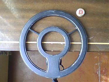

            Hello Thcruil and Simonbaker , The Tracker IV is the same as Discovery 1000 and the 'Walmart stores" Pioneer 101. They can be modified or upgraded . The first thing to do , is post a photo of the search-coil , then we can see if you have the cheap 7 inch coil which is a piece of junk !!! The 1st step is up-grading the search coil .The 2nd step is checking the "tx transistor circuit" . when we see some "clear photos" of this "Discontinued" Metal Detector , then we will proceed with some Modifications.....And yes , this Metal Detector is worth keeping and Up-Grading.........Take Care.......Bye.....Eugene
              coil is 8 inch, came with detector.

                            I want to make DD coil for it, so could somebody please help on how it should look like, maby some threads in the forum, how i can determine approximate coil specifications, is there some simulators, coil calculators...
                            what size it should be for beach hunting and fast covering of large areas? maby elliptical would perform good...
