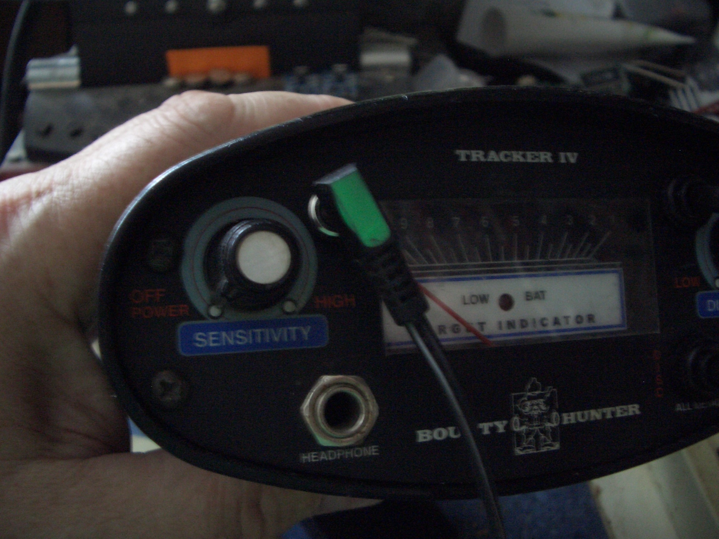

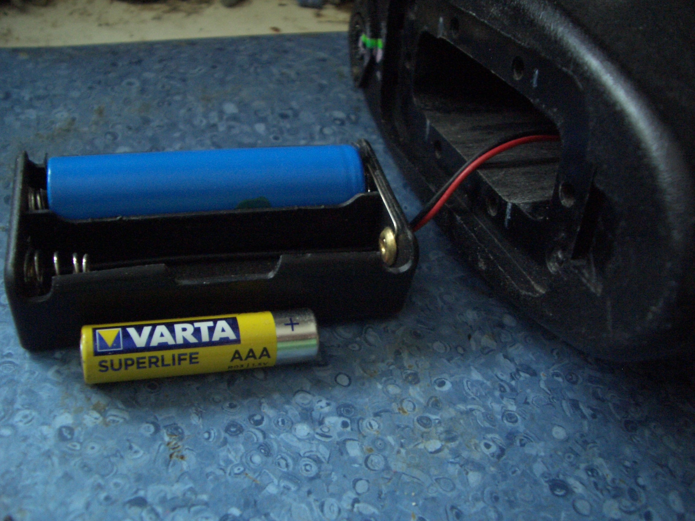

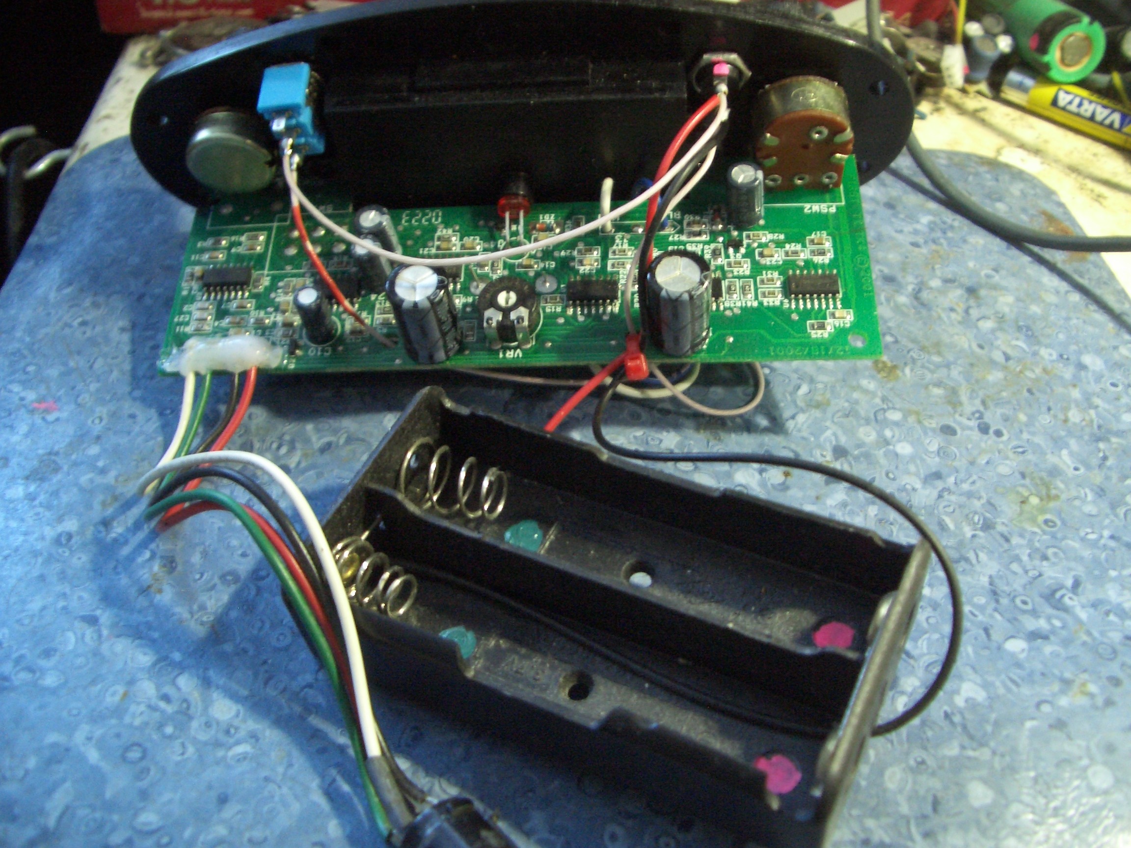

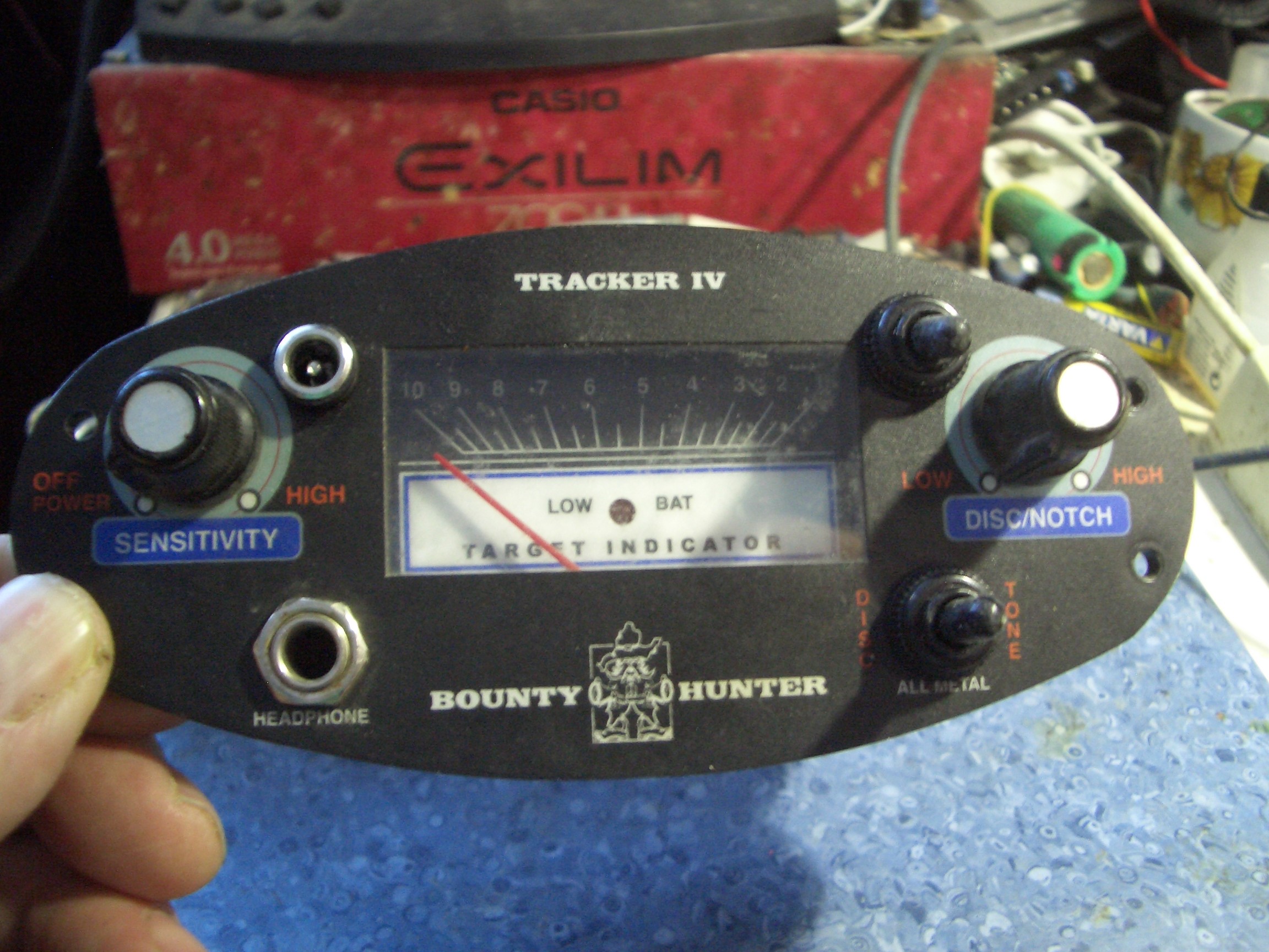

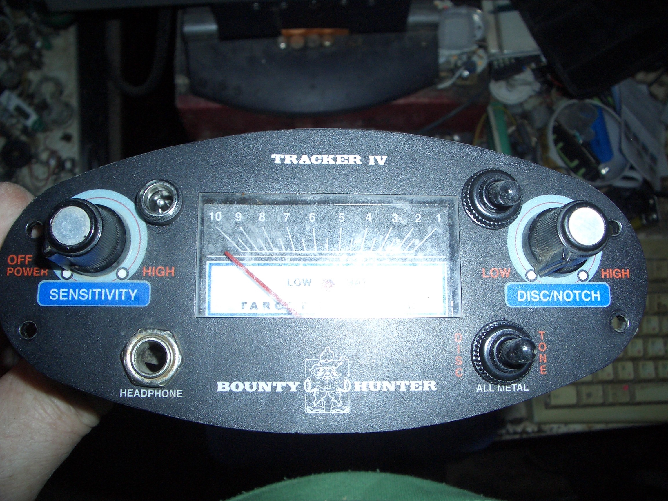

    job continue... added a socket 5.5 for bat charge on panel. added a switch for power on.

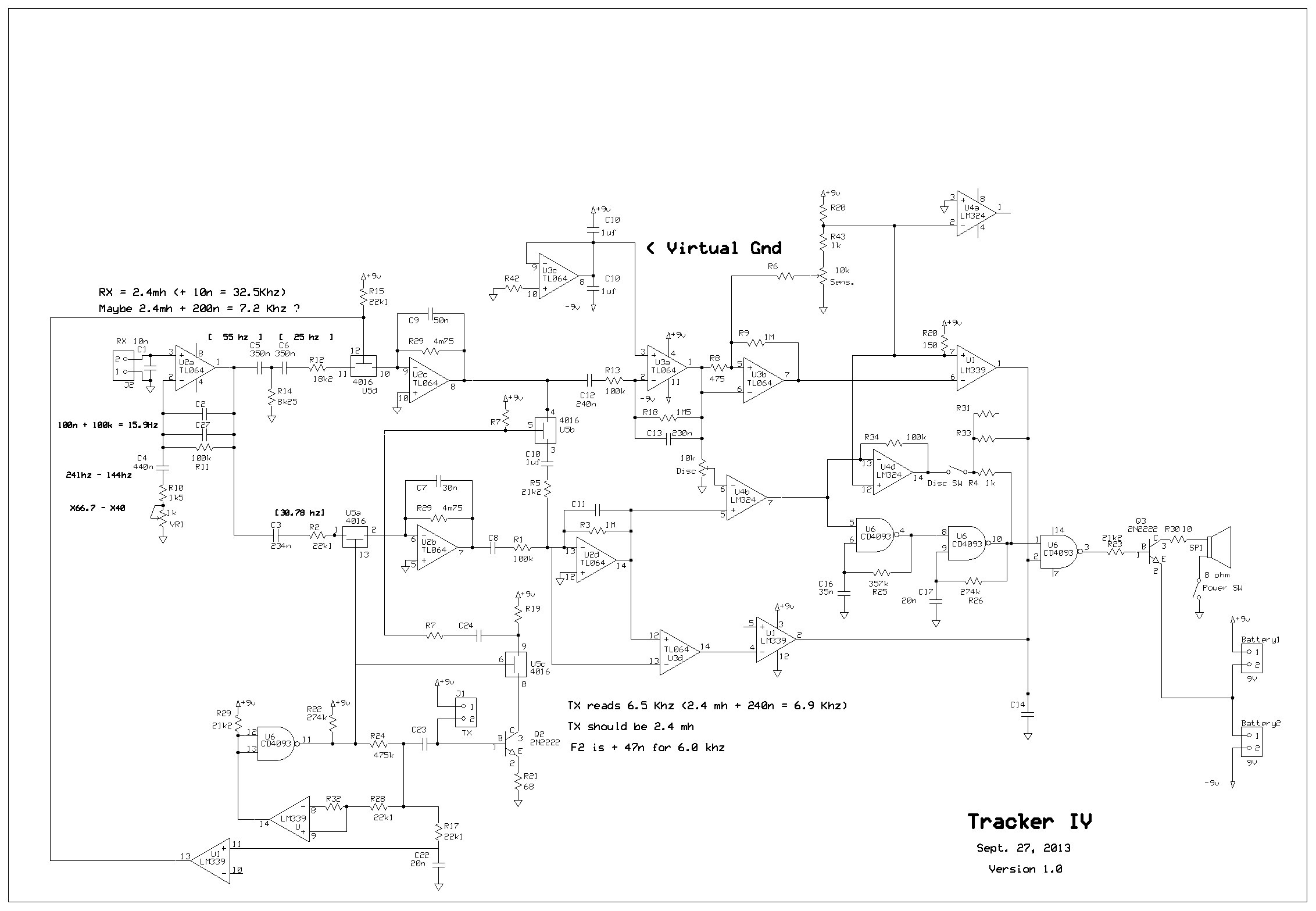

      Hi ktt315, do you have a schematic for the Tracker IV please? I have a water damaged thru hole version in need of repair. Thanks
      Neil
        schematics are not mine made. i do not know they are correct or no.
          Every little helps. Thank you so much

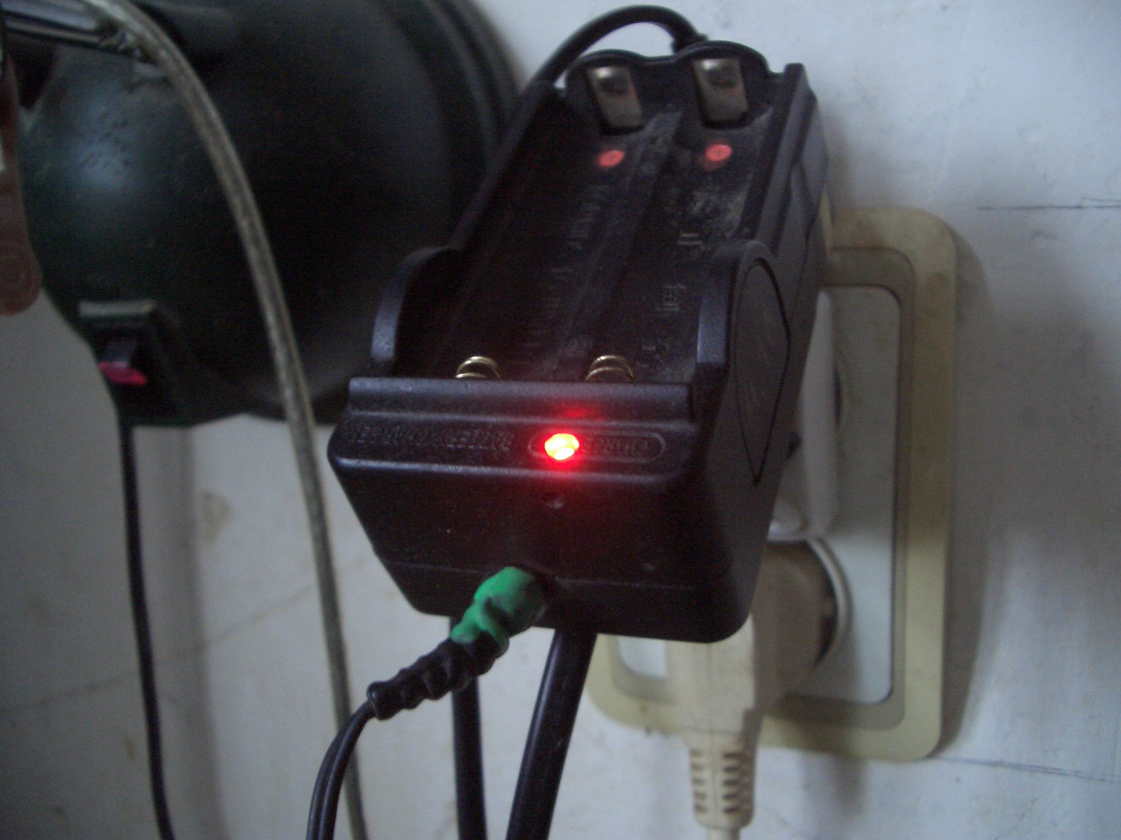

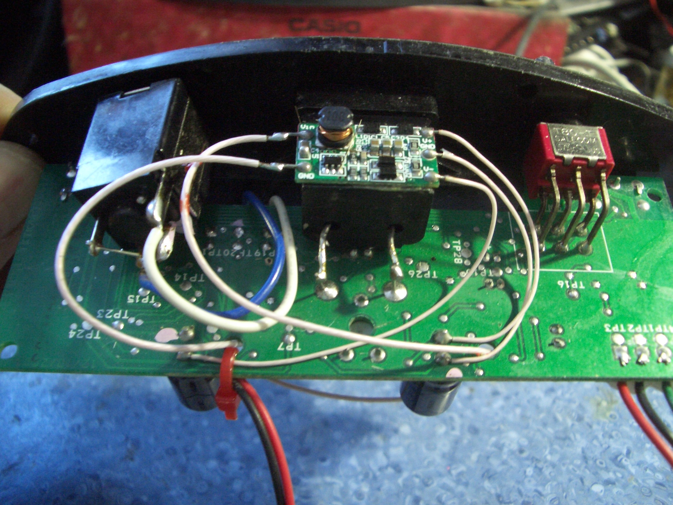

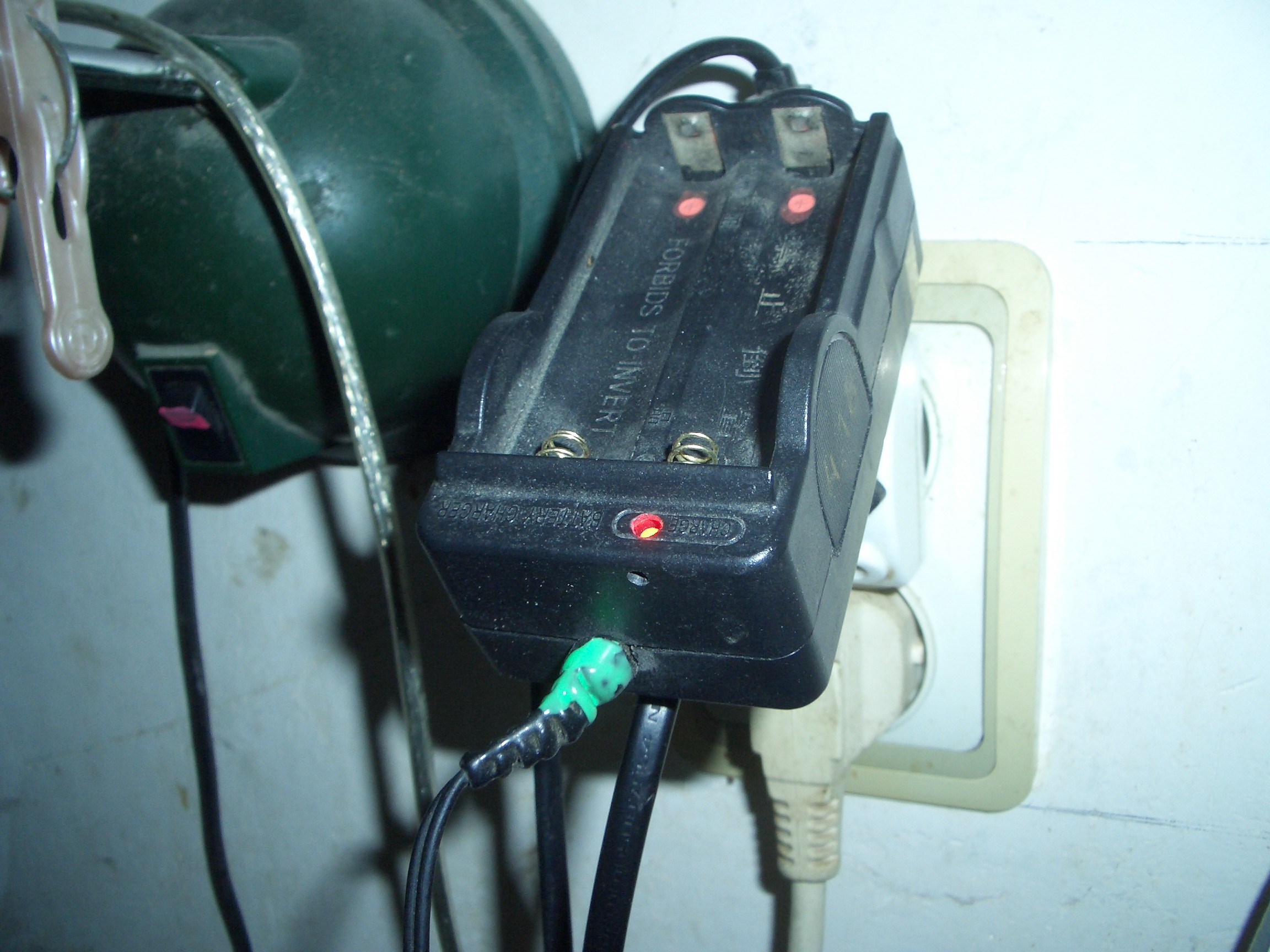

            18650 on charging
