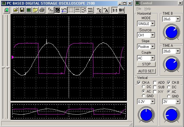

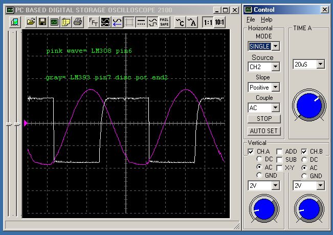

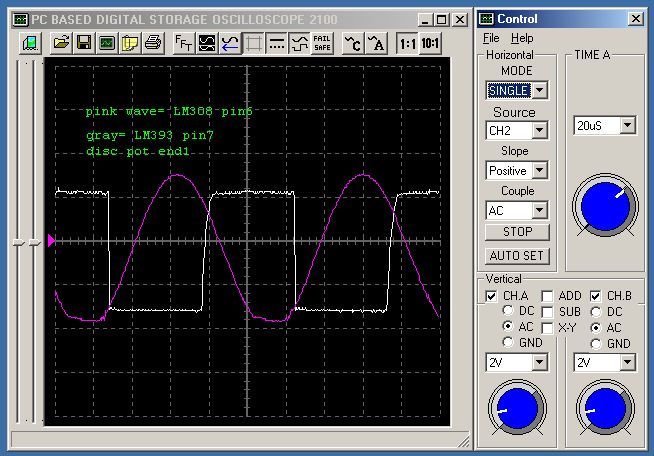

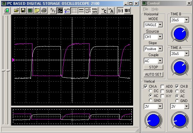

              • Hi Ivconic, please help...
                I made new DD coils, (27cm outer diam) parameters:
                TX: n=100 wire 0.28mm, 7.0mH 18,2 Ohm
                RX: n=54+54 wire 0.28mm 8.0mH 20 Ohm.
                TX signal: 13V PP, and 10,4KHz
                -Ut: -5,9V.
                Sensitivity poor: 1euro 2-3cm, deo flask cc.30cm
                what the error?
                pictures:

                  • In my opinion you made wrong Coils.
                    Tx: 5,5mH
                    Rx: 6,5mH
                    Is better.
                    And small question.
                    What oscilloscope you using?

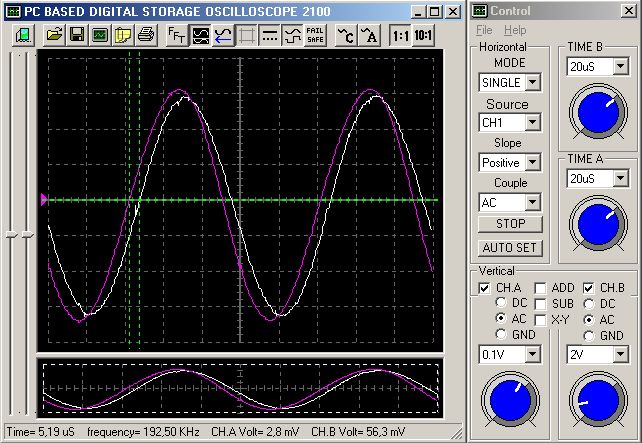

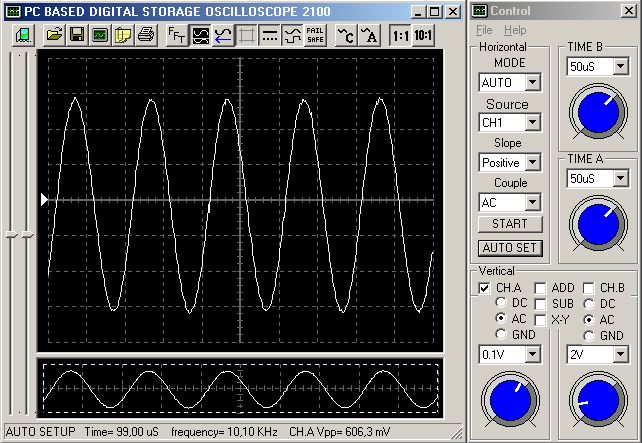

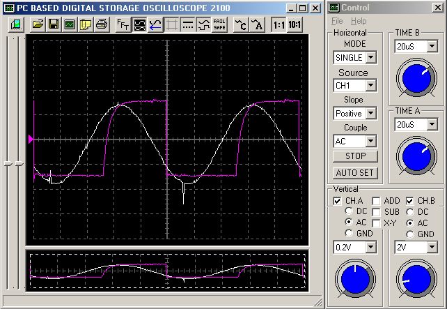

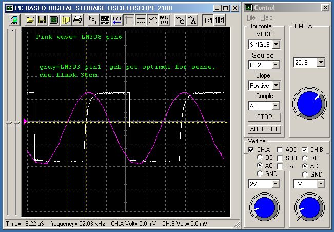

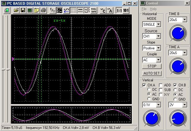

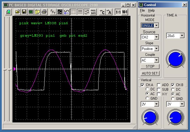

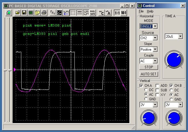

                    • Hi.
                      I using external PC scope: Type: DSO2100
                      I do not understand the problem.
                      This is the second coil.
                      The first coil inductance was good. But not worked well.
                      Discrimination was not working and poor sensitivity.
                      The pictures are all right? A good phase?
                      I change the TX capacitor. (I added 3.3 nF) Frequency 10.1 KHz now.
                      Sinus signals are nice. TX-RX phase delay cc. 20us.
                      Changed my RX capacitor. (27nF) TX-RX phase delay of 4us now.
                      Coil nil good, 0.03 mV AC. LM308 output of approx. 4V measured.
                      Take photos of the new measurement. I think not good for the RX-phase of the GEB.
                      Best Regards
                      Laszlo (from Hungary)

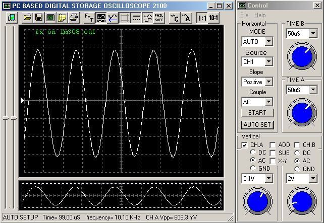

                      • On 6pin of LM308 must be 0,6-1V.
                        You must calibrate to this value 0,6-1V
                        Try on 0,8V.
                        • How to calibrate? Moving the coils, or other?
                          If the coil voltage of 0.03 mVolt, LM308 output 4Volt,
                          If the coil voltage 30mVolt, LM308 output from 6 to 6.5 Volt. and
                          a sinus signal is distorted.
                          If you reduce capacitor RX, TX-RX improved phase (19us-> 4us)
                          and also decreases the voltage output of the LM308. (Cc.2Volt)
                          I can not be better to reduce the voltage.
                          RX-GEB phase poor... 160degrees
                          Best Regards

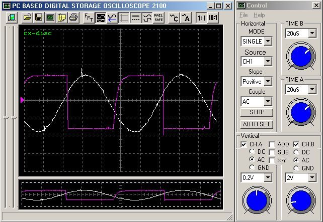

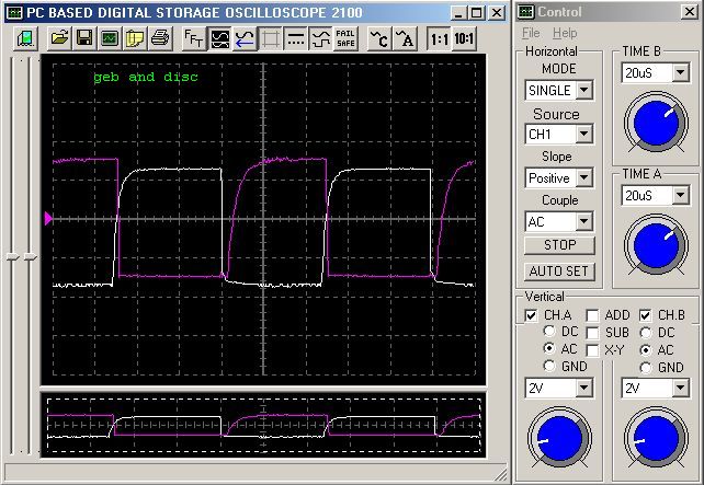

                          • Originally posted by sadowski25PL View Post
                            Try on 0,8V.

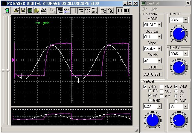

                            Could you send pictures to the correct measurement data?
                            (Oscillogramm)
                            TX-RX phase, phase RX-GEB and RX-Disc phase .
                            Thank You
                            Best Regards

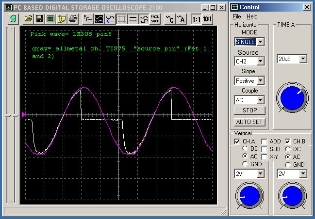

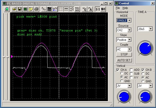

                              Try on 0,8V.
                              I mean ...! Could the nulling coil!
                              600mV output of the LM308.
                              Sensitivity: 25cm 1 euro. (all metall and autotune)
                              But the discrimination does not work. Only beep, beep ...
                              The coils are working well. Only the parts should be amended.
                              TX: 7.16 mH -> 47nF +3.3 nF= 10.1 KHz
                              RX: 8.2-mH> instead 33nF 27nF
                              Very, very difficult to adjust the coils ....
                              Look at the pictures, I can not find the error ...
