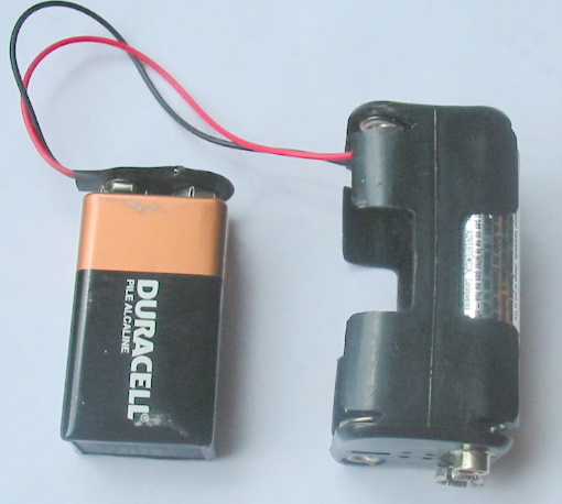

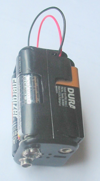

                    • Serpac makes a Mode A42 that is 2" longer. (5Wx7Lx1.6High), would this be approaching to un-weildly? Also this is a 12V battery. Would this battery pack be adaptable to fit this enclosure? See Attachment.
                      It is a modifyed 4x1.5V battery pack I built to work on Tesoro and Compass MD's. It is of course 12V in a 6v package.
                      Hey by the way I see you are in Tupalo. A fairly small city. Do you by any chance know Donna and Lee have the horse camp just outside of town?
                      Phil
                      • I don't believe your battery will fit in the battery compartment of that case. A 9V barely fits in the one that I have. With the battery connector, it is a very tight fit. I haven't been able to find cases with room for and 8 AA batteries. Not with a removable battery door anyway.

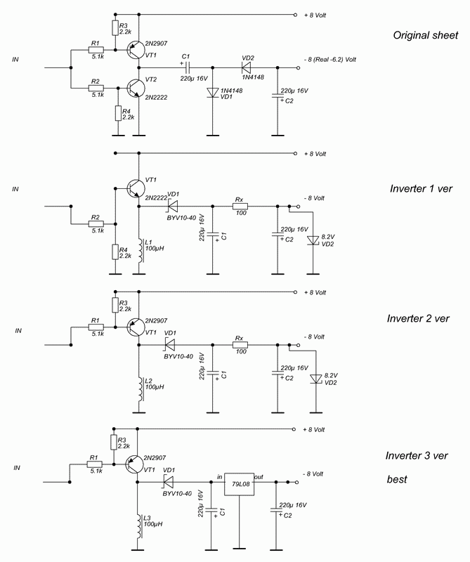

                          • Can you try this version ... I highly recommend ... Developed by Polish designer and successfully duplicated many times ... Only TGSL can with this version of paradise to compete, but only the 7809 Power ...
                            Best regards !
                            • Hi!
                              How to select best mod for negative voltage of original Eldorado sheet?
                              I like ver 3 !!
                              are you?

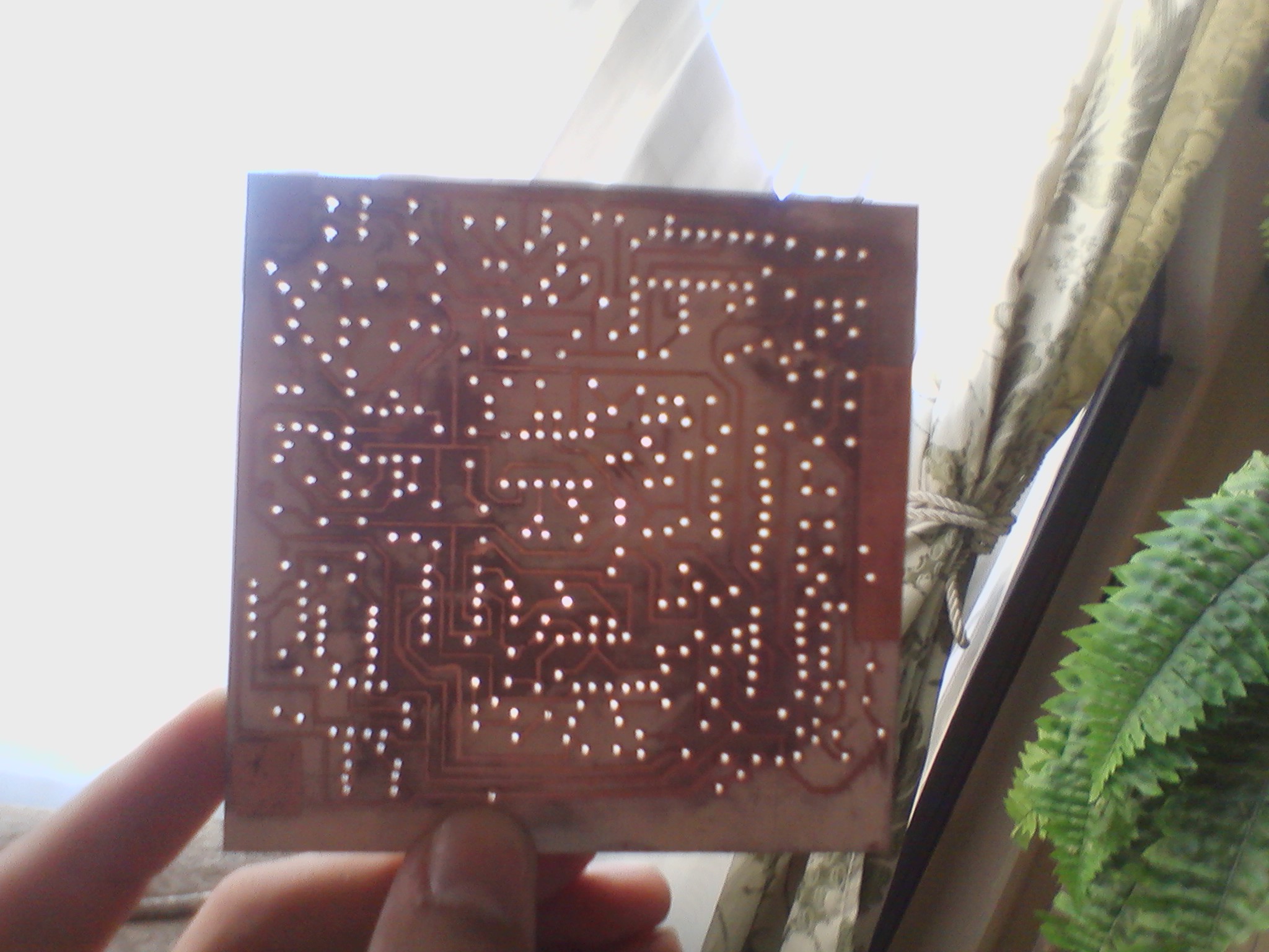

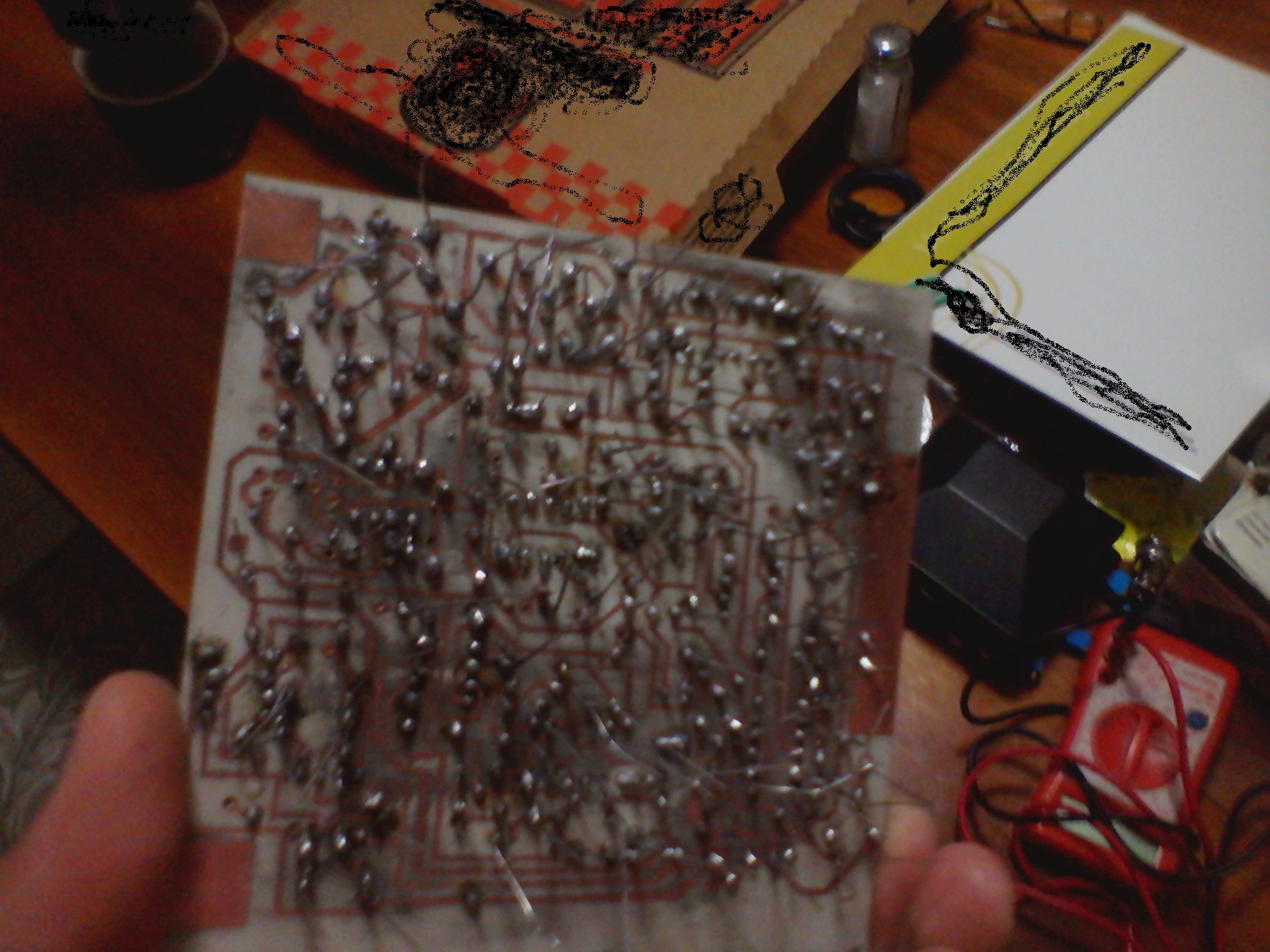

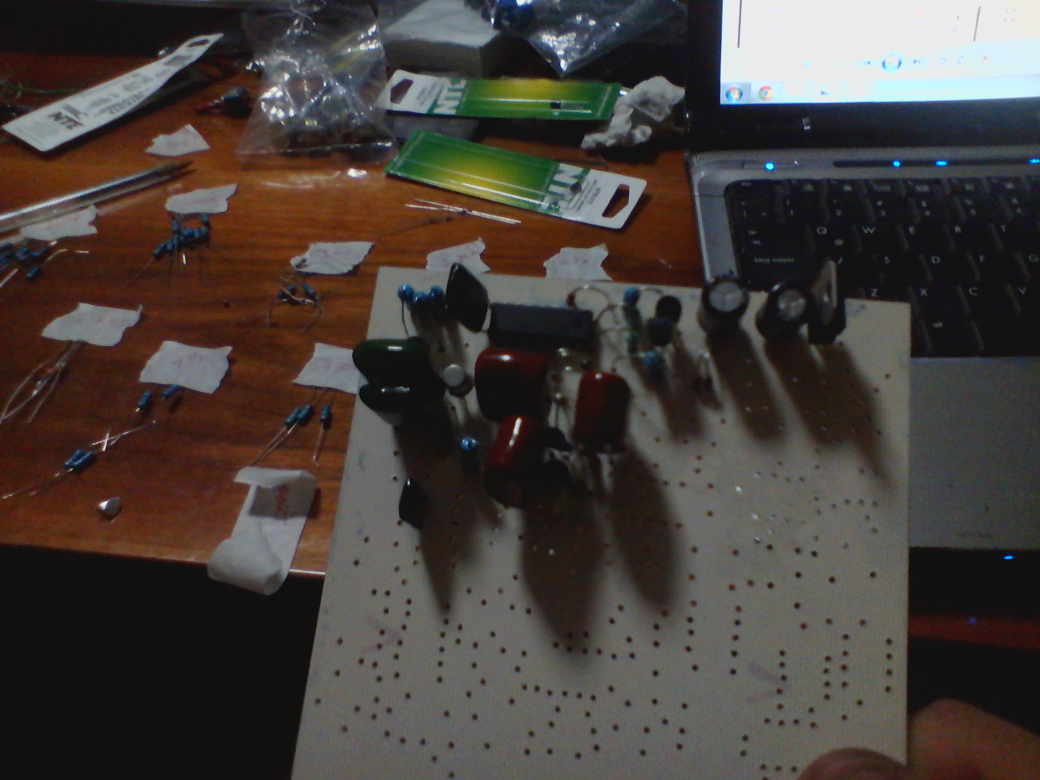

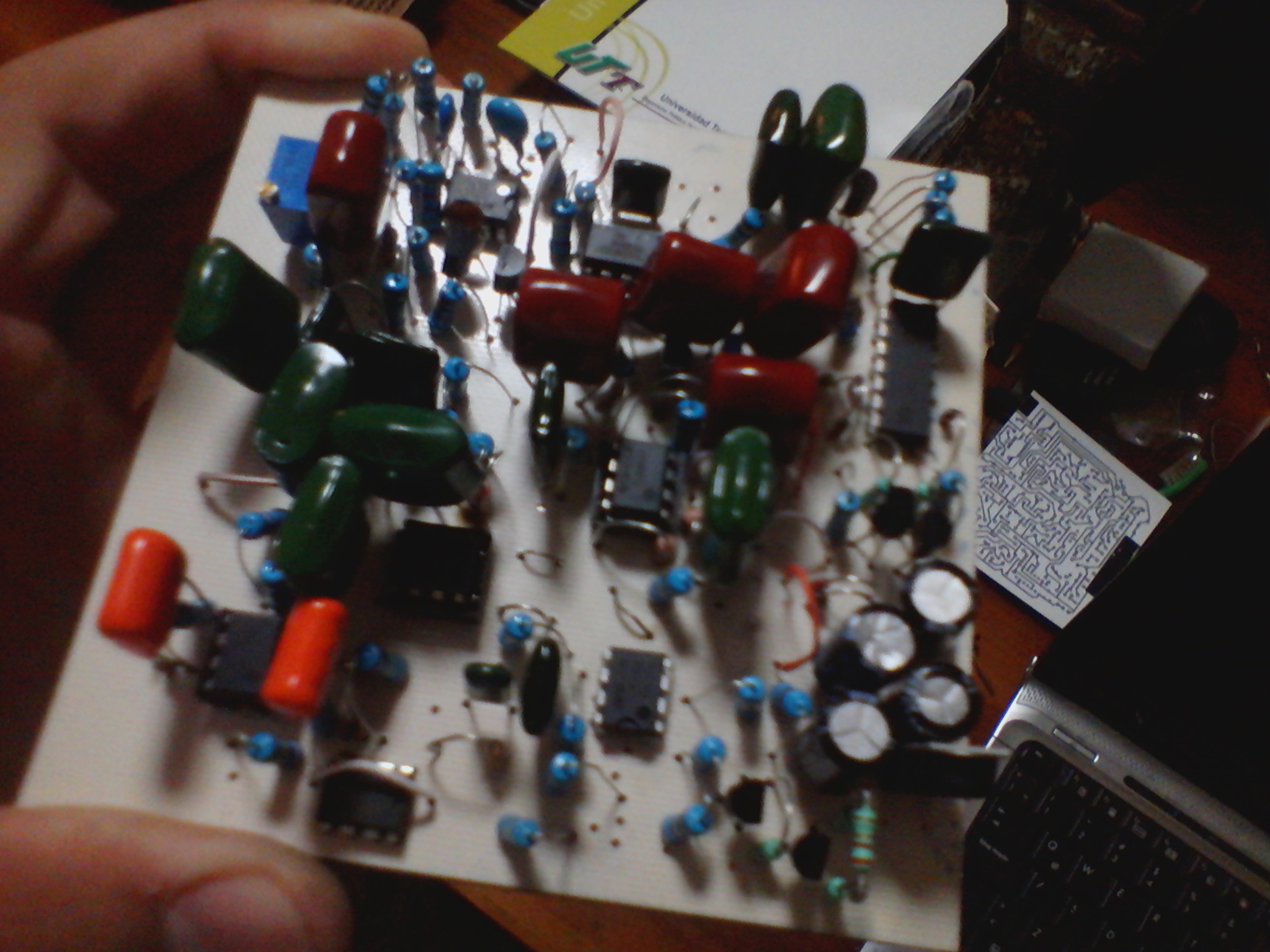

                              • Hi all, my English is not good but I try.
                                I started reading these forums and I decided on the gold
                                I went to the electronics store and buy the materials list, here where I live it's easy to find material but not cheap and the list grew ever
                                larger and obsession made ​​me build the circuit in one night and half a day ok
                                I had no problems with the board of Cu I did with big drill
                                I will post some pictures
                                The situation is that I have reviewed ivconic diagram and everything is done as it is, when the circuit energized tone is heard only very small,
                                just switch on the option of "normal" not heard "disc" not heard "all metal" .
                                I put a 8 ohm speaker believes someone is right?
                                I'm so excited, I will not stop posting here until it works., because I want it for my house prospecting
                                could someone please help me ..... thanks greetings
