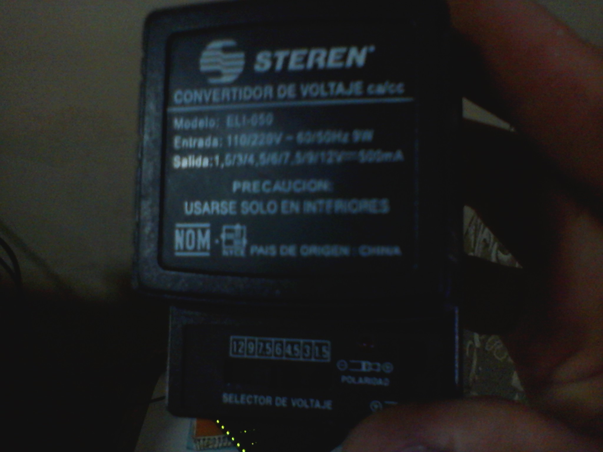

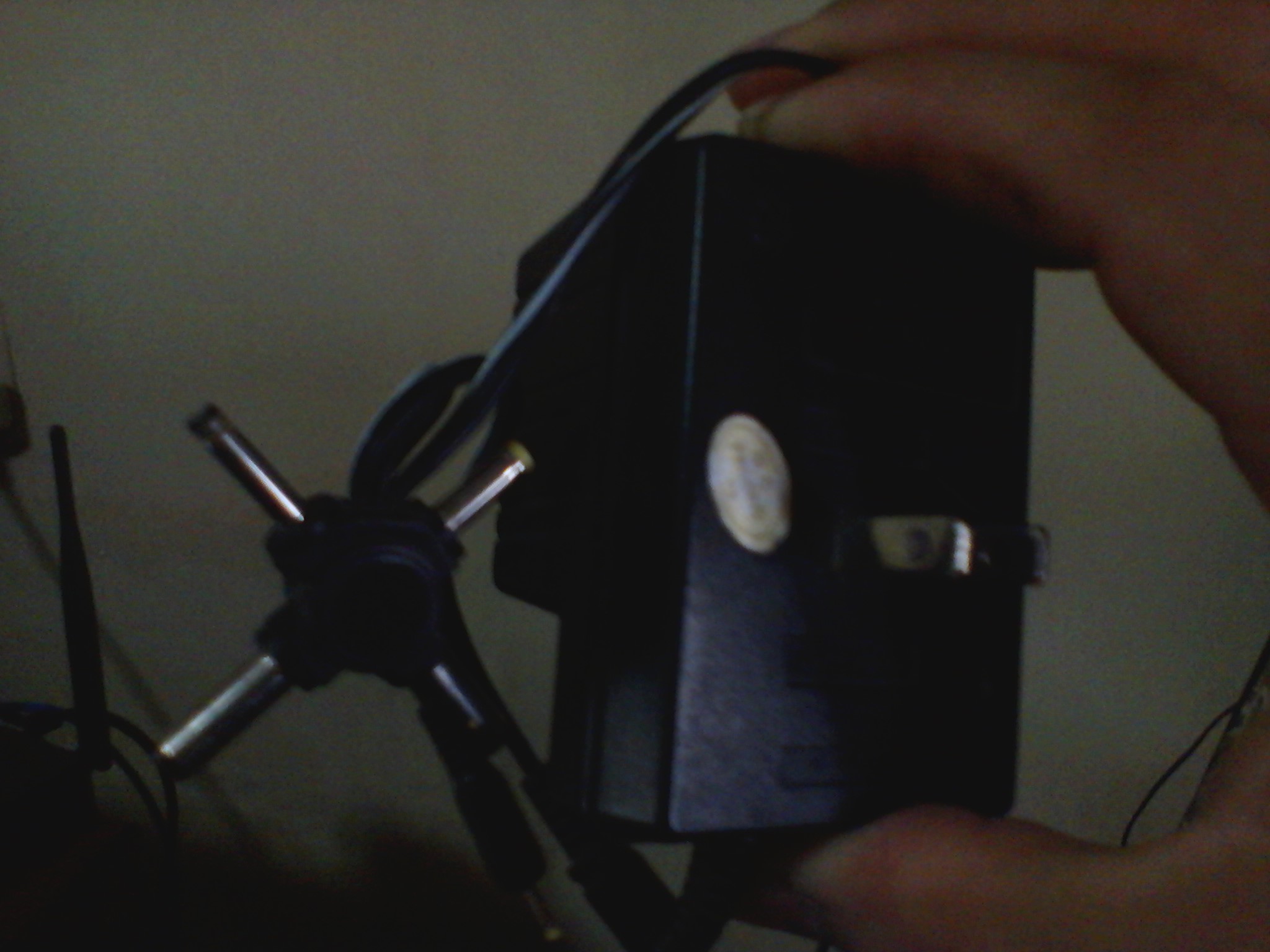

        • Hi ivconic, is the same pattern you gave us, if parts are correct and change TL082, TL062 and TL062 for LM308 BF245 - MPF102 what my error.
          The feed I use, perhaps the low corrienrte but already connected to 12 volts of car bateryClick image for larger version

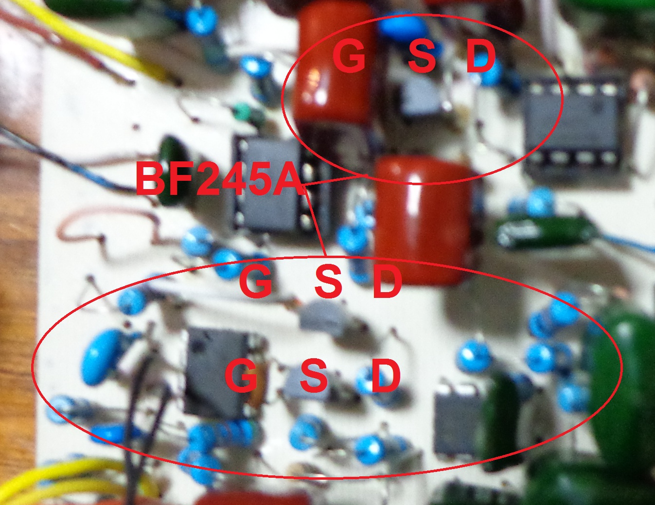

          • "...Hi ivconic, is the same pattern you gave us, if parts are correct and change TL082, TL062 and TL062 for LM308 BF245 - MPF102 what my error.
            The feed I use, perhaps the low corrienrte but already connected to 12 volts of car batery...
            Let's clear this up; TL082 and TL062 are DUAL (two in one package) opamps, while LM308 is ONE opamp in one package... HUGE DIFFERENCE!
            You can't replace TL062 with LM308!
            MPF102 and BF245 are having different pin assignments, as i recall quite oposite they are (DSG - GSD), so take care about their orientation on pcb.
            Wall power supply (from your photos) is very low profile, low filtered and suspiciously inaccurate voltage source for testing such sensitive device as metal detector.

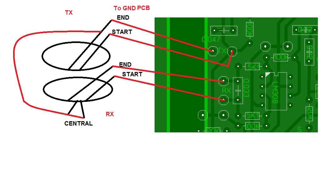

            And last; Eldorado will not work if coil is not properly connected to it. Without coil ti will remain silent.

              You guide me with the coil please. thanks
              I connect the coilClick image for larger version
              • It is always good to try initial tests with batteries. That also reduces a possibility of bad PSSR influencing your judgement on the device noise. Once you are convinced it works with batteries you can switch to something else. But honestly - you are going to use this rig on batteries anyway.

                  Yes that's alright.
                  What about MPF? Have you checked it's orientation on pcb?
                  • Hi, MPF102 out. BF245A of fairlchild install and put this:
