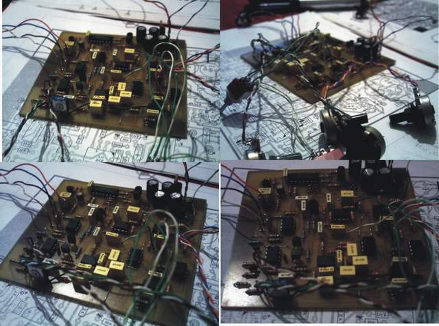

    Yes i finished it but havent tested yet...to much other things to do.. I guess tomorrow i will have preliminary results..

        Tested. Works very good. I havent made center tapped coil yet. Tested with TGSL 27cm coil. In Disc mode works out of range but in All Metal mode works excellent... better than expected! 1e coin at 28cm in air. Both modes; motion and non motion works excellent. I noticed much better "depths" in air in non motion mode!? With GEB pot adjust good GEB and than with treshold make just about to hear mum sound. Than it can detect coin over 40cm in air. Larger item like 1l paint can is detecting over 1meter in air! In non motion mode audio is very,very pleasant, joy to hear it. This one will definitelly replace TGSL for good. I am very satisfied.
        Now is time to make center tapped coil....

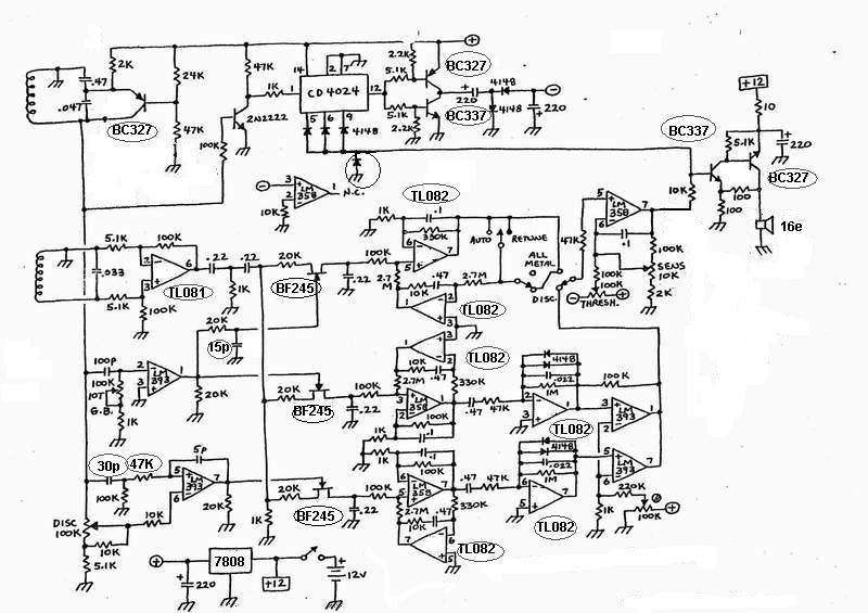

              Ivconic, would you please post a copy of the schematic that you are working from?
              I have an Eldorado scat that I have cleaned up and it looks pretty, but it sounds like you have made some changes to the circuit that wouldn't appear on my drawing.
              Thanks!
                Aint not major changes...just omited battery test and amplitude stabilizer in TX stage. Also i couldnt obtain LF442 and LM308 at the time, so TL082 used instead (just in testing purposes). BF245 are fets, also BC327&337 used there instead 2N2907&2N2222. I added another 1N4148 to further "furbish" those 3 transients from 4024....not a big deal, but i spoted minor improvements on scope...
                Also i found out 30p and 47K instead 100p and 10K to be right values on original Eldorado..that is all..

                  But can you give some additonal informations.
                  Like what is this retune buton for?
                  Also the disc,sens and tresh all have only one wire to PCB?
                  RETUNE and AUTO are the same, with difference that AUTO presents locked retuning (switch) and RETUNE is only one shot push button.
                  Ha,ha,ha...of course not. There are 3 x pins on pcb for disc,sens and tresh. I just pointed their places with single line, of course you must use 3 wires
                  GEB multiturn pot need 2 wires...
                          That, is major! Thanks, dude!!

                              Is this scheme right?(sign place)
                              Is it BC337 or 2N2222?(maybe omited) and did you make tapped coil?
