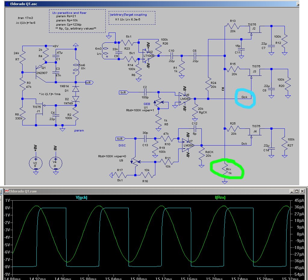

                            Eldorado spice QT
                            Here is a LTspice simulation that makes it easy to predict phase changes that would occur with various component changes. With the old Eldorado schematic (with wrong component values in the GCX phase reference circuit), I could not relate my Eldorado simulation results to what I knew, or thought I knew about Tesoro IB detectors. However, when Ivconic illustrated some corrections in component values, things started looking good.
                            It is my understanding that the received signal should have approximately +90 deg phase shift to the GCX reference - when the GCX control is at 100% clockwise (CW). (But maybe I have that backwards?) The arrows in my pot symbols point to 100% CW. If they're wrong, then simply turn them around.
                            The target coupling coefficient (K1) is what closes the loop between the TX and RX coils. I have arbitrarily chosen .000063. Changing that number should not affect receiver phase but it will affect RX amplitude.
                            As always, I have tried to remember to include all of the support files necessary to run this simulation "right out of the box", but I can't think of everything. If there's something I left out, or if something doesn't work, let me know and I will try to correct it
