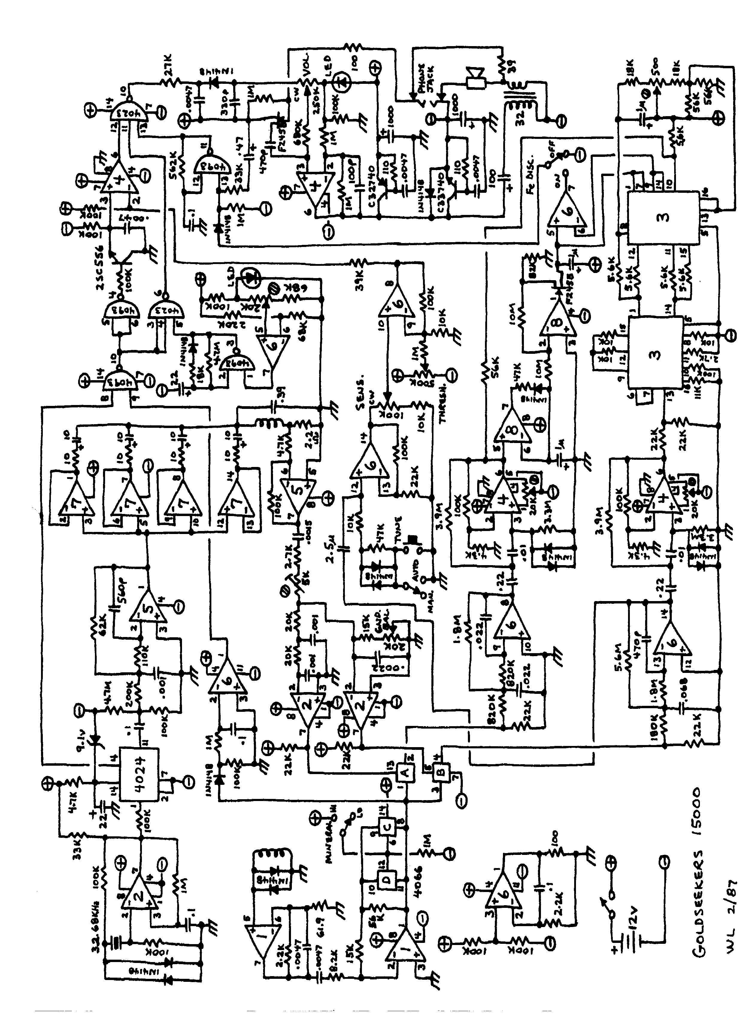

    Well... i would pay some attention and spare time to 2 obsolete designs; Minelab GS15000 and FT16000...IF only we had accurate schematics...pitty we don't.
    There is some schematic of GS15000 but not explained well. There are 2 unknown ic's...those bugs me a lot.
    Also FT16000... is it simillar to GS15000 ? Any schematic?
    Or maybe somebody can tell more details on those 2 unknown ic's?

    Max..reffering RH; i was thinking to start drawing quite new, my own, pcb for it. It is winter...nothing else to do..
    So i would like to hear from you once again your opinion on last posted RH schematic; do you have any more doubts or it suppose to be final and most accurate so far?

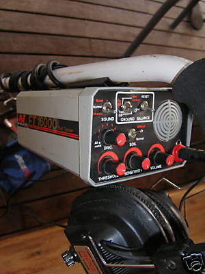

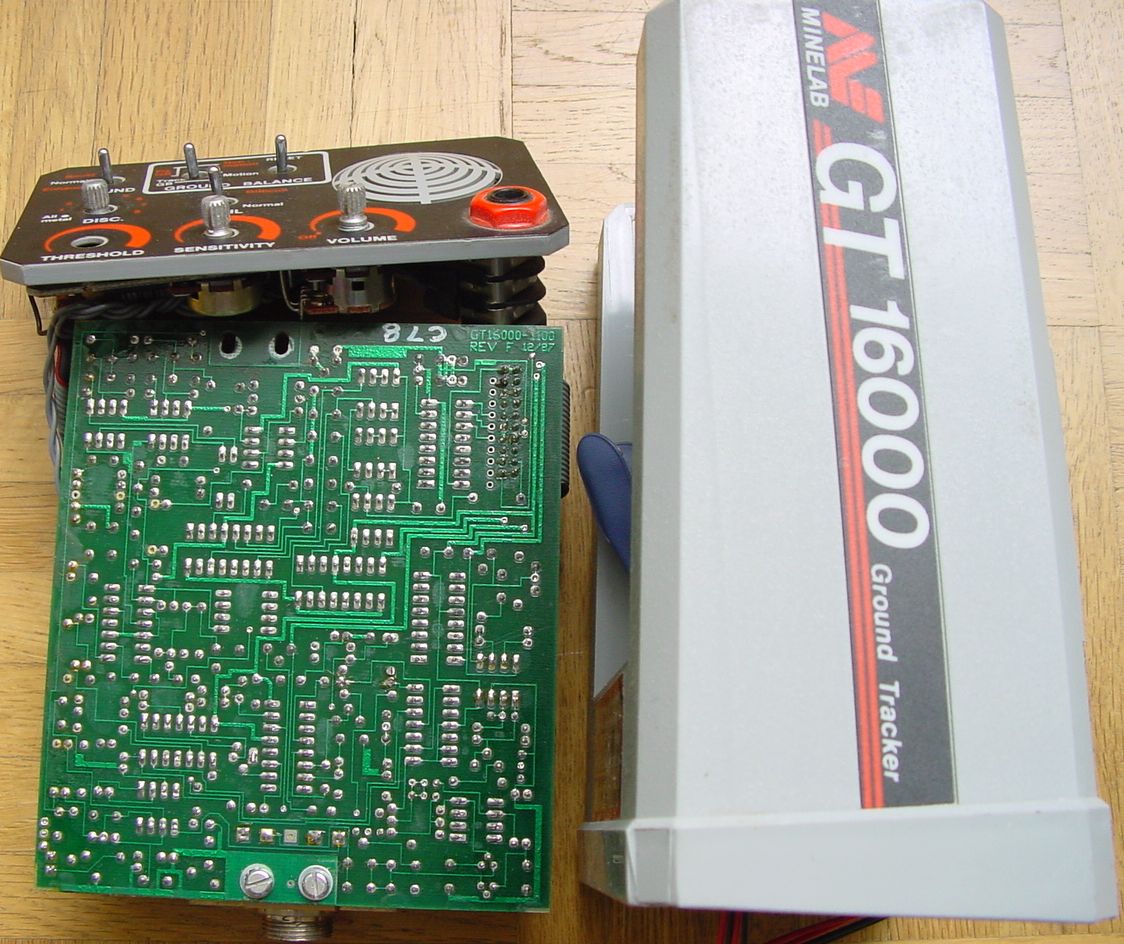

        Aside RH for now...what is the story about FT16000 (17000,18000)....any informations, any details.....any schematics!?
        I would be more happy to make FT than RH, to tell you the truth. Much more straightforward design.
        • #94

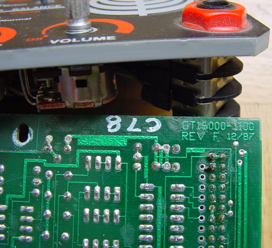

          Hi Ivconic ,do you mean GT16000.Grt Nakky.
          • #95
            No. Not GT. I mean FT (Fast tracker).
            Those indeed looks almost the same!? Any differences? Must be some?

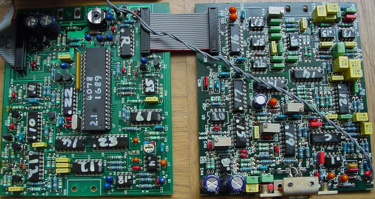

            I see some big IC there!? Sheeeshhh! Not some uPC!!! Huh! We can not do it if there is uPc in it!
            P.S.
            Look that "mother" machine inside!!! Wow! Looks much more serious than RH, isnt it?
            I said "straightforward" in last post!!! Ha,ha,ha! Straigh.... my as. !!! What i saw recently..seems i saw only right pcb (from your photo), not the left one with it!!! Ha,ha,ha!!!!
            Simple question; how can i get one of those?

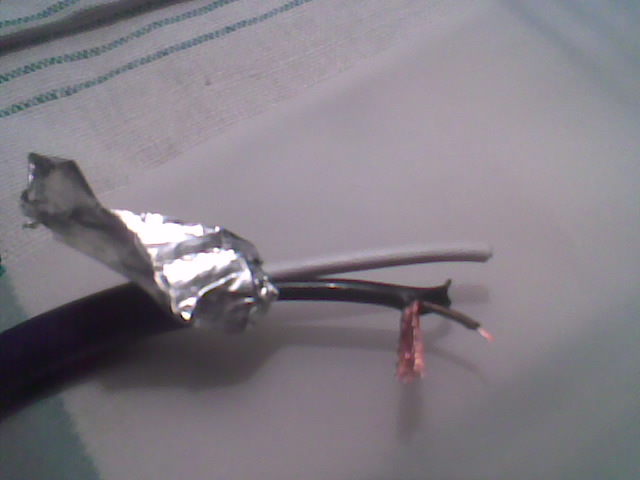

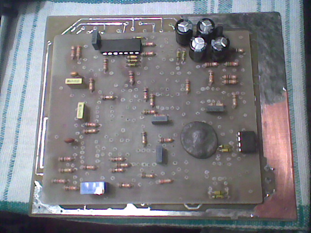

                  I dont waned to post this before tested.But now I have a chance.
                  And this is the only cable that is similar to yours.Do you think that this will do the job?The comon shield is only Al foil!
                  Also now PCB is nice almost twice smaller that original.Do you like it?It suits well in simple cheep box.But I suspect that there might be some problemes.I will try to finish this tonight and test.

                        • Originally posted by Ultimate_Haze View Post
                          Upsssss forget to upload
                          Cable is good for RH (maybe...looks like) , but not good for TGSL and Eldorado.
                          PCB...hmmmm... if you tend to make as smallest as possible than it can be made much smaller. My idea is not to make it small but to fit standard plastic enclosures i had at the time and hopefully i will obtain again in future, enclosures like on Fisher 1265 (sheesh! how many times i must repeat this!!?).
                          Aside size of pcb, more important thing is S/N ratio on it. How is drawn, how signal flows etc.etc. many questions. It is not just to draw any pcb and anyhow.
                          So...i dont know what to say or how to react on your question or what ever was, reffering posted photo? It was question? Or it was just note.?
                          Anyhow...cheers!
