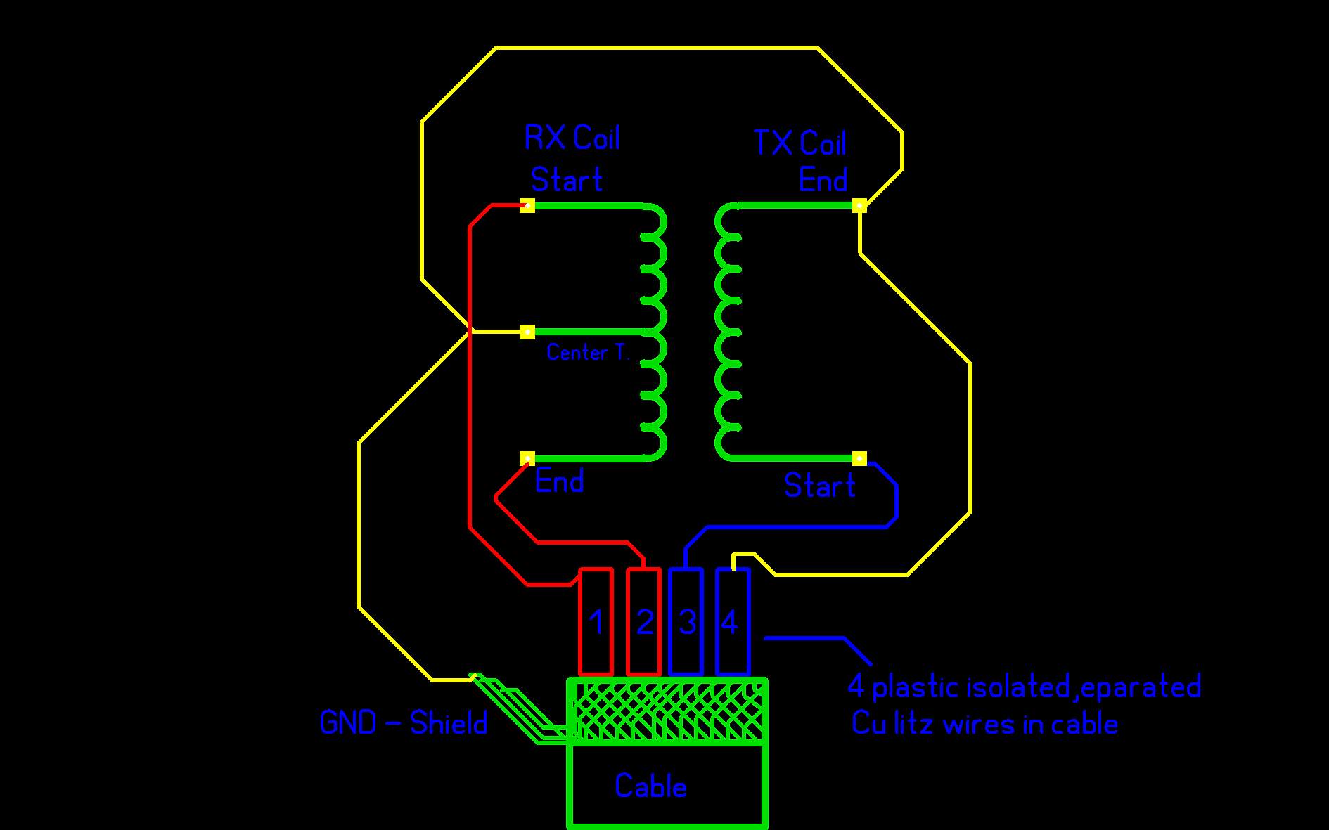

          • I have made centretaped coil and have worked alot lately.
            So when conect right coil everything went on its place.Now PP and Disc are ok.But cant null the coil so I can have a good performance for coin sized objects.Hum.I will make another coil.But this were prety good.And I have payed alot of atention when wind.The sound is diferent too.Even sweeter.You can hear something like bell on good targets.Maybe my wire is diferent and thats why I can match the inductance or something.But the test coil were so deep!
            • Can someone show coil wirements?
              When centretap conected to gnd in coil loose all performance.
                • Only center tap i grounded? or
                  On schematic lead to 2nd pin on Lm308 is grounded
                  • It is wrong. Does not make much sense to connect it to gnd if already exist center tap, also already connected to gnd? Right?
                    Besides; you may try and see what happens. Disc&Geb circuitry will work out of range - bad.
                    Look again my pcb, you will see no connection there...
                    • Thank you very much!!!
                      Now it make sense.

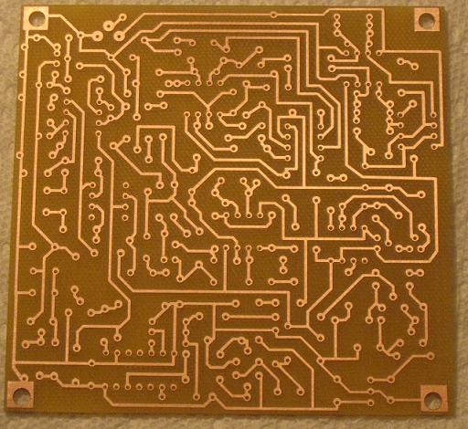

                      • New Project!
                        This looks like good next project after long winter nap. Had friend make pcb on LPKF router machine, Hell of machine!!! 377 holes in 7 minutes!!! Board is slightly tweaked version of Ivconic pcb posted here (Thanks Ivconic), no changes except for outside dimensions, little smaller and square suits me better!

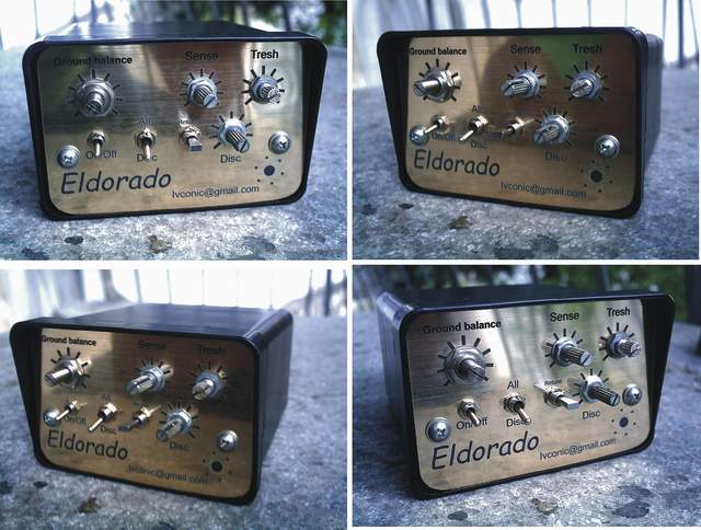

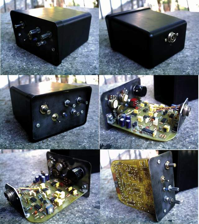

                            • Here is the third one, few steps before finished. I also had to cut rear edges a bit to fit enclosure. Not a big deal. Speaking of enclosure; i have to thank to our fellow member here, from Bulgaria, who provided me with 3 enclosures like this one on photo. Cheers!
                              • Last step; pot caps to be mounted. The End!
