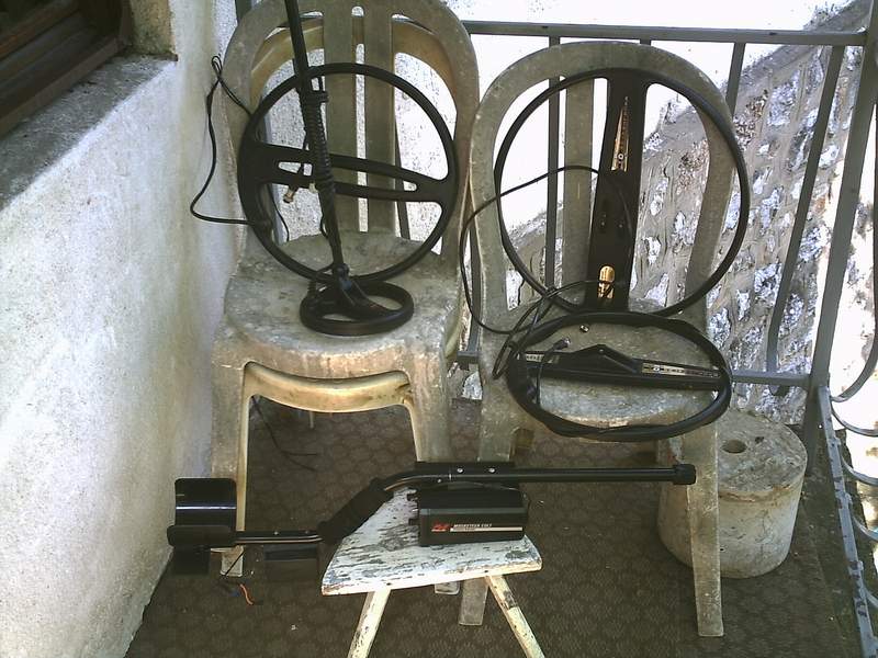

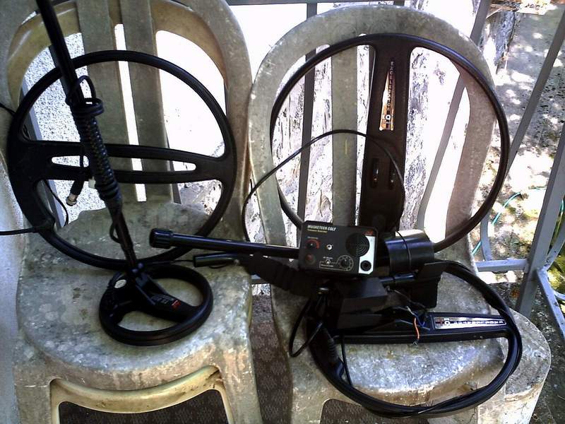

    Once again i got Minelab Musketeer Colt. Previous one i sold (how stupid was i ???) few years ago. After that stupid move i realised what mistake i done. It was to late. Now i got second chance. Am so happy!

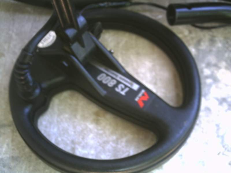

    But this time i also got more coils for it; 36cm, 39cm and 45cm ..Excellerator....and 18cm (TS800) which came with machine...what to say?
    These are photos...

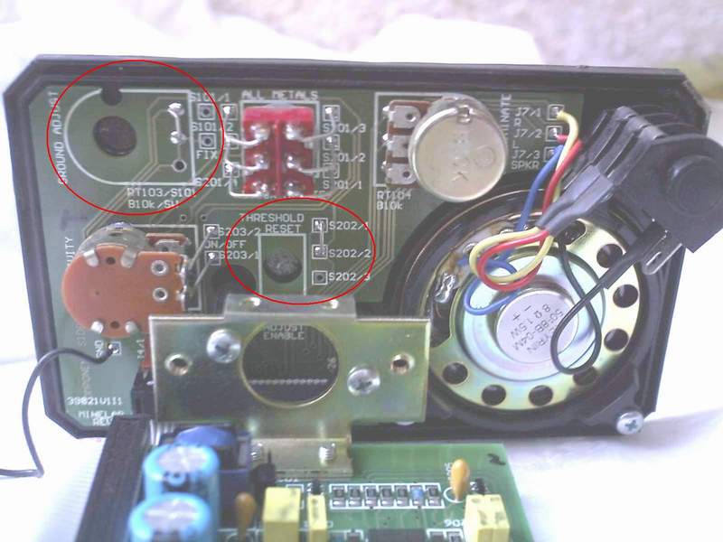

    But...curious as i am ...i couldn't resist to open it and add more controls on front panel.
    Musketeer Colt, XS and Advantage are actually same machine. Same pcb, same controls...same coils...same everything.
    Guys from Minelab probably made strategic marketing move and predicted newer models (only guessing) so they left everything inside same and changed only outlook of models. What was the reason? I really don't know.

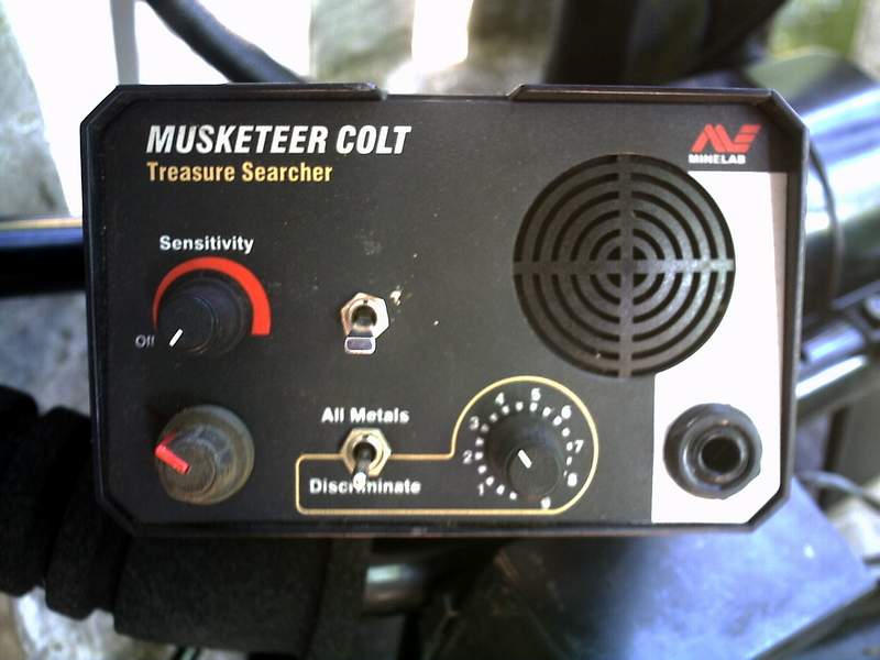

    It is shame to have Colt model and not to have all the controls available. So i did it. I had no problems to drill holes and mount potentiometer for manual Ground balance and switch for changing modes. Of course i had to remove 2 wire jumpers from pcb at front panel.
    What new i got with those presets? Wow!
    First of all i got few inches more on depths. Manually adjusting GEB offers operater to adapt machine to current ground conditions , so on most of soils later i got more depth! Proved already with many nice finds so far.
    Second...i got splendid pinpoint mode! But SPLENDID!
    And as experienced prospector i got complete control over machine..so now is easy to put it on endest limits of performances and have excellent results on the fields.

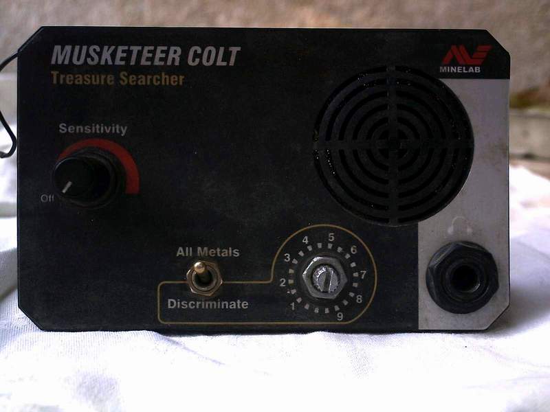

    So...these are photos of how it looked before and now.
      Before.....
        Now...
          Inside...before applying changes...
            Let's focus on manuall GEB for now. My usuall "parameter" when nulling coils for TGSL is moment when ferrite rod is rejected. Usually i turn GEB trimmer on TGSL to position when ferrite rod (swinging on 5cm over coil surface) is almost completelly rejected. Ok...i leave it at position where rod still can produce ocassionall mum "cracks". So...adjusted like that TGSL later acts excellent on real soil.
            With same logic i made approach to Minelab Musketeer Colt. I "upgraded" it with mode switch and manual GEB potentiometer.
            So...just for testing and comparing i took same ferrite rod and by swinging it on 5cm over coil surface i adjusted GEB potentiometer to position where ferrite was totally rejected. Not even a mum "crack". Wow!! Situation was much more different than before, when there was not potentiometer but only wire jumper on the front panel pcb!!!!
            Potentiometer is than on position "4" clockwise!!! Huge difference!
            So...conclusion is that Colt was really "choked" previously...."choked" too much! To much for my taste!
            It obviously rejected many of good items in the ground! Prooven already on real soil! I founded several extra small and tiny silver coins at places where was no any detection before applying these changes!!
            GEB preset is CRUCIAL! Good detector MUST have GEB preset available to operaters hands! Must!
