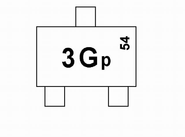

          Fred....say "CHEESE" !
          Dont ask me how i know this!

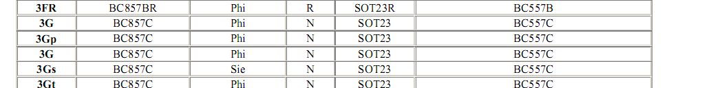

          It should be BC857c....but small "p" is confusing me. Also that "54" number?? What the heck this stands for?

              Hi Ivconic
              Great! a secret revealed !
              I confirm this must be a BC857, very common one...

              Thanks!
              Fred.

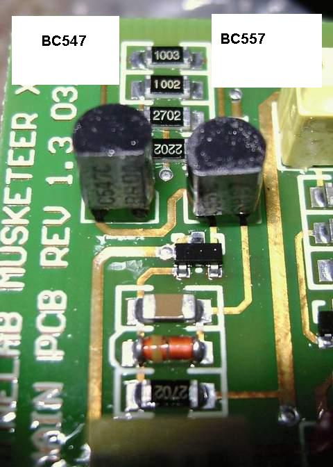

                          I also searched through several cross references....hmmm... According to what i saw; BC557c should be pretty good replacement???
                          But we already have one BC557c there on ocb?????
                          So....why oh why they put one conventional BC557c there and than put also BC857c ????? Why they dont used also BC557c if it can successfully replace BC857c????
                          Can anybody explain this? I do not understand this at all!
                          Maybe 3Gp (54) is not just ordinary BC857c....maybe have some speacial features?

                            The BC857 is an SMD with a total power dissipation (Ptot) of 200mW, whereas the BC557 (TO-92F) has a Ptot of 500mW.
                            It looks like the designer was trying to use SMD components wherever possible, but a higher power device was required in this instance.
                              Very good point! That really could be right answer! Actually 3g is last in TX "chain" and i guess it was desirable to reduce power disipation as much as possible. Seems pretty logical.
                              So... what we gonna loose on performances if BC557c is used...in our handmades? I guess not much....yet!?

                                In a handmade clone I would think that the BC557 is a perfect replacement for the BC857, if you don't want to use SMDs.
