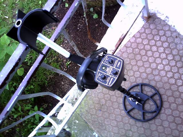

    Just got brand new Fisher 1280x Aquanaut with 10.5" spider coil. It is very good detector.I like it.
    But...what i dont like are earphones tied up to machine without possibillity to disconnect them. Coil also. Whole setup is pretty awkward to be easilly packed in a bag or knapsack and transport.
    So... i am planing to add coil and ear sockets/connectors (obviously i will not dive with it ). Would like to have clear schematic of it, just in any case. Also i am considering speaker upgrade. There is some pretty blur schematic on this forum...blur and uselles. Anybody have better schematic? Please do post it here (original schematic not some unchecked redraws). Many thanks in advance!

      I am satisfied. Yet not very sensitive, especially not on smallest coins.
      Discrimination is good. I like it. Typical for old analogue Fishers. Not hard disc, but (thanks to specific audio) experienced operater can always be sure on type of metal detected.
      Depths.... yesterday i went outdoor and located 2cm coin at 19cm depth. Not bad at all. But next coin..diamm. 6mm at 7cm depth was detected bairly with mum and short sound.
      Ergonomics.....horror for inland prospecting! Personally, i am not using earphones. Or using those very rare. Also i am used to pack my detectors short in knapsack. 1280 is horror for me to transport and carry!
      Shaft.....straight - not good. Also it bends a bit while swinging. So.....plenty remarks i have.
      But....let's not forget that this was made for diving. So....for diving it is excellent. All my remarks does not make sence if 1280 was used in diving.
      My remarks make sence only if 1280 is about to be used on places i am ususally visiting. Woods, mountains, fields...

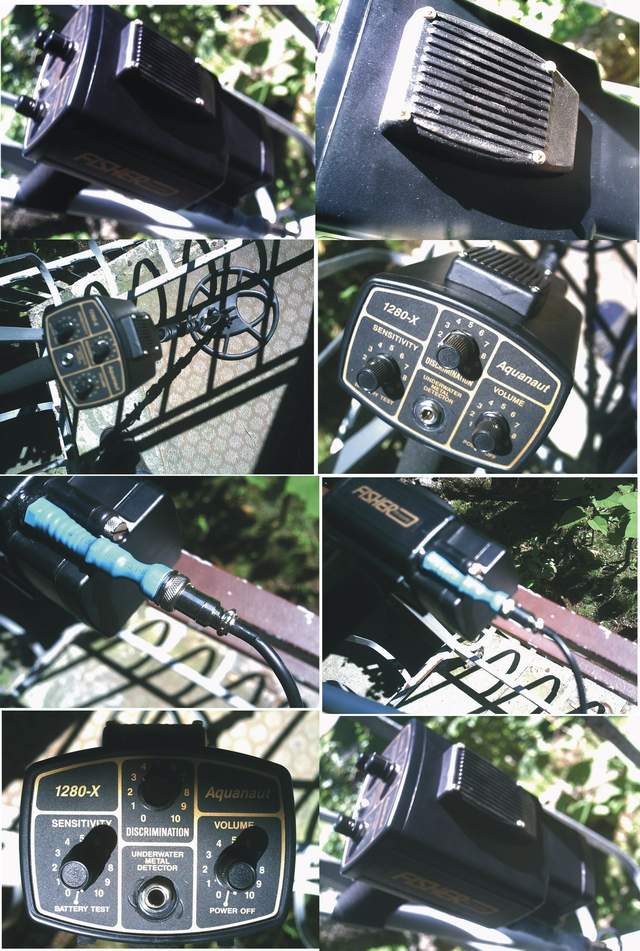

      So... that's why i decided to make some modifications on it and adapt it for my sort of prospecting. First...to separate coil and earphone cables from detector....to embed connectors. Second ...to kill that annoying led diode on front panel (could be perfidious in dark nights on dangerous places!). And last one ...to replace that upper plastic shaft with Al pipe with bend simillar to one on 1265/66.

            All the minor modifications DONE !!!
            Now...1280 is more "human" for inland prospecting.
            Speaker is 8ohms. Earphone jack with switch (spkr./ears) embeded.....coil connector also included...
              Excellent solution.
              Is air test with a coin satisfactory?
                Excellent idea, the microphone case for the speaker!
                  Good work Ivconic.
                  Tell me why did you place the coil conector so far from the case?.
                  May be there is not to much space at the bottom of it.

                    Very good. 1e coin (usuall testing) at 28cm in air. Excellent audio! Almost the same as on 1265/66. Also pretty simillar response on targets (simillar to 1265/66). Disc is not "hard" as on TGSL but very soft and; ..Disc at "10" on 1280 gives same discrimination as Disc at "5" on TGSL. Yet, audio at 1280 is much better and keeps more "informations". Depths;....1280 is much deeper than TGSL, BUT only on larger items. On coins it has better audio response but also is shallower than TGSL and Colt. With 10.5 coil and so clear and good audio response, 1280 is perfectly suitable for wide swings and faster covering larger areas. 1280 certainly deserves it's place in my "arsenal".

                      I had some labour on it, to make proper curvature and to fit exactly top curved surface of 1280 enclosure.

                        Yes..that was the most difficult part. I couldn't managed to find proper spot on enclosure to drill hole for connector. At the end i decided to use old coil cable hole and piece of cable. It is very good now. Elastic. Also no new holes on enclosure. Very good protected too, with plastic coat (muster when heated with lighter). Even if rains, connector and connections will be good preserved from moisture.
                        1280 coil has 4 wires; 2 hot and 2 shields (separated).
