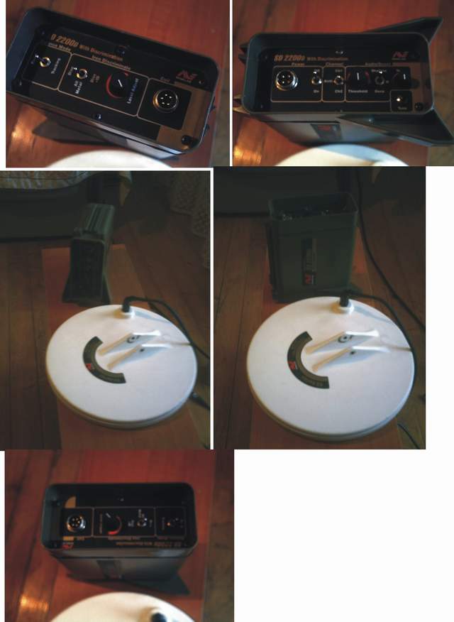

    A man send me brand new SD2200. Looks like never used. Switching ON with coil connected, machine is producing pretty constant wobbling audio. Nothing else. Only Tone adjustment reacts, no other else. Without coil connected when switched ON it starts to act like everything normal. Treshold and Tone adjustments reacts and makes difference in audio so as Tune button when pressed (only first time after switch ON).
    There are two brand new coils and machine acts the same with both coils. Battery is brand new and charged to 6.5V. Drain is small...when machine switched ON voltage on battery changes from 6.5V to 6.4V....
    All connectors checked from eventual breaks or shorts - good condition (brand new).
    Coil measured and seems there are 2 coils inside; 0.4 ohms and 16 ohms.
    I just recorded 3 MP3 files using microphone closed to earphones. 3 cases; first one is audio when coil connected on machine. Second MP3 file is when coil connected and Tone pot turned and third one is audio when coil is not connected....

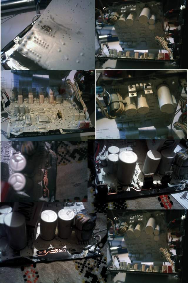

    As already known; both pcbs are painted with some white paint....tough to follow traces and see all the components clear.
    I want to check if there is some trivial problem and later to fix it or...if problem is more serious than i will send it back to owner and suggest him to send machine to some official service abroad (pretty painful solution for us here...). That's why i would like to void paint removing from pcbs...at least for now..

                  I still can not find fault! I tried many things. I did like Woody suggested. It was not a problem; suggested fet 2SK216 is ok, so as nearby VPN (ZVP). Also checked TX outputs 2 x IRF640 ....good also!
                  I had half day hard labor to remove damn paint from some areas on pcb. If it was not painted i think it would be much easier to locate fault! The way it is now...i am thinking to give up! Maybe component placement would help a bit, because i can not find which component is where!! Can not trace also because traces are painted too!
                  I am wandering; what the hell Minelab wanted to achieve with this paint!? Protection? From what? From servicing? The way it is now...with my recent experience (all day torture with it) i am sure i will advertise those machine in pretty NEGATIVE context from now on! I will spread the news among prospectors - NOT TO WASTE MONEY ON SUCH PAINTED TRASH, simply because it is not easy to service it later, when some eventual fault occurs!

                              Problem(s) finally solved! Pretty "uncommon" fault!
                              Cable from machine to battery was very bad,most probably already changed, because it is not original. And inside cable there are 4 coated litz wires...but very thin!?!? So...plus pole litz somehow broke and one litz probably touched earphone output (deja vu! same thing i had in the past with RH!!! )!!!
