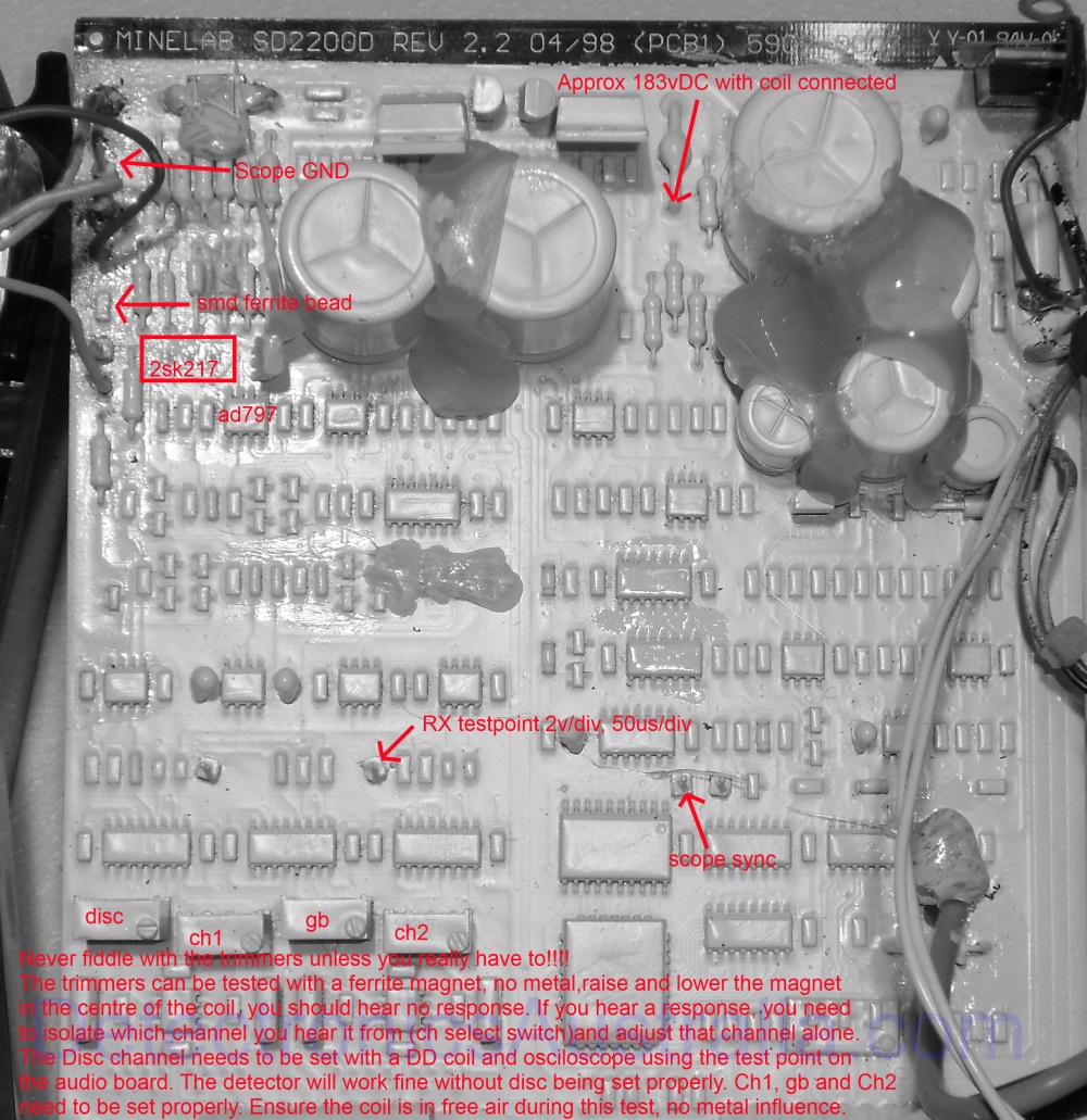

), with all metal removed. Raise and lower the magnet in the centre of the coil, you should hear no response.
