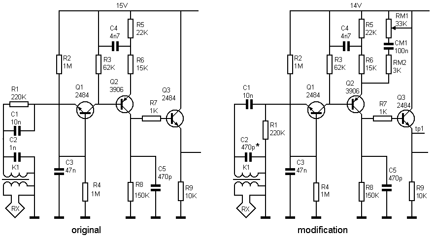

          RF amplifier
          Ian, start with this:
            Operating point
            Ian, the circuit diagram noted as "original" RF amp is for model ADS III.
            There must be some benefit from that, instead of one resistor 470K, using two resistors R2 and R4 with resistance 1M.

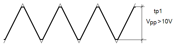

            You should adjust operating point with triangle signal. Connect a scope to tp1 and see how Q3 cuts the peaks. Adjust R3 to cut eqal peaks as shown.

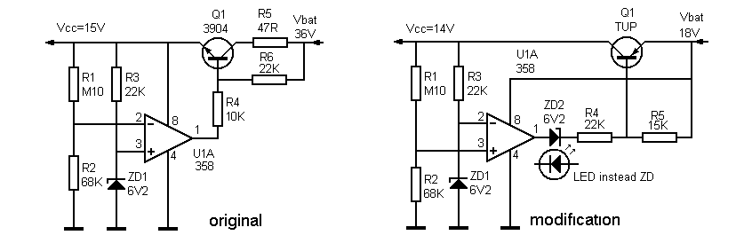

                Low-drop regulator
                Voltage stabilizer
                This is the modification of supply voltage stabilizer to act as low-drop regulator. The stabilized voltage is reduced to 14V with a view to using only 2 batteries x9V instead of 4 batteries. Both batteries can be discharged to voltage = 14V + Vcesat (approximately 14.4V). The voltage of diode ZD2 is not important to the operation. You can use a LED connected as shown, but it requires other values of R4 and R5.

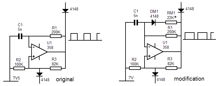

                    Tongenerator
                    Duty Cycle of Tongenerator
                    Audio in Garrett ADS gives too much loudness (volume) even when used with exhausted to 5V batteries. This modification aims to reduce the loudness without compromising energy efficiency. As shown, be amended duty cycle of tongenerator. The value of RM1 should be adjusted powering audio section with 5V (very exhausted 9V battery). After modification of voltage stabilizer to act as low-drop regulator, machine can work with 2 batteries in series to power the radio section and 2 batteries connected in parallel to power the audio section. When the batteries from the radio section are exhausted to 7V each, they are moved to supply the audio section, where they are exhausted to 5V.

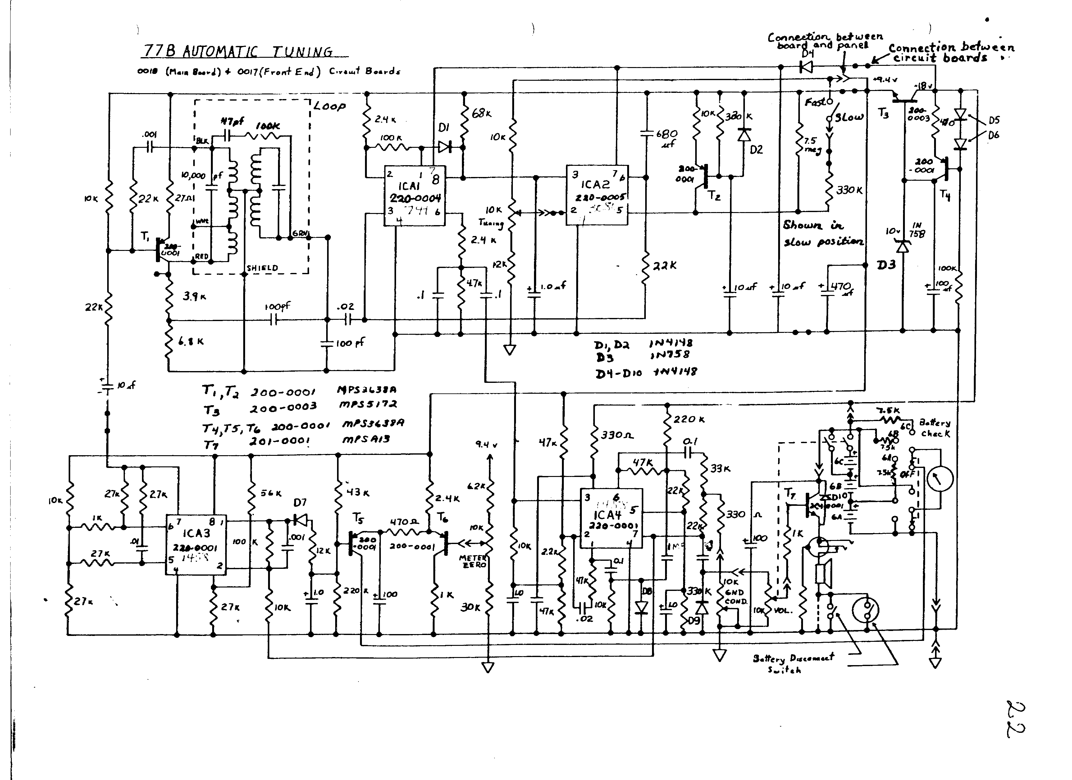

                        I have a Teknetics Mark1, Bounty Hunter Big Bud Pro SE detector, Compass X100, Compass Coin Magnum II, Compass 77b, Compass 71b, AH Pro model Pro-2, Compass Judge I, and Compass 94b.
                        Unfortunately I do not have any schematics for any of these units.
                        I would like to enhance any of these to work better, if possible. Thanks...
                          Originally posted by Melbeta View Post
                          Mike,
                          Hi.
                          Take the schematic of Compass 77B
