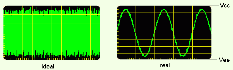

      So the gain of the RF amplifier is not limited by the level of TN, but the level of AIR and GND signals. In an ideal metal detector, the AIR and GND signals are zero, the gain is so large that the output of RF amp is near rail-to-rail noise as shown in left of attached figure. That means maximal high gain of RF amplifier without saturation in output.
      A metal detector with sine induction is generally narrow band device. Required bandwidth is less than 12Hz! If done so narrow band RF amp, it will be quite weak in the input noise. For example if RX coil and RF amp generate TN=1nV/sqrtHz, then the noise voltage is 12nV. If the AIR and GND signals are zero, the output signal of RF amp without target and with deep buried target should be for example 6V noise if Vcc=5V and Vee=-5V. Then the possible gain of RF amp is

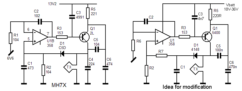

        Idea for modification of TX

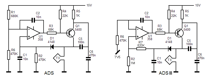

        How TX of ADS works
        The circuitry "dismodulates" TX coil voltage instead TX coil current. It does a good job because in tank circuit, the capacitance voltage almost completely transforms in coil current.
        The opamp U1 acts as P-I (proportional-integral) controller. However for minimal settling time should be connected as P-I-D (proportional-integral-derivative) controller.
        Integration timeconstant is (R1 || R6) x C2 = 278K x 10e-9 = 2,8 ms.
        Voltage divider R1-R6 sets reference voltage Vref for P-I control. Due Vf of D1, the stabilized amplitude is Vst = Vref +0,6 V. It can be increased until Q1 start to enter in saturation region and tank start to return energy to supply rails. This can be observed with an oscilloscope connected across R5.
        Voltage divider R3-R4 increases settling time because reduces gain of feedback loop.
        Resistance of resistor R5 reduces efficiency.
        TX circuit of ADSIII
        Integration timeconstant is increased to 4,7 ms.
        Reference voltage is fixed at 7,5 V. The stabilized amplitude is adjusted with voltage divider R2-R7.
        TX circuit of MH7X
        Integration timeconstant is reduced to 0,1 ms (if value of C2 is shown correct).
        Resistance of R5 is reduced 5 times because it is connected partially to tank circuit. This is accomplished through the connection of capacitor C4, which increases the tank capacitance 3 times; only 1 / 3 of tank current flows trough C5.

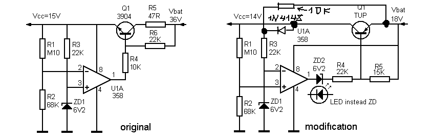

        The circuit for experiment is shown right below. It is powered by unstable battery voltage because it does not affect the operation of the P-I controller. Amplitude can be stabilized to 14V if
        U1 is powered also by battery voltage.

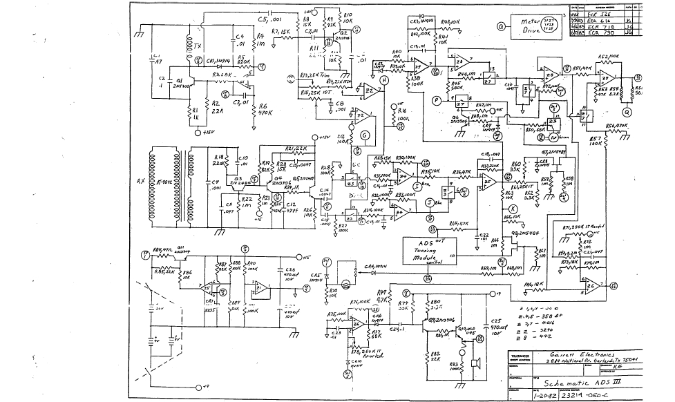

          Garrett ADS master hunter three
          Hello Mike if this post is not to old I'm looking for the schematic for this model Deepseeker ADS M.H 3 it must be very similar to the normal VLF TR Deepseeker Ads but because they started to spray the I.C's with black paint to cover the numbers it's a lot harder to figure or replace them.I see you have a lot of knowledge on modifications and schematics is there one or do you know where to get one with the I.C's numbers on it.Like the one floating around for the normal one.Or are you able to figure the numbers on this other detector Goldseekers 15000 Minelab.Thanks

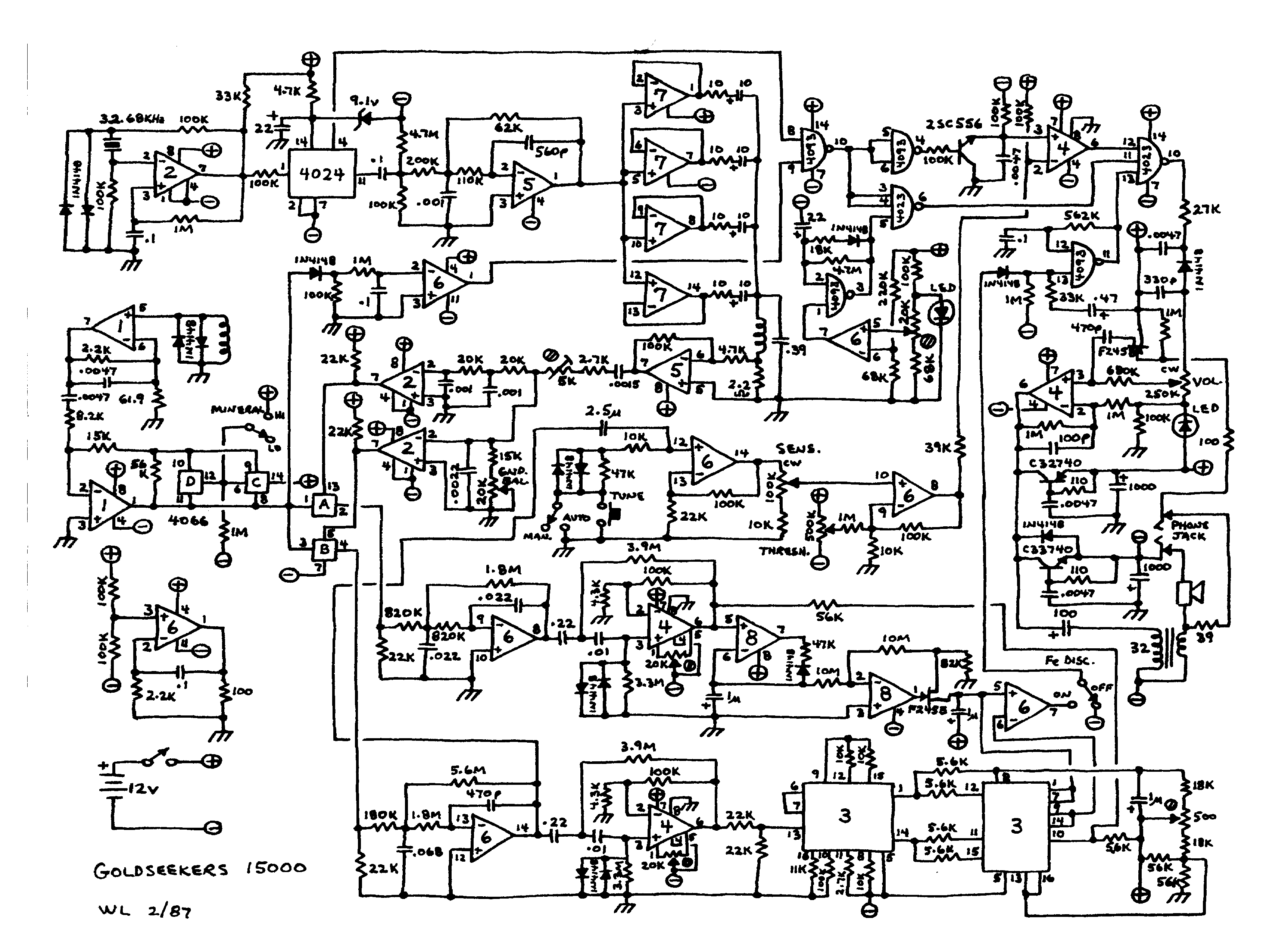

            Hello Everyone . Goldseeker's 15000 is Minelab by the way !!
            Clear Pictures of circuit boards are so important !!! Then you can still build a new circuit board and on your prototype put IC sockets with the correct number of pins on the board and then work on every stage one at a time . It can be done as long as your new IC's are the right type and supply voltages are at the proper pin locations You may NEVER find a schematic with all the IC numbers , but that should not stop you from building a prototype. 98% of everything else is on the schematic already [caps resistors etc...], why quit . By studying all schematics we have collected over the years it will not be hard to figure out the unknown IC's . Minelab made a few models very close to the 15000 . As an example look at the Relic Hawk and the Muskateer how close they are in design .
            You can figure out the unknown IC's , do not let anyone tell you otherwise !!
            Have a Great Day !!
            Best Regards..............Eugene
              GARRETT ADS DEEPSEEKER MASTER HUNTER 3
              Sorry Eugene
              But the way you reply with the excitement I think I confused my post a bit.Since yes I know the 15000 is a Minelab and I should have separated from the Garrett ADS question.I was asking Mike about the schematic you have posted thanks.That is the Garrett Deepseeker ADS Master Hunter 3 .And also the numbers on the Goldseeker 15000 Minelab as I said two separate questions but made a mess of it.I did not think the schematic for the Minelab was going to come out that big I have one myself Hipmount model and I'm getting another normal 15000 from someone to look at.
              And regarding the Garrett ADS 3. I have fixed several of the First ADS Deepseekers with the full numbers schematic showing all the I.C's numbers ,since they did not painted over the numbers on the physical units yet.Like in the attachment above for the Garrett ADS 1980.But since I have now the more improved model the ADS M.H 3 1984 they started to blank the I.C's numbers and I wanted to get a similar schematic with numbers even do they must use a lot of similar ones as the previous models.As you say the one you posted if you save it and transfer to the picture and fax viewer I have to zoom and zoom on it but never the less is a start.

                Thank-You Conan for posting your questions in a good place !! We will find the missing chip numbers and always more new schematics , but it also would be nice to have clear circuit board photo's to study .
                Best Regards Everyone........Eugene

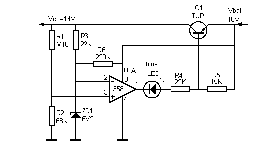

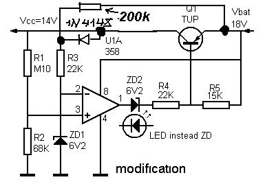

                  Professor SGS found that missing a startup resistor in the circuit diagram of low-drop voltage regulator:
                  The circuit with missing resistor is given above in post #8:
                  Here is the correct diagram with startup resistor R6. Thank you Mr. Professor! I hope you to find missings and errors in my other posts, and in the circuit diagram of QED:
                    By mikebg
                    I think it is correct.

                        Garret voltage regulator-
                        Here is the correct diagram with startup resistor-the best variant.
