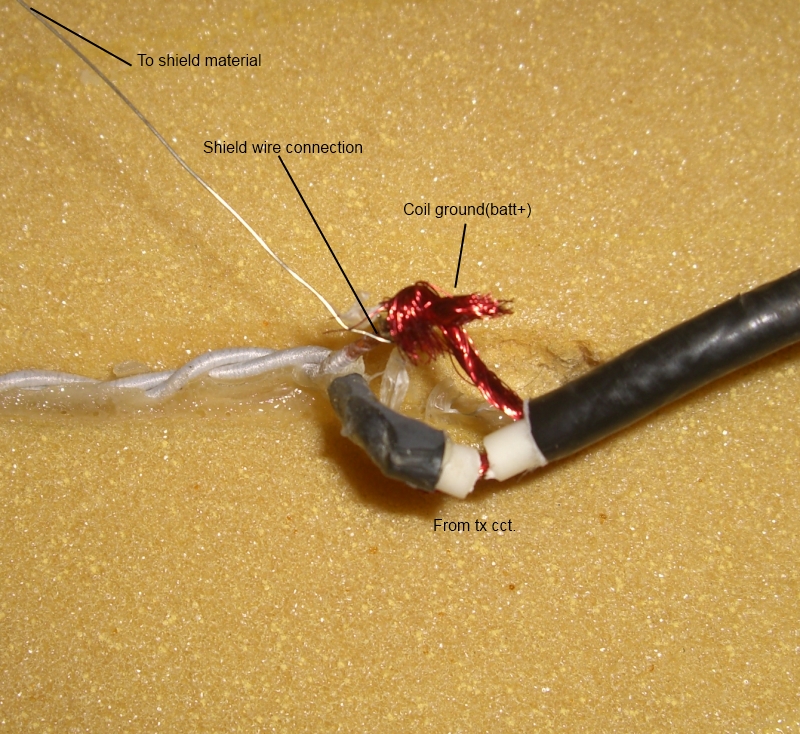

                Hi there Mick. I have a question. Do you know how shielding of SD2000 coils are connected to the PCB? There is no information about it on ZED schematics.
                Another question. I have made a complete SD2000 PCB on my own. When I turn it on audio CCT starts to oscillate (scream) at 2~3 HZ frequency. It has confused me. Usually noises from surrounding are from 50Hz mains or Radio Frequency sources. I don't have any idea what the source of this oscillation could be. Interesting is that when I turn BUK455 FETS off, but rest of CCTs still on, the oscillation persits. But when I disengage the coil and short coil connector on the unit oscillation nearly, but not completely, diminishes. I have used two different coils, with different number of turns and diameter, but frequency of oscillations is the nearly the same and in 1~3Hz range. I have not used any kind of shielding on my coils. could it be because of that?

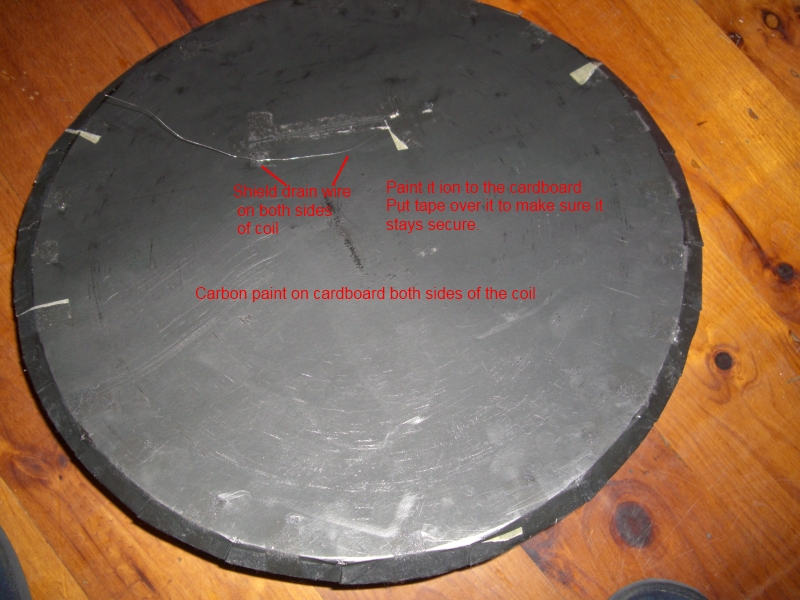

                • Hi Ghaj,
                  When you are in town it is almost impossible to run the machine with a coil on. If you get away from interference it will most likely settle down to the level of what the noise is with the receive wire connected to ground. The shielding is hooked up to the coil ground wire at the connection down in the actual coil. Make sure the shielding is well spaced from the windings and is not too conductive. Something like aqua-dag or a good mix of graphite in some paint(test it to make sure it is conductive) paint the drain wire in. Make sure it is less than .2mm wire. Make sure your coil wire is made from strands that are .2mm as well. Tin coated works well as does litz, but good luck finding some of that with the right specs. The coil needs to be about 300uh and .4ohm. Make sure that you have used decent caps in the integrators(polypropylene) and the rest of the filter caps seem to work well with polyester. Make sure everything is bypassed properly and you have a good ground plane. What is the amplitude of the signal on the output of the stage after the dc blocking cap with the front end connected to ground and the coil connected? use a very slow sweep speed, .5seconds/div. It should be around 15mv peak to peak.
                  Cheers Mick

                    Do you know how much effective is shielding the loop for reducing external noises? Could you explain your method in more detail? How and where the shielding should be connected to, on the transmit CCT? Do you know how Minelab shields its coils?

                      For the coil shield, it is connected to the coil ground which is batt+, but it is connected to gnd in the actual coil at the end of the coax where you connect the coax to the coil wire. See here : http://s590.photobucket.com/albums/s...coil%20repair/ I don't actually have a photo of the connection in the coil but it is there!
                      Cheers Mick

                          • Gday Ghaj,
                            No THE SHIELD IS CONNECTED TO THE COIL GROUND WIRE(outter coax) INSIDE THE COIL HOUSING!!!
                            The yellow wire is the front end receive wire. You will see noise from the power supply in the front end and about 100mv seems about right.

                            • Ooops here is some photos of the shield connection in the coil housing.
                              Ghaj, I would suggest you purchase a second hand coil from ebay for the purpose of getting your machine up and running. Coil building is an art in itself and when you are building the machine and the coil sometimes it could be very hard to find where the problems are. At least if you know the coil is good, then you are looking in your machine.
