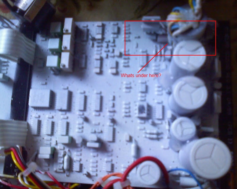

    Hi, I'm trying to change the LM394 chip on my SD2100V2. I have a MAT12 from analog devices. It's suppose to be a real quiet chip compared to the LM394 (Mat 12 has only 6 pins, but according to the LM394 spec sheet, pin 4 and 5 are redundant. I also have a SSM2210 chip in case something goes wrong.
    Can some one help me find it on my board. According to the SD2000's schematic, I should have continuity between pin 3 and pin 5 of the LM394. However, when I use my ammeter, I'm getting resistance. The two possible candidate chips are obvious on my photo, based on size of the chip when compared to the SSM2210, which is suppose to be a direct replacement.
    Can some one help please me

            Hi Mario,
            A lme49990 is a good replacement for the ad797 if you can get your hands on one. You need to locate your front end fets, and then find the fet that hooks up to pin 3 on the ad797 Then you have the ad797! If you could post a better photo of your board it may help.
            Cheers Mick
              Lets see if the pic works....
                Better image, fets numbered
                Ok, I got a much higher resolution shot of the pcb, found here . Fets are numbered in red, 8 pin IC's are numbered in blue.
                I tried checking continuity between the fets to pin 3 of all the 8 pin chips, and noticed the following: I found continuity between the middle prong of big fet 11, and pin 3 of ICs 1, 2, 5, 7 on the main pcb.
                On the daughter pcb , the middle prong of big fet 11 also has continuity between it and pin 3 of another 4 "eight pin" chips.
                Interesting enough, the right prong of Fet 11 shows continuity between it , and pin 4 of ICs 3,6,9. In addition, the right prong of Fet 11 shows continuity between it and pin 4 of the unmarked 'eight pin IC' to the right of IC 9.
                Big fet 11 doesn't show on my pic because it's hidden by that big capacitor on the top-right most corner of the photo, but it looks like fet 5. Fet 11 is screwed to a blue ground wire, and is also screwed to the case.

                      Hi Mario,
                      You can get some lt1028 from Linear technology as samples.
                      The input path to the preamp will be the same as the 2000 schematic.
                      Ok had a bit of a look at your pic and put some comments on there as to what I think some of the components may be.
                      http://i590.photobucket.com/albums/s...025_172418.jpg
                      See how you go.
                      Do you have a scope?
                      Cheers Mick

                              AD797!
                              BINGO! I tested your circuit and there's continuity between all components, AND pin 3 of IC 8. Hence we found the elusive AD797!
                              Thank you!
                              After more testing, I found the choke to fet 11, and it seems like it's a really important fet. I also found the p fet to fet 11.
                              Question, what is the purpose to fet 11? And what are those chips: 1,2,5, and 7? Are they 5534s like you suggested? Pin 3 of those chips hooks up to the P fet of fet 11, while fet 11 also hooks up to pin 4 of ICs 3,6,9
                              It seems to me like fet 11 is an important fet, an older part worth considering upgrading.
                              Should I also upgrade the p fet/n fet of AD797, if so which part numbers should I replace them with?
                              Last question, is there only 1 AD797?
