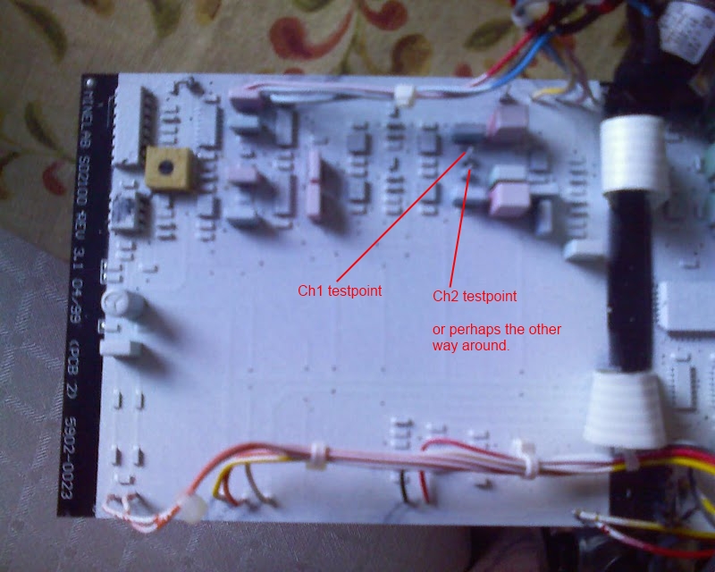

            You could use one of those 8 pin dip sockets and just bend the pins in to match the smd footprint. Be warned that this could cause extra noise in the front end, but it might not either! A scope would be a good tool to confirm this. To find the internal noise I have the coil tx running and have the rx wire to the front end disconnected from the coil and hooked up to the coil ground wire. Then look at the signal at the test points on the audio board with a sweep speed on the scope at about 0.2s/div and about 10mv/div. You will be seeing the noise floor of the detector and then you have a benchmark to compare improvement against.

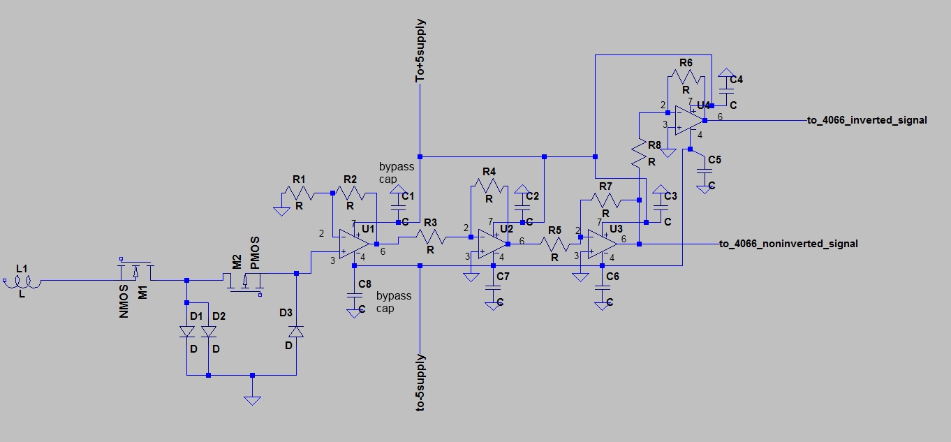

                Hi Mario,
                The orange parts beside the opamps are the power supply bypass capacitors. I should have said pin 2 of ic7 not pin 3, as it appears to go to ground.
                Now the signal flow, I think it comes into ic8, then goes to 7
                then to 5 then to 4, or 4 to 5. I have attached a schematic of how the cct looks so far. There will also be some diodes in the feedback loop on the first opamp and second and probably some caps too. Just need to find out the resistance values.... Hopefully this makes it a bit easier
                Cheers Mick
                  Hi, I had some time to probe my board for resistor/capacitor values (High res image is found here).
                  Notice the values: .14,.16, and .2 (12 OHM values are correct!). I noticed my LCR was sampling at the wrong frequency. Hence it wasn't giving me correct figures. Please substitute .14,.16, and .2 with a resistance value of 5 OHM.
                  My probe was giving me an erratic number between 3.x and 7.x OHM. Hence I'm forced to guesstimate. I did have a 10 OHM test resistor, which i was able to confirm. Maybe I need a new probe?

                    Hi Mario,
                    You will find that all of the little parts directly beside the opamps and other ic's are the bypass capacitors. The small ones will be 100nf, not sure what the large ones are. Just remember testing capacitors in cct will not give accurate results as they are also hooked up in parallel with the main supply bypass cap, which would be about 1000uf or more. You can easily confirm that they are bypass caps by looking at the ad797 or ne5534 datasheets and you will see that they hook up directly to the ic power pin. Also have a look at the 4066 datasheet and you will see that their bypass caps also hook up to the power pins. The bypass capacitor gives the component a local source of power and reduces noise on the power rails seen by the ic.
                    The parts you have marked 17k and 48k are actually diodes, the ones on the input path to the preamp seen on the schematic earlier.
                    Cheers Mick

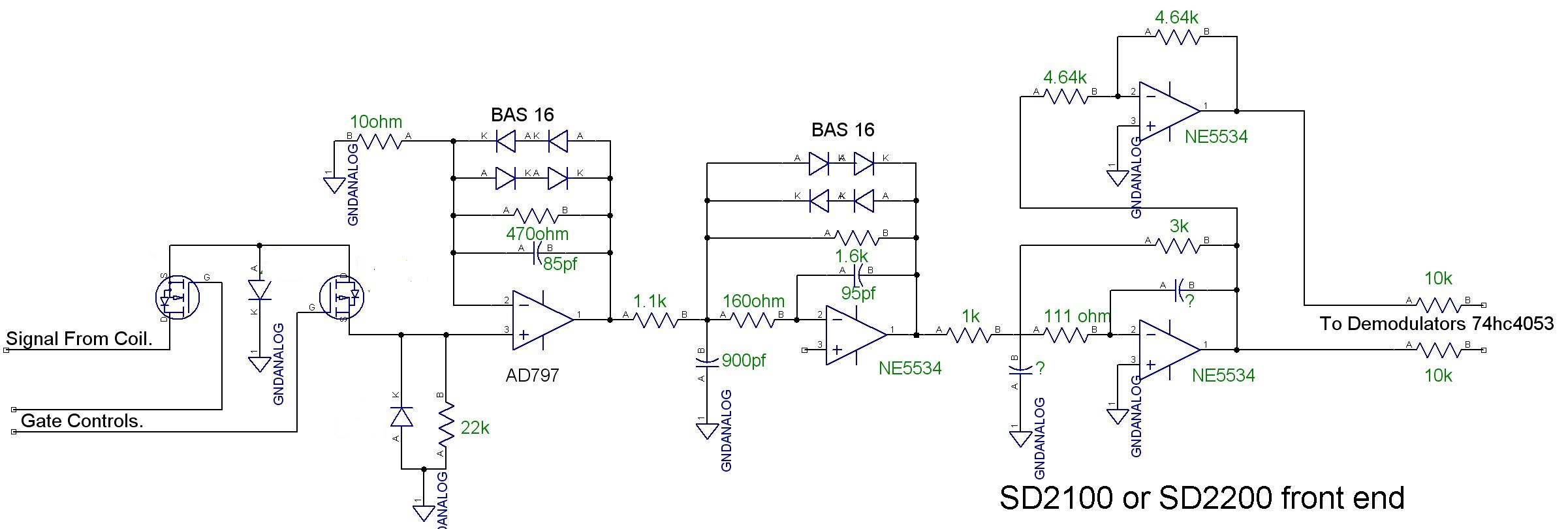

                        Found this in my arsenle ... maybe of some help .. can't garantee it ..but looks good
                          Nice find Gef! So they use the 4053 for the demods, very nice!
                          Mario, that yellow wire that goes to pin 1 of the coil plug must be for the analog ground.
                          Cheers Mick
                            OK, What do we know so far?
                            That schematic is spot on!!!
                            I tried getting capacitor sizes to enter them on the photo, but I can't really measure them directly unless I physically remove them, which I won't do. Unfortunately, that white gunk, which I can not remove with alcohol or scrape off (I wasn't able to find that bug repelant at my store) is all over the capacitors, so I have no way of knowing their sizes.
                            Also, I tried obtaining values for the diodes, and that's kind of hard to do as well...
                            I noticed that IC 7 feeds IC 8, not IC 5.
                            Should we go on and Id the remaining chips? do you have any ideas what they might be (I don't mind continuing )?
                            What other chips could we replace to obtain an increase in performance?
                            Any ways, based on your work (thanks btw), here's what we have so far:
                            High res photo is here
                              The diode up front between the fets is probably a 4148 and same for the one hanging of the AD797

                                Hi, I took a look at the 74hc4066 and 74hc4053, and the number of pins is incorrect for that ic. In other words, since there were no 7 pin packages made for 74hc4053s, the chip in question must be a 74hc4066.
                                I found a good replacement: max4066, which is direct replacement with a lower on-resistance when compared to the 74hc4066 .
                                Another issue I have with the schem, is that it shows pin 1 of the ad797 feeding the ne5534, which is also incorrect. Pin 6 of the 797 feeds the ne5534s, not pin 1.
                                I plan on eventually replacing the ne5534s also with the LT1028 chips as well.
