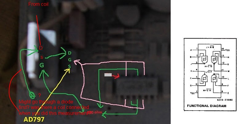

                            Here you go Mick. I should have all chips sometime next week
                            I'll update the photo soon to include grounds and voltages
                            • #44
                              Hi Mario,
                              Was the coil connected when you did these checks? Thats the only way I can see that the coil gnd is hooked up to the drain pin of the n fet. I have corrected your drawing. The 100ohm resistor can be reduced to 10 ohm when you put the new fet in.
                              Cheers Mick
                              • #45
                                Sorry about that Mick, I rushed my last picture. If you can reloaded the updated picture, I would like to ask you if you can tell me if my proposed pin arrangement of the 4093 IC is correct. I based it on the diagram to the right of the photo, and not ground, vcc paths. However, I did my best to trace the flow of continuity as correctly as possible.
                                I am getting 11.28V on pins 1,2,5,6,7,10, and 13.
                                The odd thing is that detector still works like nothing has happened. My guess is that it is unprotected from a voltage overflow until I replace the fet driver.
                                Also, You pointed out about the N fet being incorrectly connected based on my previous inattentive error. The wire that is connected to "S" of the N fet does indeed go through a diode.
                                After studying the matter, I think my P Fet is the one that is connected incorrectly. Shouldn't the N fet "D" be directly connected to P fet "S"...Right now the order of "DGS" on my P fet is the way I soldered the pins to my PCB, but after tracing the flow of components, the way the P fet is connected doesn't seem right....
                                If I were to re-solder the 4093 IC, I don't think it'll last long if my P fet remains soldered in my current configuration ? no? Do you think that this is what fried my chip, (assuming my chip is fried)?
                                If photo didn't update, you can click here.
