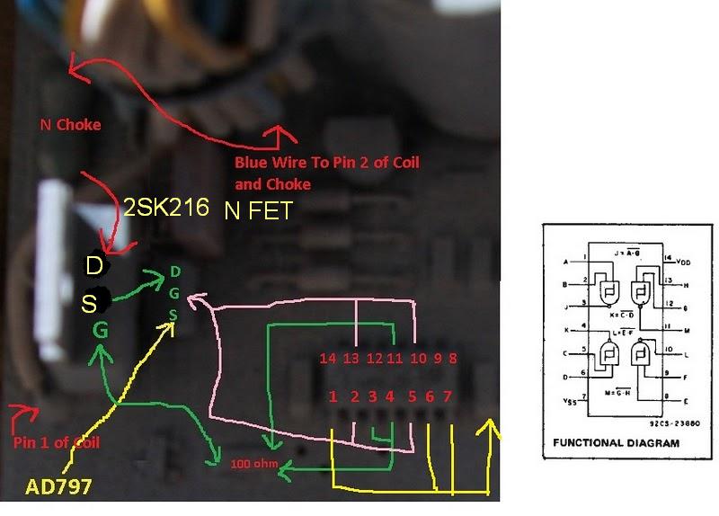

      Hi Zed!
      As you suggested, I removed:
      P fet
      N fet
      4093 IC from the board
      With all 3 above chips removed, I get:
      0V on 3,4,11 of IC 4093, or Z1 of N fet
      0V on 2,5,10, 13 of IC 4093 or G of P fet
      11V on 1,6,7, 12 of IC 4093
      3 questions before I solder all new chips back to the pcb:
      1)On N fet what's the proper order of SDG?
      X1, Y1, Z1 == ???
      2)On P fet what's the proper order of SD?
      X2,Z2 == ???
      3) is the pin order of IC 4093 correct?
      4) any other steps you would like me to follow?
      Thanks!!!

        Put your 4093 on first(makesure the bevelled edge along the chip is around the right way)once done connect your scope to the outputs of the 4093 and make sure your getting 11 volt pulses that are similar to the transmit pulses.
        The fets dont go on till your sure your getting the right pulses to the gates
        Study the pinouts in the pdf of your receive fets,it shows the pins and from what view (top)
        See revised picture
        The pin order for the 4093 is incorrect,put it in like that and it will blow,turn it around,all the ic chips are alighned this way.Number one pin is nearest to the large electro caps,this applies to all the chips on the board.
        If you cant see the bevelled edge on the ic then dont put it in.
        Zed

            2SK216!
            I knew that N fet was either 216 or 218. I just couldn't make out the initial 3 digits. I tried very hard to identify that IC.
            Thank you Zed!

            To answer your question. I used your technique of applying heat from one side of the IC, to the next while prying the chip out. However, The last top-right most pin gave me a bit of a difficulty. I placed the edge of the hot metal plate that I was using at an angle and left an imprint at that particular location. It's just a surface burn, nothing serious (for once that white gunk was useful, since it absorbed all that heat! )
