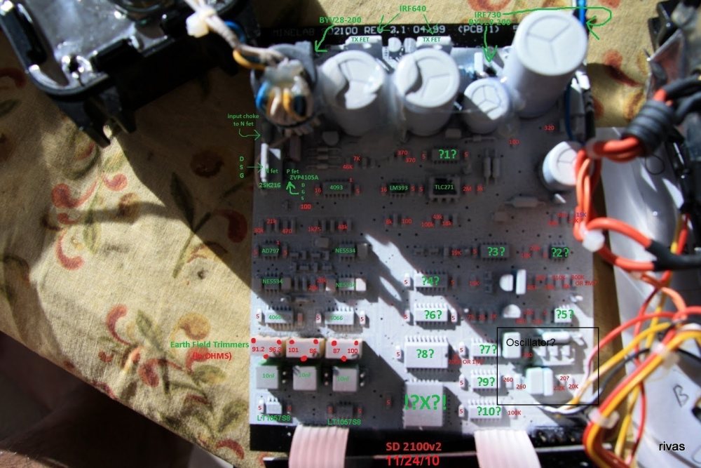

                • #68
                  Hi Mario,
                  To start off with we should try speeding up the oscillator for better sensitivity to smaller targets and slow it down for a bit more depth on larger targets. I think the section I have pointed out in the pic is the oscillator that drives the rest of the cct. There should be a fast square wave from that cct going to the part marked !?X?!. The pin on that chip will be the clock pin, which puts another piece in the jigsaw puzzle as to identifying what it is! I have a feeling that if you change the values of some of the capacitors in the oscillator section that you will be able to change the frequency of the oscillator. But be aware in doing so you will change the range of targets that the detector will hear. If you make it sensitive to smaller targets it may not hear the bigger ones as well. Also there could be an increase in ground noise. But why not fiddle and learn! Don't blow it up
                  I still must go over the earth field cancellation procedure.... next time!
                  Cheers Mick
                  • #69
                    Hi Mario,
                    Just thought I'd add a bit to the last post.
                    When deciding which caps do effect the clock frequency start by just adding say a 1nf cap to the existing cap without removing it. When you find an area of interest carefully remove the cap but be careful that you do not remove the ring around the bottom of the via with the cap! Then when you have the cap removed solder some pins into the holes and then solder your experimental caps to the pins. This way you will preserve your board a bit longer
                    Cheers Mick

                        My next step will be identifying that "X" IC. I want to see how it works in relation to the surrounding ICs. It will be awesome if we can get the sensitivity up to par with the gpx. I think understanding that IC is the key...
                        Unfortunately for me, I blew a IN4148 diode, the one that is connected to the "Source" of the P fet. I must have weakend it last time I incorrectly soldered those fets and blew the 4093. Now it's shorted and I'm getting an erratic signal. Anyways, my unit is going to be down until my replacements arrive.
                        I have already started fiddling with that "X" chip. I removed the white gunk from its surface and was some what amused about the minelab guys: they went out of their way to scratch off all identifiable numbers. They scratched deep, very deep!

                          • #73
                            Hi Mario,
                            Looks like the green trace is one of the power rails either +5v or -5v referenced to coil ground. What voltage is present? The yellow trace is the other power rail. Those jumpers do something, put your scope on the coil and swap the jumpers around and see what happens.
                            The fact that the trimmer for the frequency is in that box I have hit the nail on the head for the oscillator section. Perhaps take some time and draw up a diagram of the parts there and make yourself a schematic. When you tune the trimmer do you see the frequency at those capacitors(they are not xtals) change a little? It won't change a lot. What is the frequency?
                            Cheers Mick
                            • #74
                              K, I must have been there a few hours tracing those pins....anyways, hopefully google refreshed the picture down at your end. I think I've traced enough of that IC to at least get a few ideas as to what it is. Any suggestions?
                              I'll eventually post a schematic, that way some one could one day improve on the design (and hopefully tell us about it).
