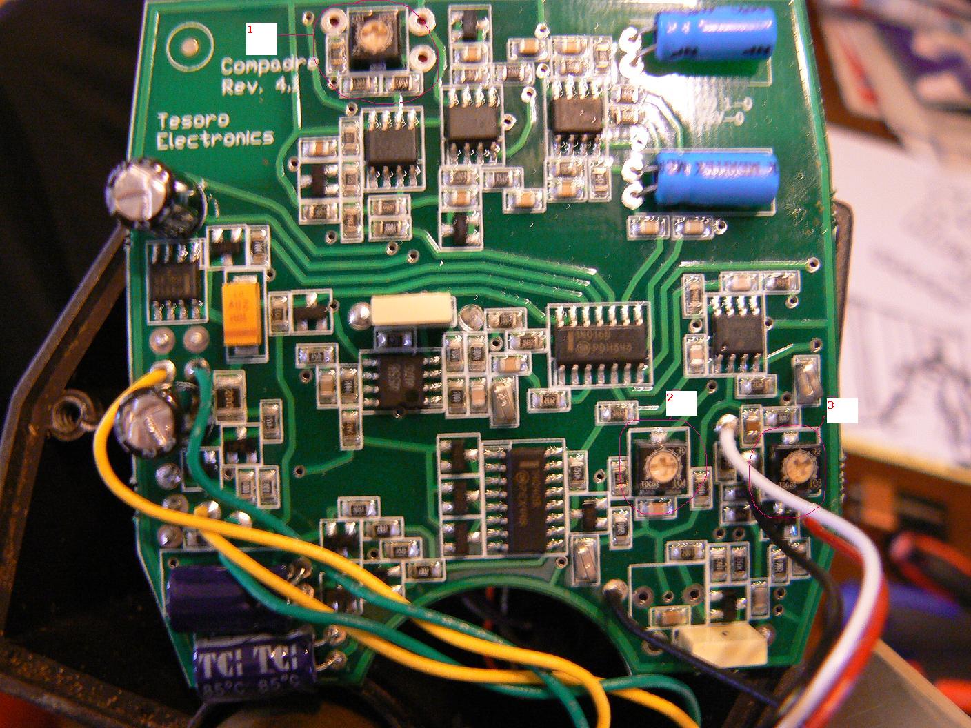

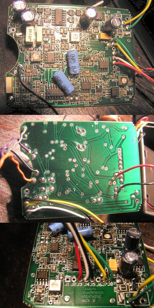

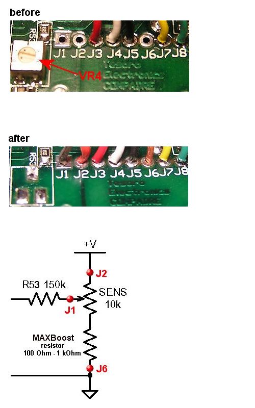

Has anyone played with sensitivity (VR4) on Compadre PCB? I read that (PEPSO) did this and was wondering if anyone else has tried. I would like to add pot and resistor for Maxboost, but was wondering if anybody has done this and what were results.
