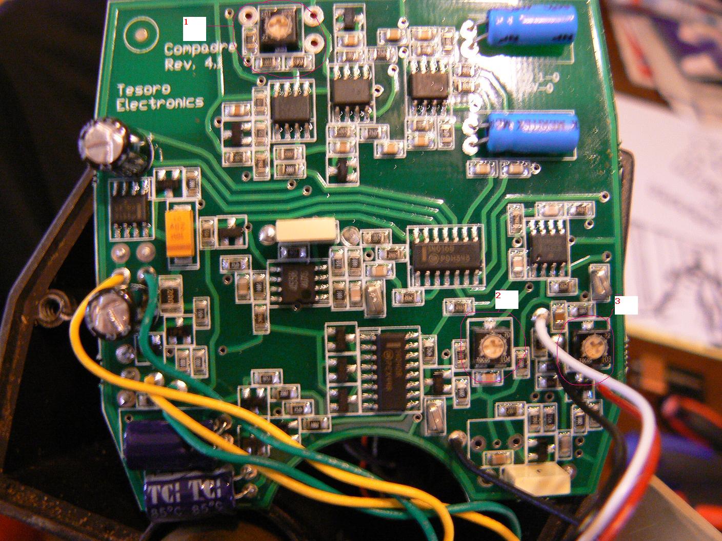

      Hey, can anybody help me with the maxboost resistor for my compadre? I have already installed the 10k pot and it works well but there is no boost in depth. I Just dont understand where to connect 1k resistor for Maxboost?
      P.S. I Have a new revision of compadre pcb (4.1)

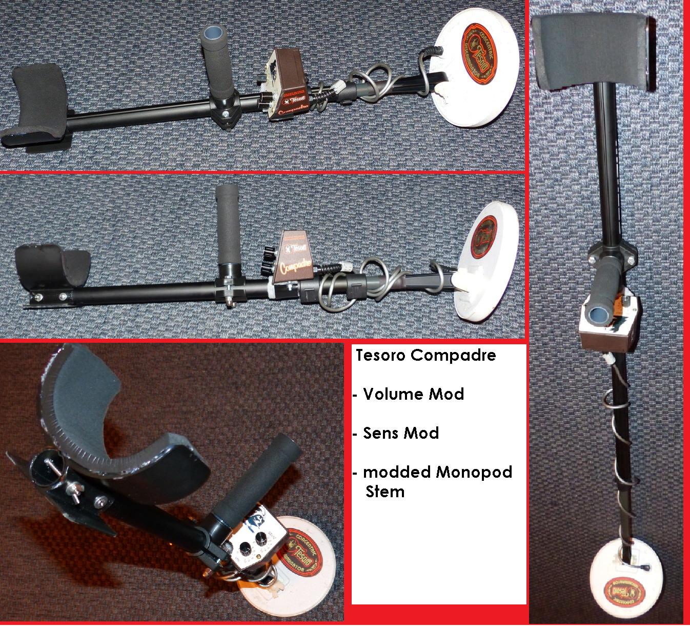

          I have made this mod and it worked out great for me
            latest work

              I have done some mods on this, added sens and GB, does anyone what the third trimmer does? My soldering wasn't the best, not sure how to solder onto those pads once the trimmer was removed but I got the job done, if I take the faceplate off I'm afraid the solder might break...
                Discrimination preset. I haven't played with this pot, so I don't know how this will effect the Comp.
                  That stem mod is bad ***!
