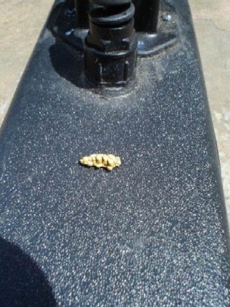

      • #78
        Good thing it worked out Ian.
        I have noticed a difference in sensitivity also with the few different coils at different frequency settings. It does seem each coil responds differently, with each having "a sweet spot" like you mention.
        I'm looking forward to seeing that picture. 2.5 grams is a nice piece. If you like, you can email it to me, and I'll post it in my public google account.

        • #79
          OK for those that can not see the picture I will do it a different way I hope here goes the problem was I copied my post and pasted it here being lazy Hi.
          Mario I will be in touch.
          Regards, Ian.
