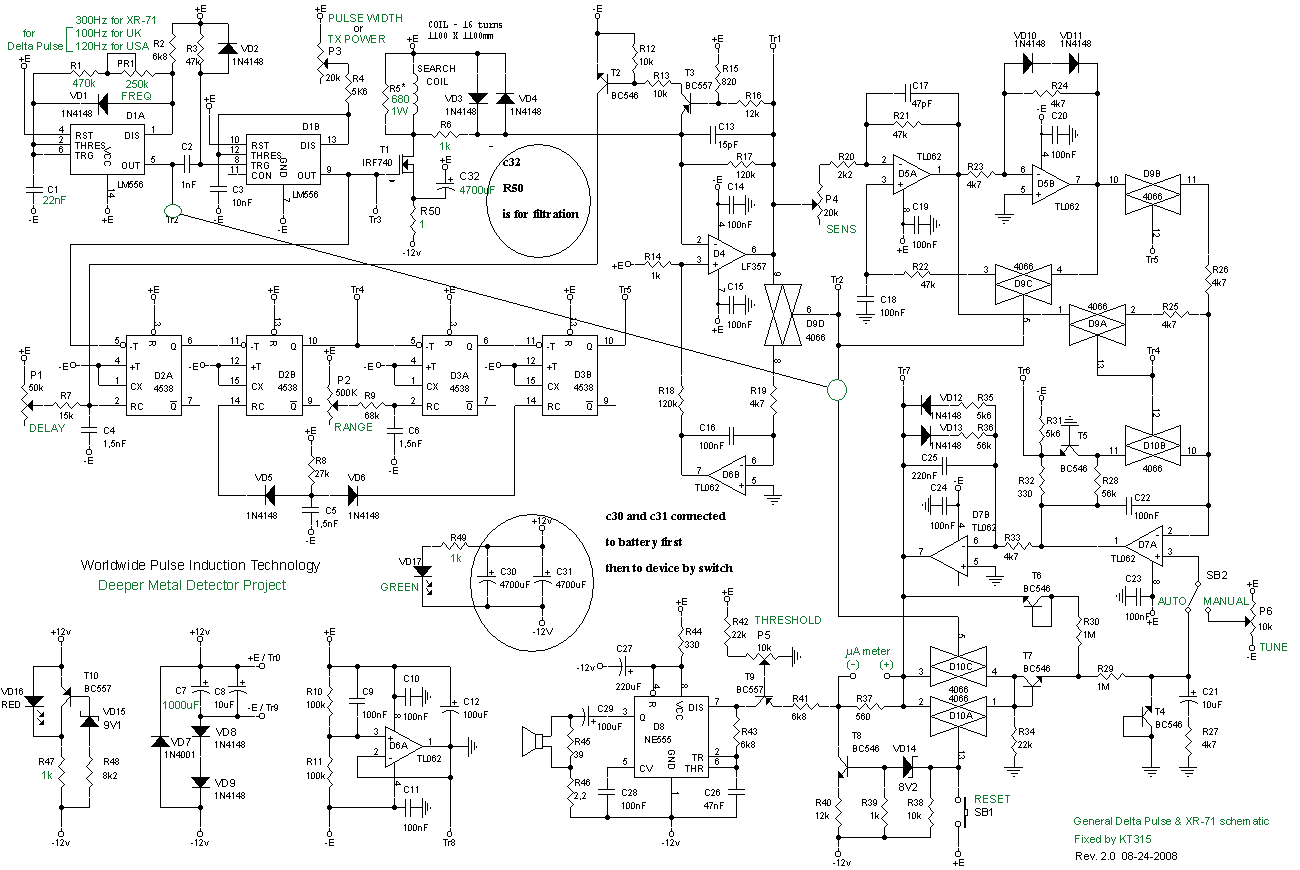

        HI JOSE
        WHAT IS MUST ELIMINATE CONNECTION BETWEEN T2 AND C4?
        WHAT IS THERE A PROBLEM IF I MAKE A COIL 110 CM INSTEAD OF 1 ME
        THANK YOU VERY MUCH

          Hello Assama and Jose,
          I have found somewhere that there must be put a forgotten connection between pin 5 of 4066 and pin 556 ic. Is this really required ?...is this missing?
          Marius
          • #65
            Marius
            check the photo
            • #66
              Originally posted by pigeon View Post
              HI JOSE
              THANK YOU VERY MUCH
              This mod, I use it for a smoother adjustment of the delay control with small coils.
              No need to delete the connection between T2 and C4 Roll 110x110 cm.
              However, you can experience the track opening near the collector of T2. Nothing bad will happen.
              • #67
                Marius
                The connection is necessary.
                Jose
