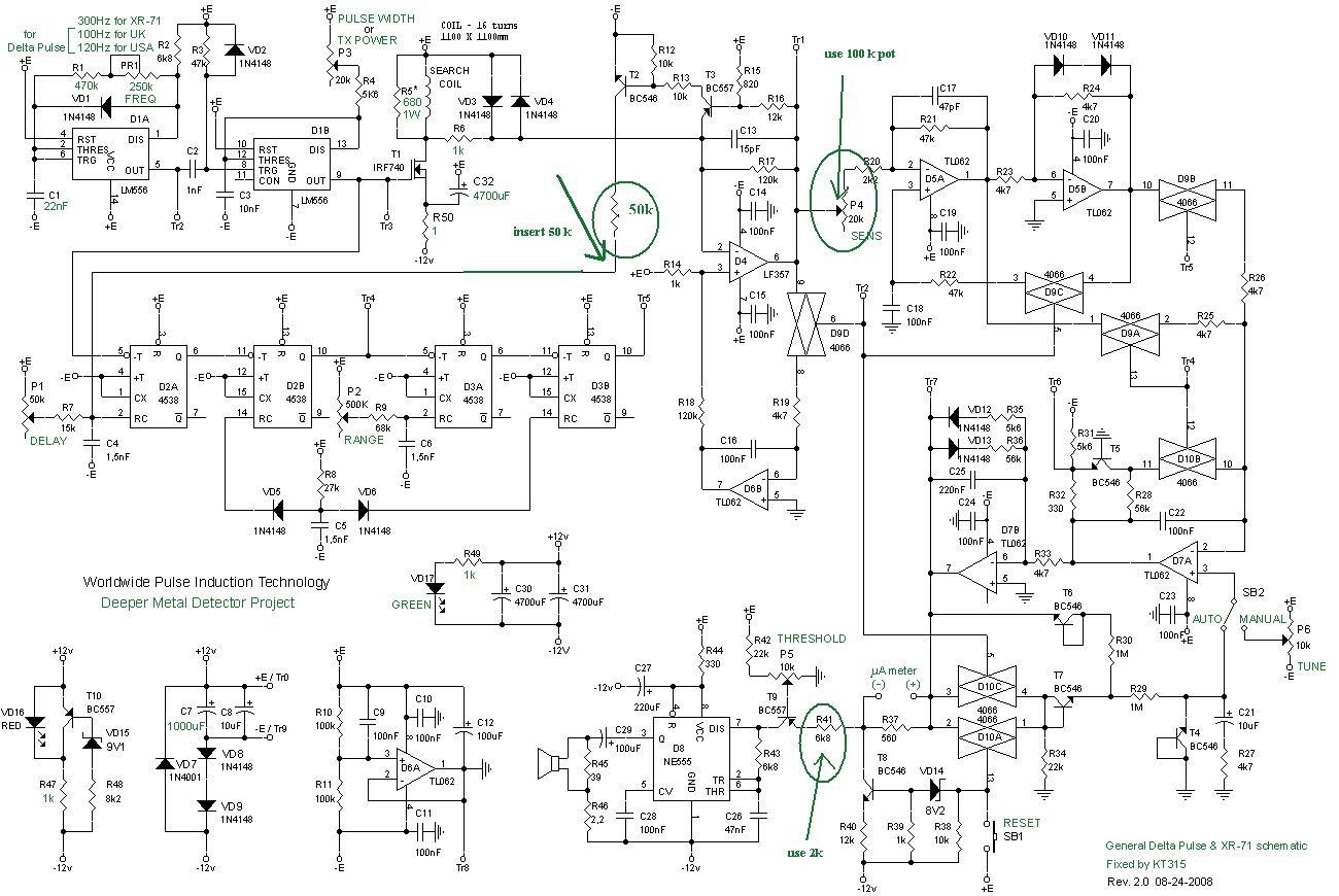

delta pulse more sensitive to gold delay reduced
  • delta pulse more sensitive to gold delay reduced
    to make delta pulse work with lower delay
    need to reduce the effect of feedback network on delay sample
    by inserting 50k
    and the gain have to be reduced
    so use pot 100 k instead of 20 k
    to ensure stability
    and use 300 hz instead of
    100 hz
    try it and its work
    now it can detect small gold
    http://www.geotech1.com/forums/attac...1&d=1322337584
    Yes, but if the delay is <= 30us then you need to shield the coil.
      will be tested in ground
      for small gold that cannot be detected before
        I agree with you ossamaussama
        We must make a quick shielded coil (Scotch tape No. 24)
        No nesecidad to reduce the gain, but increase to 1.5 K. R6

                I found that most of the problems of instability, increasing R6 improved, the value is 1.5 to 2.2 K. The delay setting is softer, you can use lower inductance coils (400 uH), although the sensitivity decreases slightly.
                Another notable improvement is to incorporate a trigger circuit for the IRF740, with an integrated 4427 or similar.
                We also need to adjust the damping R for best results.

                  increase R6 to 1.5k give more stability
                    hi
                    I have to change the resistance6 value of 680R by another value 1.5K?
                      note
                      in original design it was 680 and keep in mind delta pulse is designed for large deep object
                      not small
                      make it 1.5k will increase stability as Jose said
                      but i don't know effect when using large coil
                      any way it is experiments
                      you have to try

                        If, whenever "R6", in some schemes Figure 680, in other 1K.
                        Jose
                          not small
                          you have to try
                          I performed large coils of 1X1 meters, equal to 1.5 K. R6
                          Is more stable.
                          We must reduce the TX frequency between 150 ... 170 Hz
                          Increased to 200 usec. the width of Pulte TX.
                          I use 12 turns for coil 1X1 mtrs.
                          Roll 45X45 cm. I use 18 laps.
                          Frequency .... 550 650 Hz
                          Scotch tape Blindage No. 24
                          In all cases, reset the value of R buffer.
                          In all cases, R6 = 1.5 K.
                          Greetings Jose

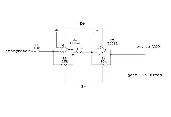

                            more depth
                            who notice that using more gain in large coil will reduce the depth??
                            at last i found the Reason for that
                            it is because more gain before integrator will cause fast retuning
                            so deeper target will eliminated by re tune circuit
                            my idea is to reduce the gain before integrator by use larger
                            the potentiometer 20 k have to be increased
                            and use the following circuit
                            which is 2 stage non inverting amplifier
                            tested already with 1M coil
                            and the target was aluminum coca can
                            which is easily detected at 1.7 meter good sound
                              It's very interesting what you say, I did not experience it.
                              Large coils tend to be unstable and require more transmission power.
                              I can not explain the razan theoretical but real.
                              It seemed to work best with low frequencies in the ground.
                              My MD detected in the air more than 1.4 meters from a soda can of 333 cm3.
                              The same can of soda is detected at 1.1 meters below ground.
                              The higher frequencies work well in the air, but not in the field.
                              Coil 1X1 m.
                              Jose
