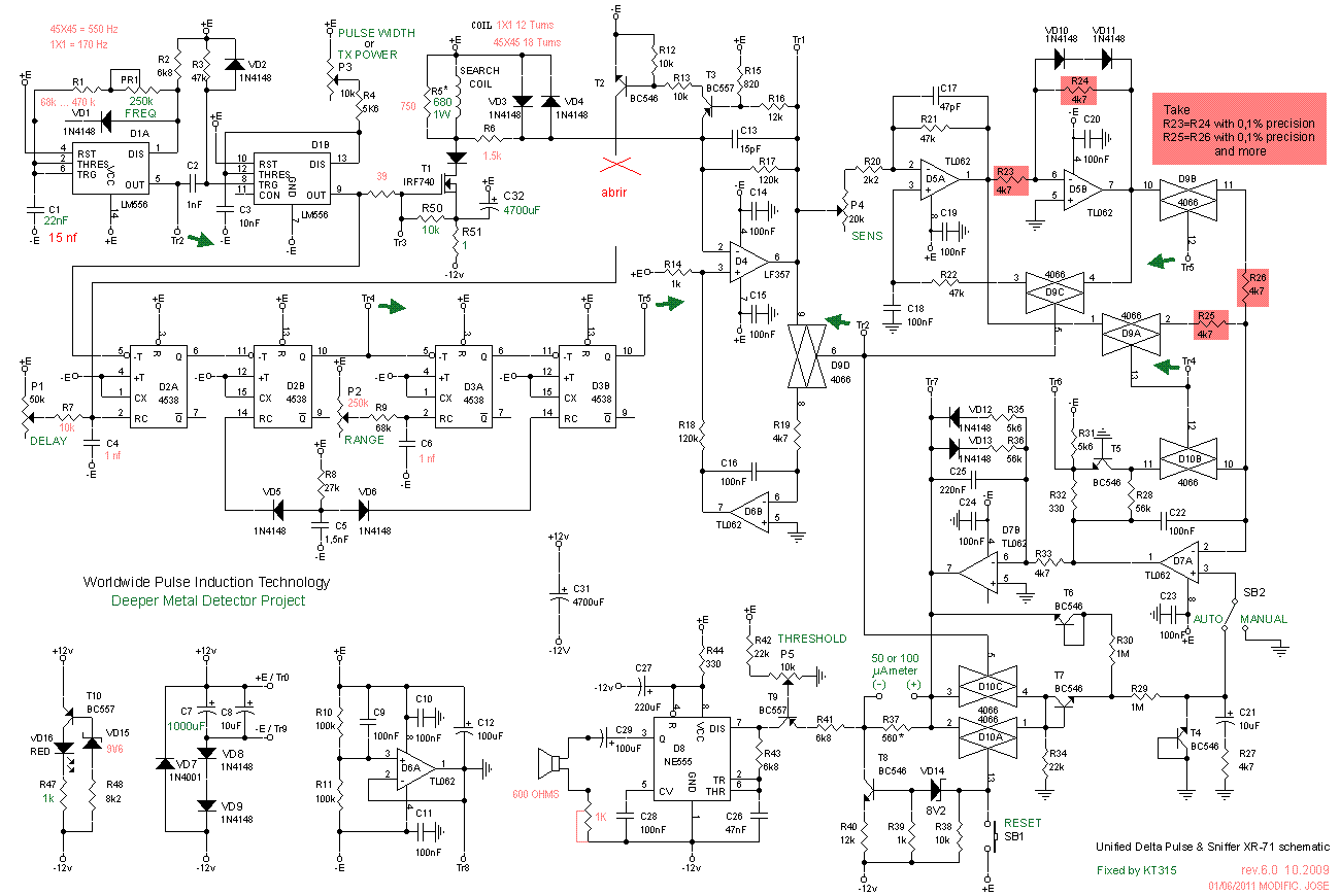

delta pulse more sensitive to gold delay reduced
    i study delta pulse schematic very well and test every part
    i can say it is powerful design and lazy deep detector
    give sound when metal present and give sound when re tune
    its design seem to be strange not like others hummer head deeper 8 gold scan
    and they use integrator with diode !!!
    more frequency make fast re tune because of bilateral switch connected to tr2
    T4 T6 T7 transistor configured as diode
    T5 used to give -.7 initial volt to start the integrator
    be turn on D13
    note that
    D13 WITH 56K
    and D12 in reverse with 5k
    this integrator design to hold output positive longer time than negative
    if we take look to pulse star schematic
    we see capacitor 10,000 uf in c32
    this reduce the effect of TX circuit on receiver circuit

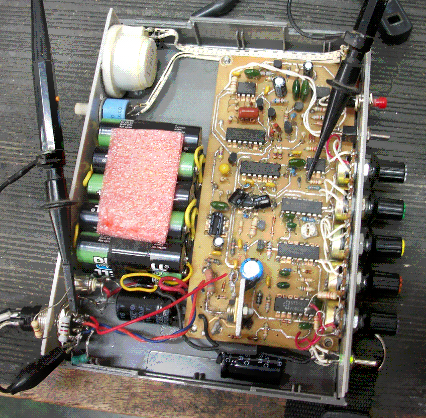

      photos
      hello to all which has build delta pulse here
      im short before finishing
      and would compare to others who have build it
      so plaese- some photos were nice
      and video links too :-)

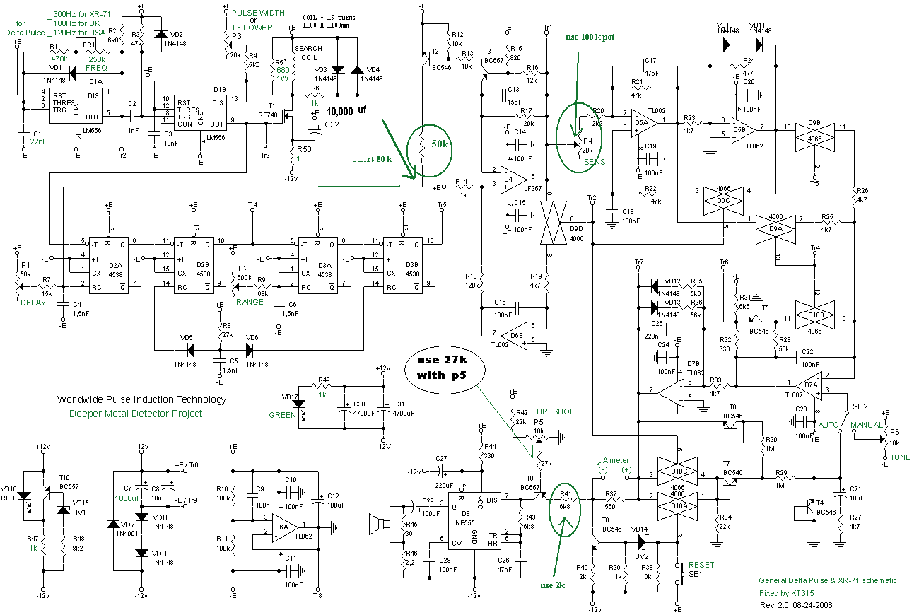

        This is my experience with the "DP".
        As stated Ossamaussama, DP is slow to react, this occurs with frequency 300 Hz, from 550 to 650 Hz this improvement effect.
        It also seems improvement with the addition of the diode between the IRF740 and coil, and adding a circuit between the 556 and shoot the IRF740, you can even experiment with an R of 20 to 100 ohms.
        All these changes together, improving the response of DP. (at least this happens in my DP)
        Jose

            Hello Paloma
            Changes in red
            Diode between IRF740 and coil. Retrieved TV chassis
            After I put the trigger circuit.
            Greetings Jose
              Shot circuit 4427.
              R buffer (R5). Adjusted according to the coil

                nice work man
                i use irf 840 instead of irf740
                and insert 20k at base of T9
                this make threshold more accurate
                  useful modifications
                  hi to all
                  i found increasing the value of c32 from 4700 uf to 10,000uf give more stability
                  this capacitor reduce the effect of voltage variations
                  on E+and E-
                  because of TX time
                  second thing is that P5 threshold performance can be more better when inserting a resistor 25 k up to 33 k
                  because at low the resold current will pass to the ground more than to the 555 VCO
                  and make loading effect on the output of integrator

                          HI jose
                          after some experiments
                          change the following and you will get very good stability
                          c32 to 10,000 uf
                          it is more important than c31 and c30
                          use c30 4700uf
                          it is enough
                          second note
                          R28 IS 56 K
                          change it to 80k or more the device will be more slower but stable
                          and no change in detection
                          and put 50 k series with T9 base

                              i test it today with large coil
                              yes it is more stable but not working in low delay ( depth killed) if i use low delay in large coil
                              dont know why
                              may be saturation problem
                              any why forget about r28 keep it as it 56k
