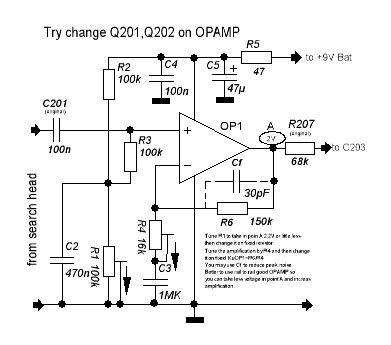

Increasing sensitivity of the GD-48
    The best is animy for better... I think even 2 ma economy from little battery is a result. The original circuit and modernized is not the same)))
      I can see the basic schematic, but the fine print text here, I cannot read any of it. Tried printing to full page size, nothing works, the fine text is not readable to me. Can you enlarge this schematic so I can read the fine print? Thanks.

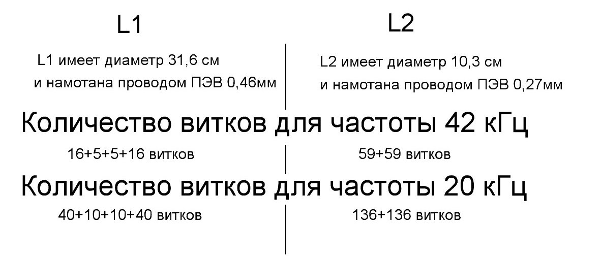

        Anybody know what this says
        thanks
          thanks
          Coils L1 and L2 turns and wire diameters for freq. 20 and 42 kHz
            It says in the first column:
            L1 has 31.6 cm diameter
            wound using wire 0.46 mm
            Number of turns for 42kHz is 16+5+5+16 turns
            Number of turns for 20kHz is 40+10+10+40 turns
            In the second column:
            L2 has 10.3 cm diameter
            wound using wire 0.27 mm
            Number of turns for 42kHz is 59+59 turns
            Number of turns for 20kHz is 136+136 turns
